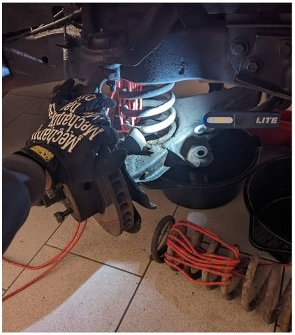

Yes, Moog is the most recommended brand, and I've been ordering suspension parts the same way—Moog first, and if Moog is unavailable, then opting for rubber bushings from another manufacturer.
For the coil spring removal, I followed the process shown in this video:
With one exception: to secure the springs and keep them slightly compressed for easier removal, I wrapped a paracord around the spring about ten times to hold it in place. Then, I gradually loosened each loop to slowly release the tension.
Like this:
