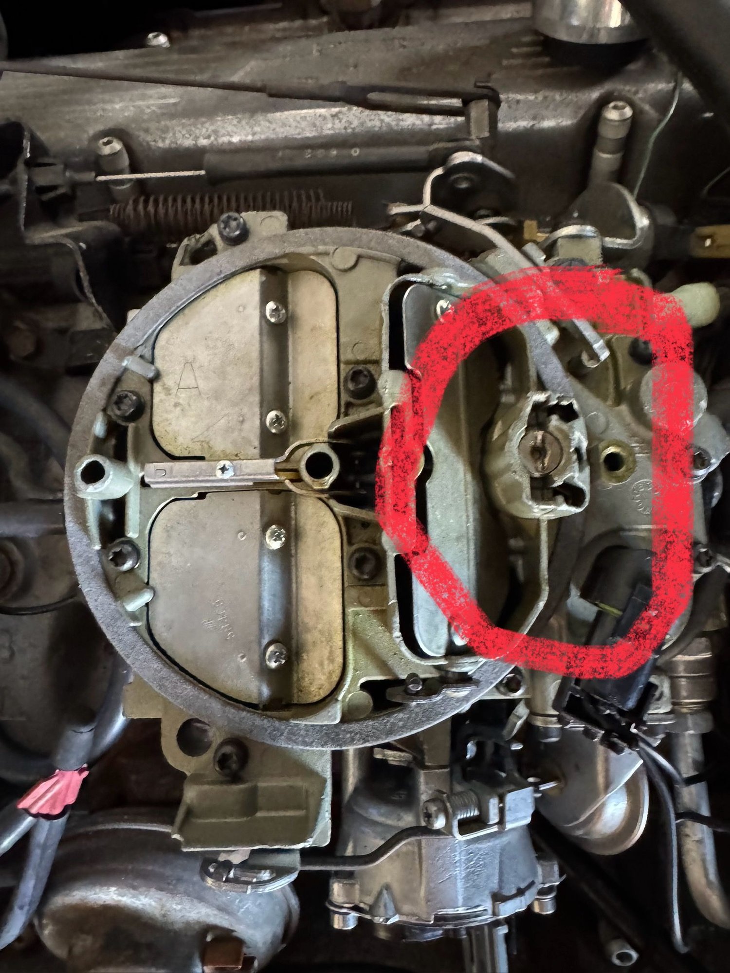

The screw that goes in the hole to the right is missing.  I need to know what it is, if there is an assembly under it, and if anyone knows where I can order it.  I have a manual but it doesn’t describe it or what it does.  Thanks in advance

An aluminum plug goes there should be in a rebuild kit, there is an adjustment screw down in there for metering height stop but you can't just start turning that thing or you'll mess things up even more , it needs to be set up with the top off

These E4M Quadrajets didn’t have Phillips head screws in the choke and secondary flaps from the factory as far as I’m aware.
Has your carb been rebuilt by a commercial rebuilder?

that’s a brand new one inside and out from a company in Florida.

the airhorn looks a little gnarly but as said, plugs, many, were installed from factory.
tuning the CCC is different from a non CCC carb.
I strongly suggest you find a factory service manual.
an eng dwell meter with rpm feature is needed along with digital volt meter for dc volt readings.

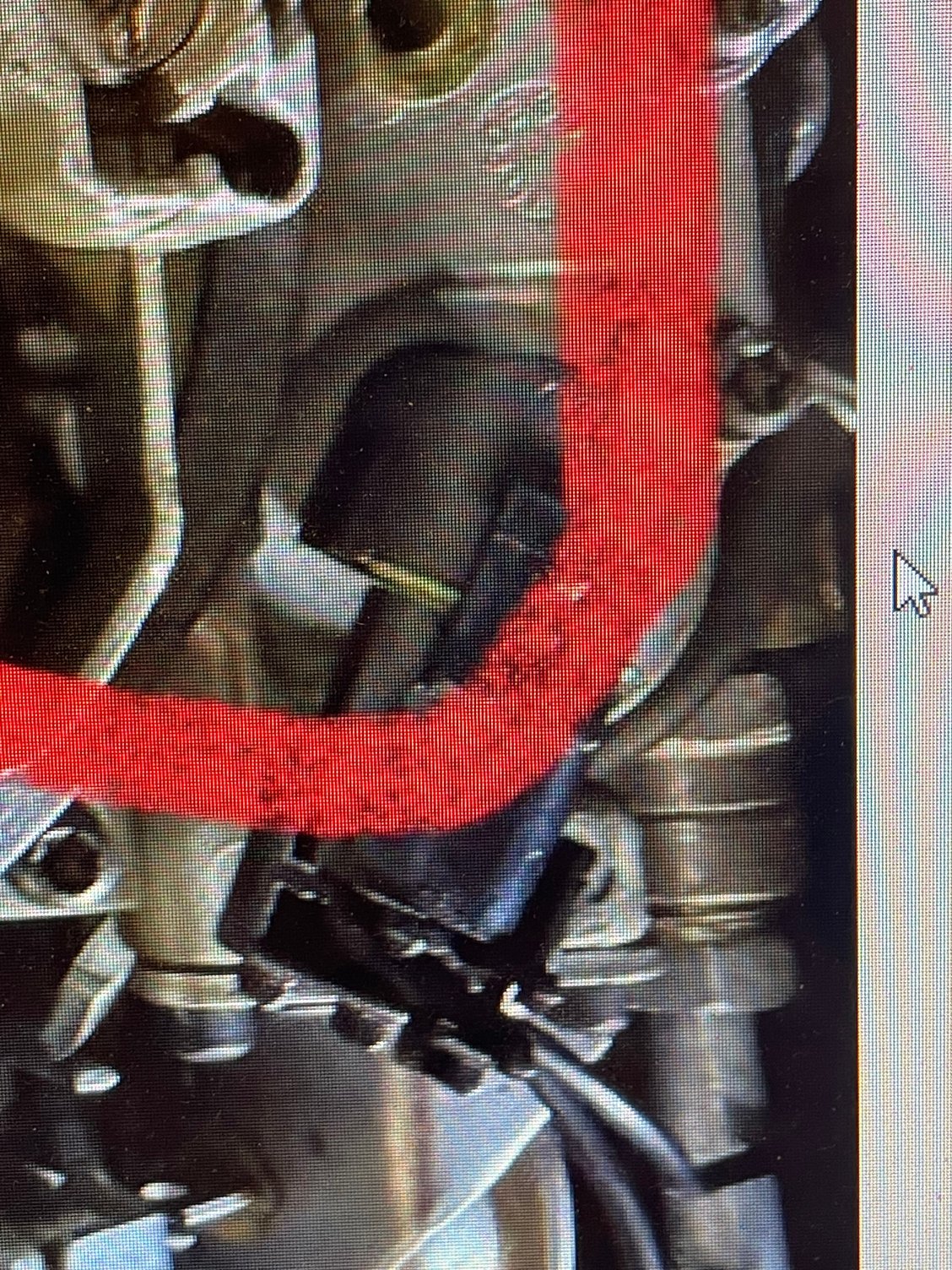

1981 used an electronically controlled carburetor. I do not see any mixture control solenoid in that picture.

it's there , hidden by the red circle

Yours does not look like this

Mine is from a 1984 Firebird on the back room bench but HIS is right underneath that red mark
