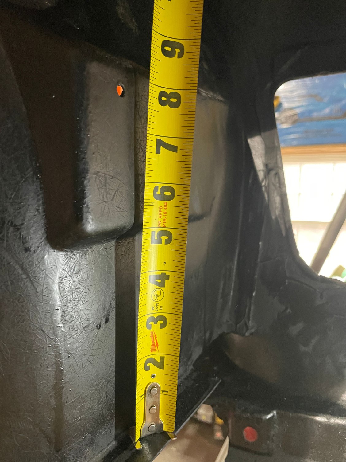

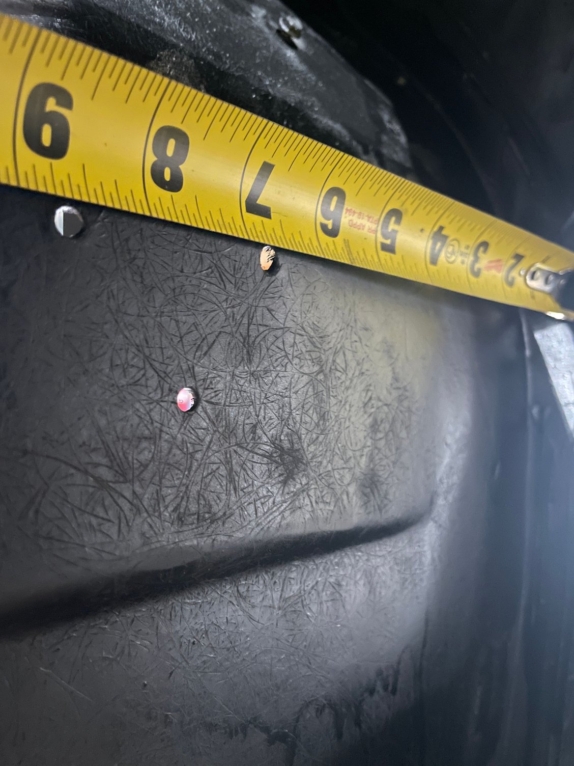

I just ran down to the shop and took a couple of quick photos from my non AC '72.. maybe these will help locate it on your inner fender. If these help, I can get more precise pics.
Horizontal from side gill cutout
Vertical from lower fender lip

well that is helpful.
someone did a terrible job of fiber glassing mine, because i dont thave that profile
that second picture is looking out the missing eggcrate on the fender?

Correct, am looking from the engine bay out where the egg crate grill would be

and the first picture, the tape is hooked on the outside lip of the fender?

It was even with the lip when I started but then I pressed against it to take the pic so it looks outside. I can get a better photo later today. Any others while I'm there?
