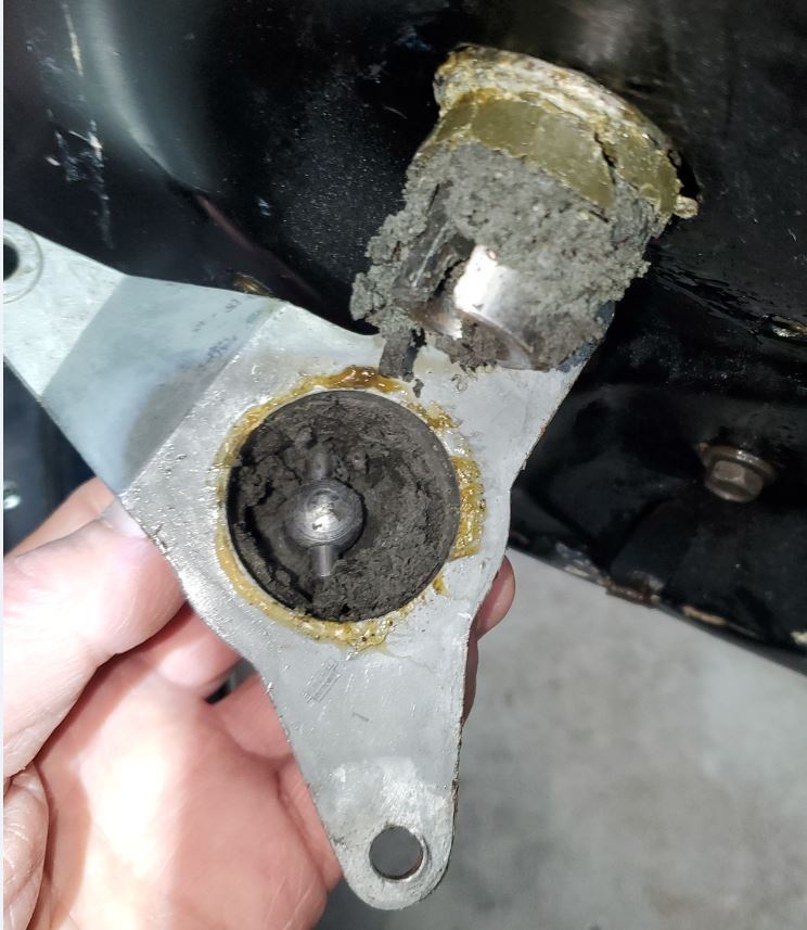

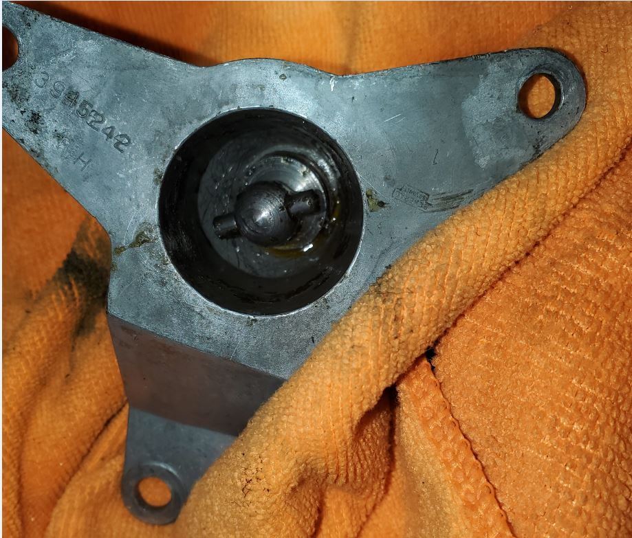

Finally fixed the issue with the passenger side manual window crank being nearly frozen even after my second attempt to clean and lubricate all the tracks and rollers with spray lithium grease. Window was so hard to raise/ lower that the handle stripped out. Anyway, here are a few pics of the cause of the problem. The window crank unit grease was as hard as a body mount! Window works perfectly now. Will have to check the driver's side although it still works fine.
