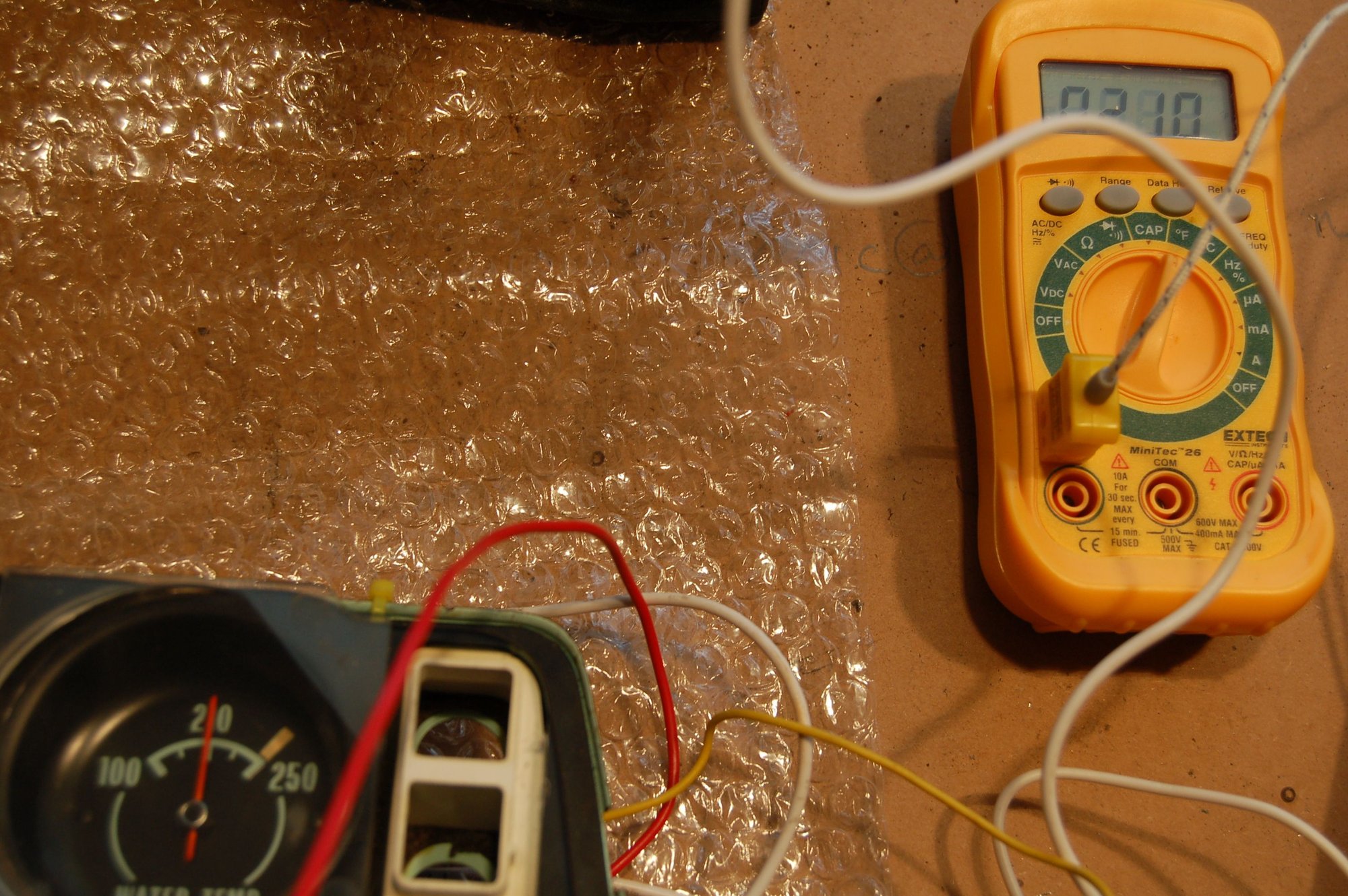

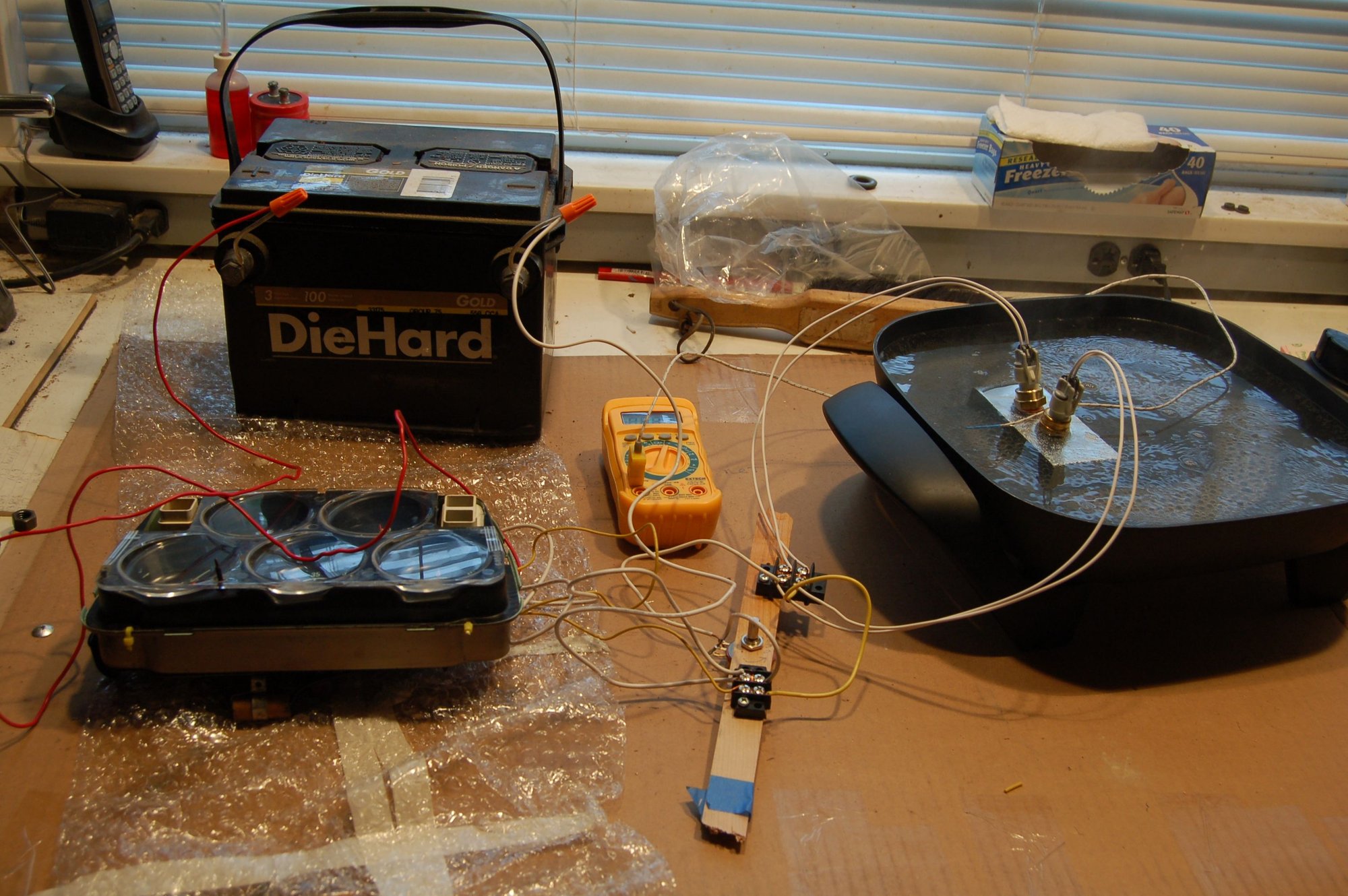

I was able to achieve a calibrated reading on my original gauge by wiring two senders on both heads in parallel. You can see two in the picture sitting in my hotplate.
This was 12 years ago. I probably have more details in one of my notebooks. I plotted across a large temperature difference and was pretty happy that I got a linear response (on log paper) that tracked the gauge reading. The multimeter in the picture is being used to measure temperature.
