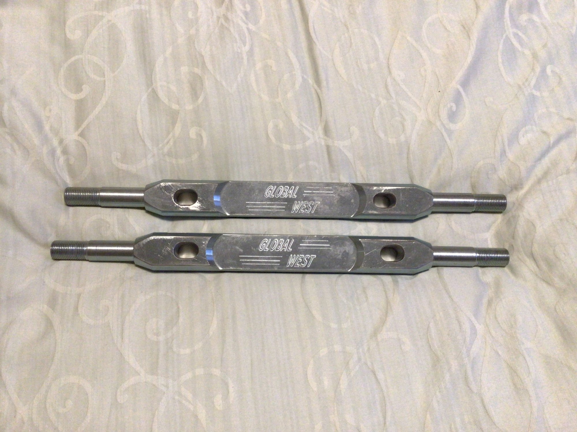

My recommendation is to slot the upper control arm cross shafts. The stock ones, after slotting, appear too weak in my opinion so I bought a set of beefy Global West shafts and slotted them slightly more than 1/4" to hopefully get 5 or 6 degrees of castor. This picture shows them after slotting.

What arms did you use the GW shafts on?
M
Planning on installing them on my stock powdercoated arms. I'll be installing the hydroboost/ borgeson steering at the same time.
