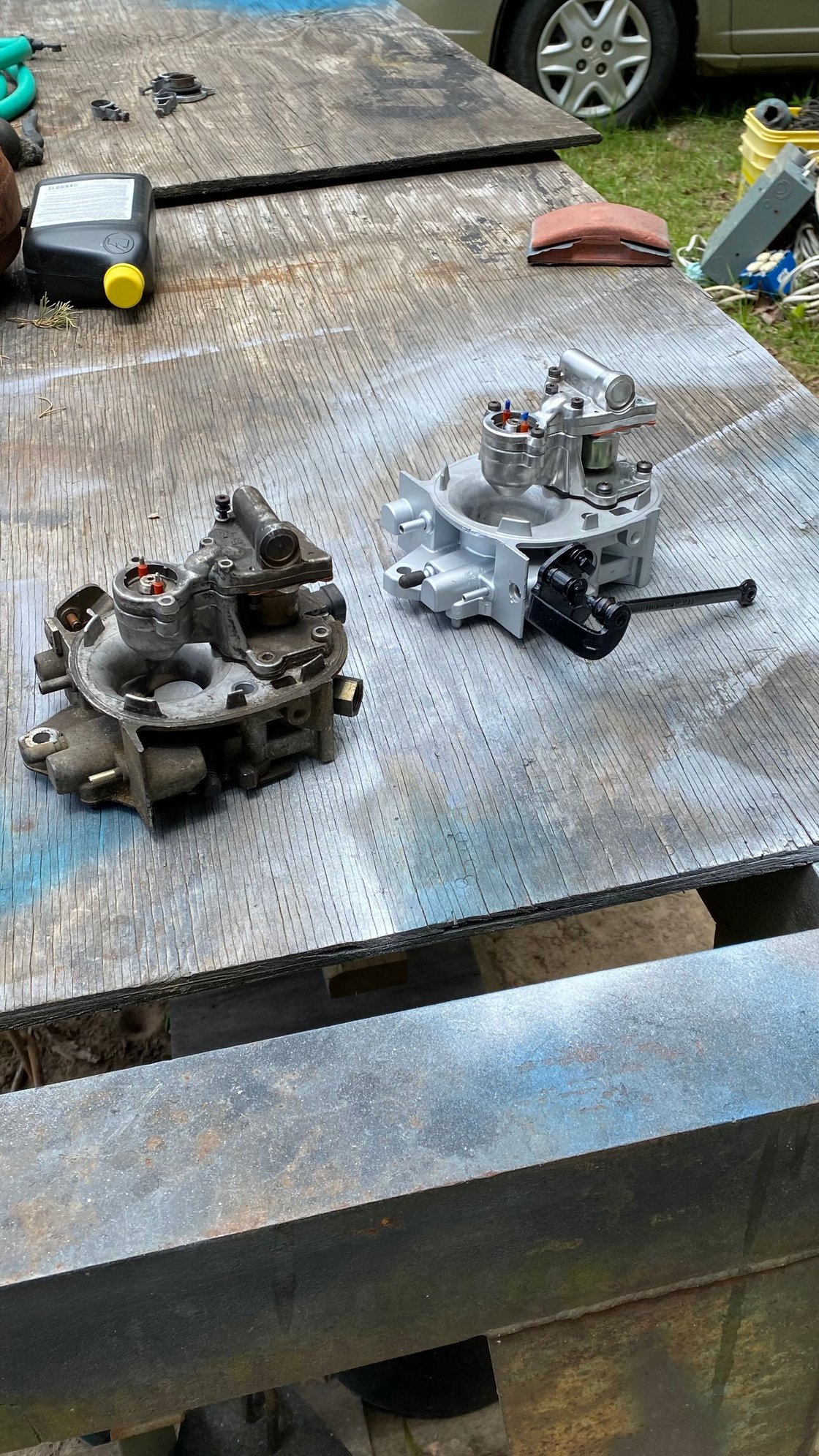

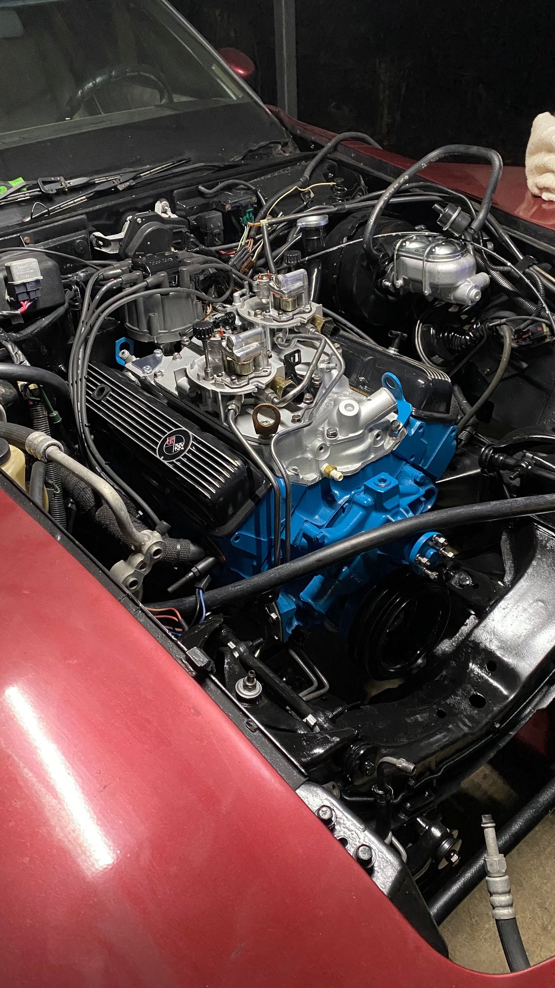

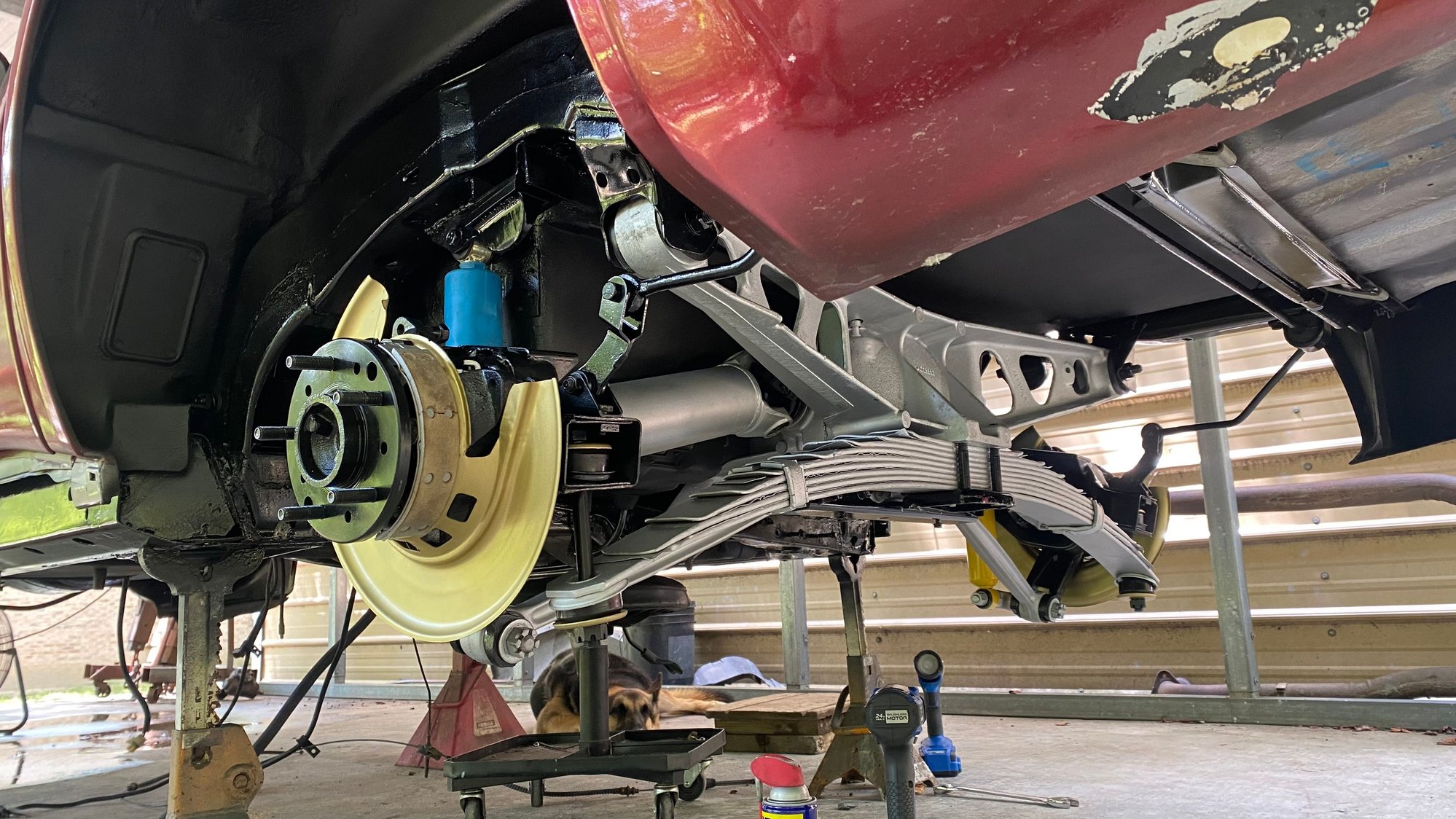

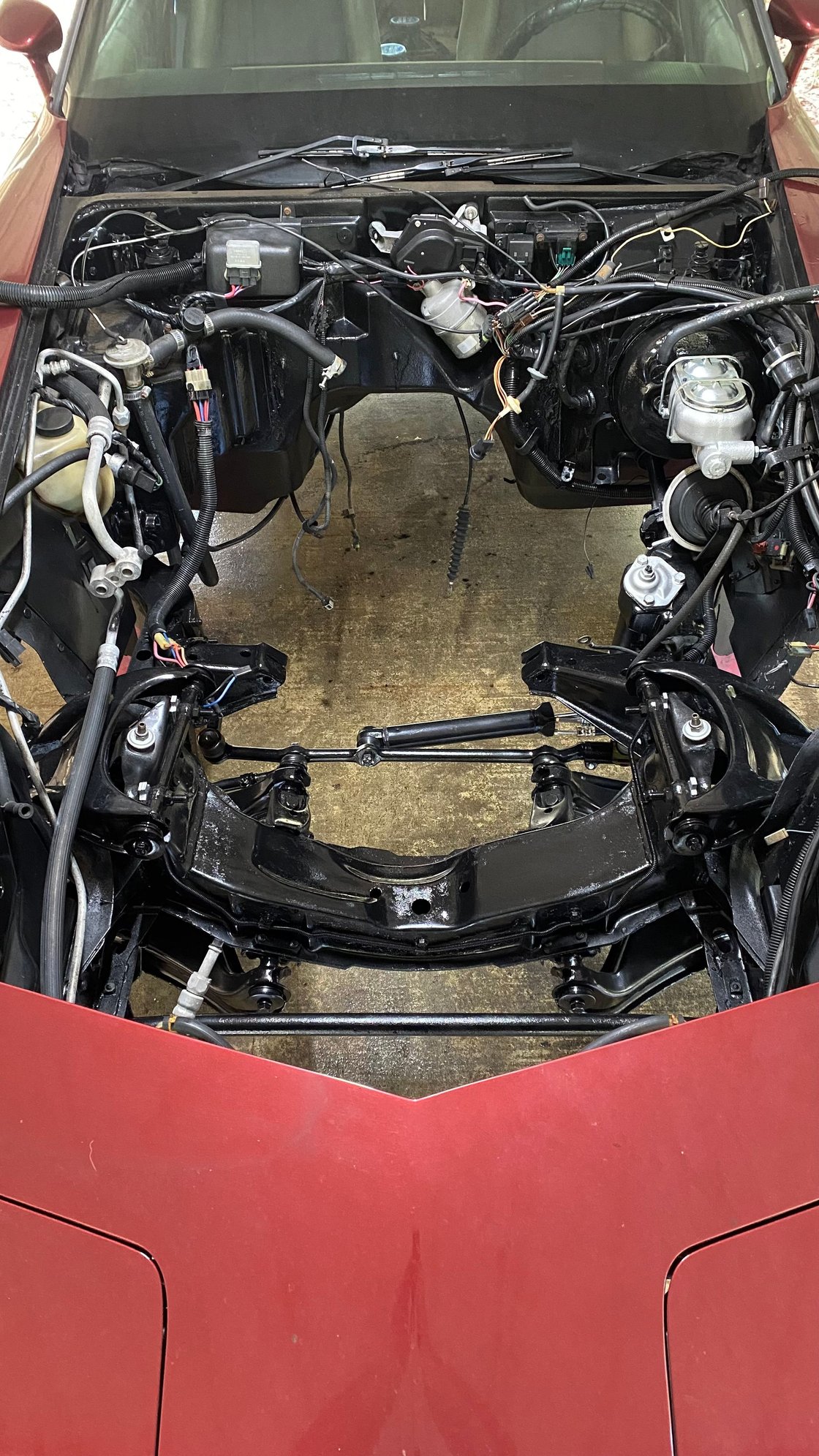

So, first time poster. I have an 1982 collectors edition, at least it was. Has been repainted and I’ve done a full restoration and just did black interior. Car has been totally rebuilt, drives great, runs great, HOWEVER, the IAC’s don’t do anything. I tried a couple cheap sets in it and have gotten some little more exspensive ones thru advanced auto and nothing. I’ve not been able to find any information about the operation or what each wire does as far as who’s hot at what time and how much voltage should be there etc. I think I’m getting 10v on some wires iirc. 10v seems odd to me. Any advice or incite would be greatly appreciated. I’ve done so much work on this car and for it to not be perfect is unsettling. I made the decision early on to just keep it stock, she’s just for driving and enjoying not hot rodding. Adding some photos for fun.

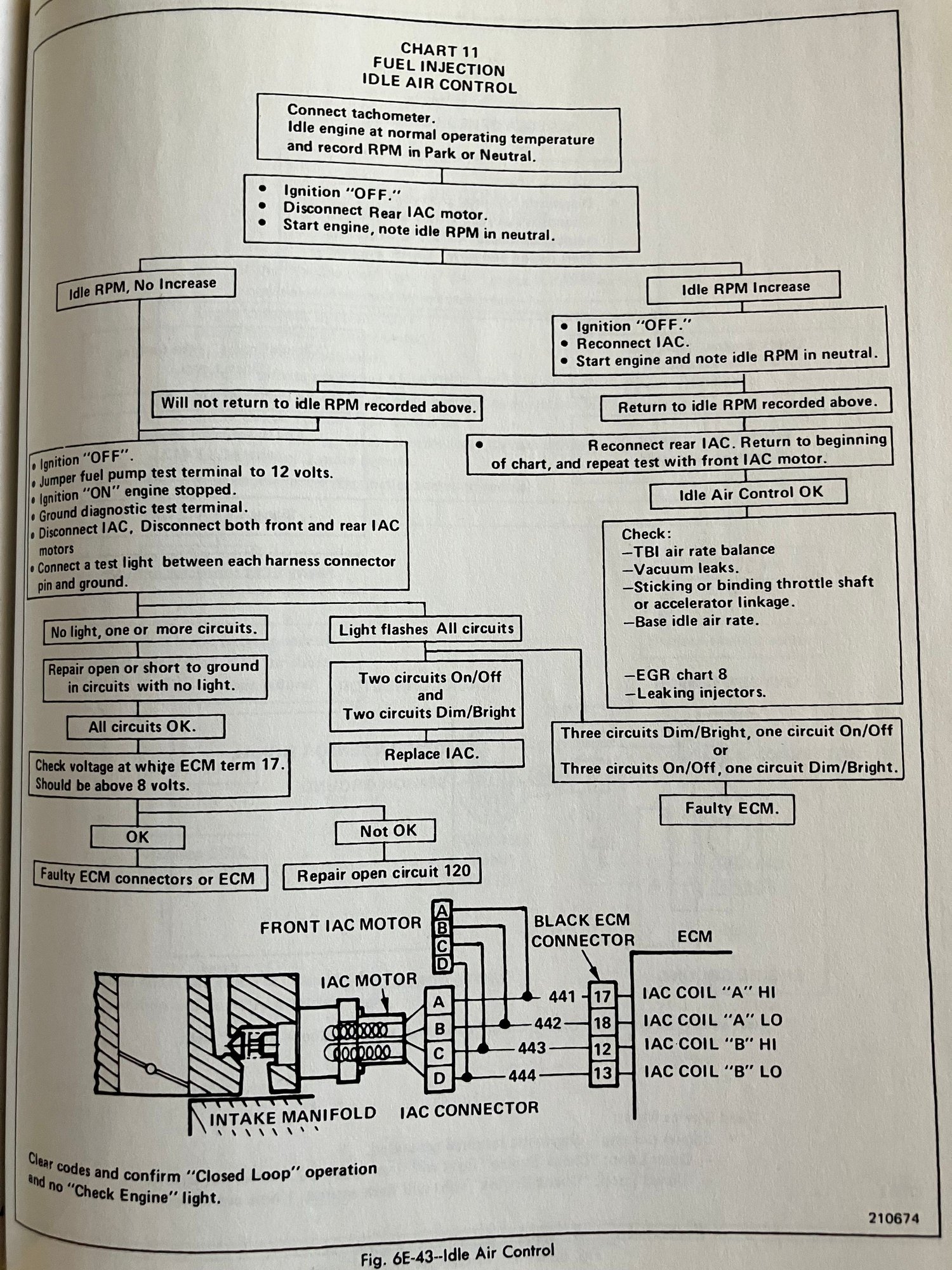

In the meantime, here's the diagnostic procedure from the manual. You're already on the left side of the chart. Let's hope it's just a bad connection somewhere between the IAC and ECM and not the ECM itself .

Wow brushmor that’s some great info. I’ll definitely have to get the fsm. Should I get it for the ‘82 or ‘84? I’m concerned the Ecm may very well be the culprit

There's way more than just the crossfire stuff so get the 82 shop manual. Rock Auto even has reprints electronic copies that are cheap.
One thing I forgot, here's a wiring diagram that will help with your diagnosis: https://www.xfireperformance.com/diagrams.
