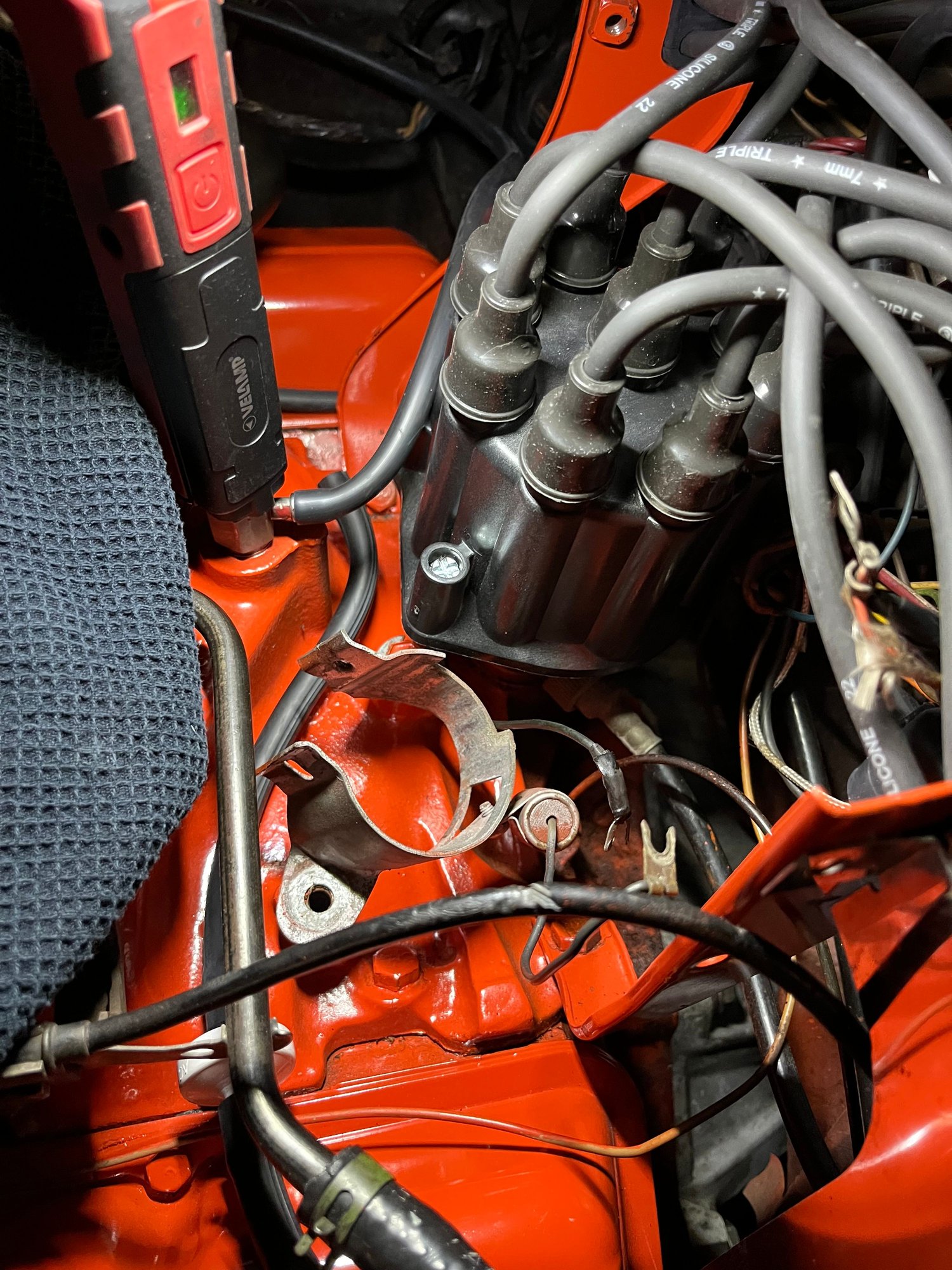

Picture showing the cable hooked up to the distributor with the other end running wild, curious to see what the rest of the able looks like after hooking it up.

Is the distributor correctly clocked? Post a picture of the distributor from above.

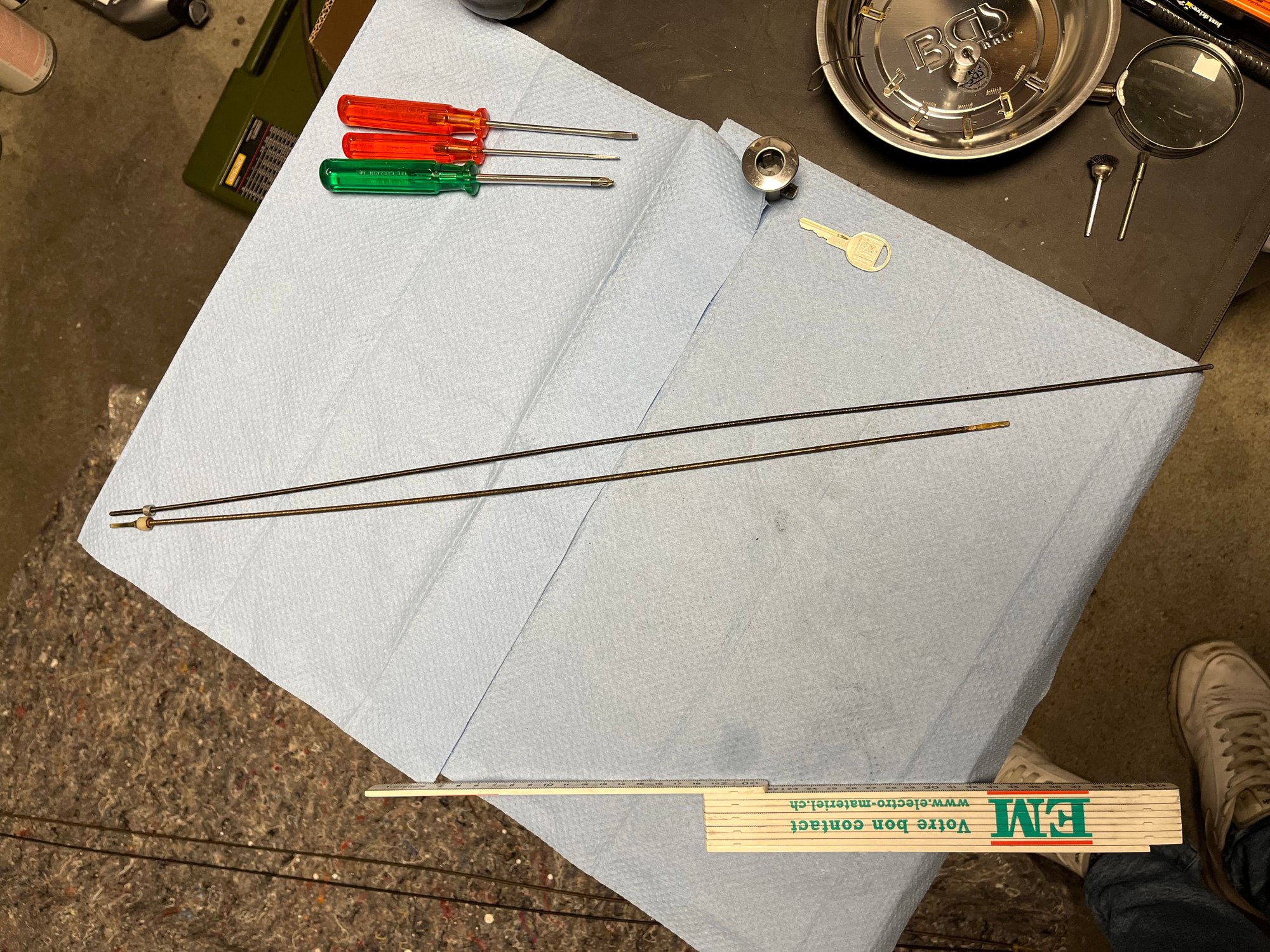

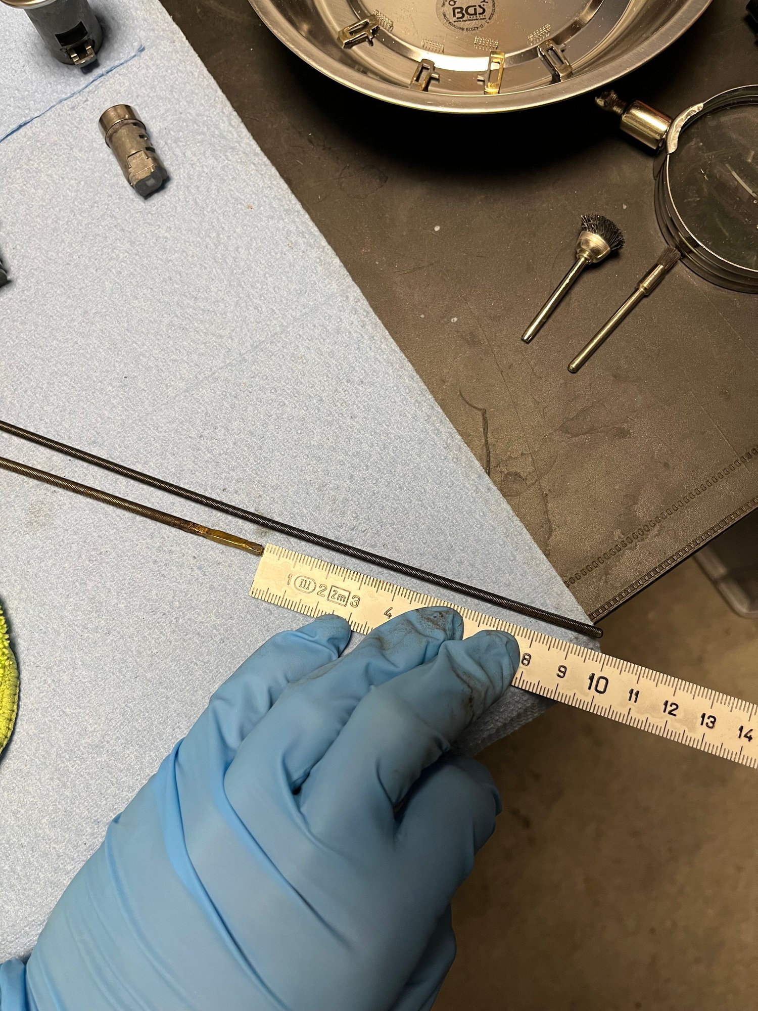

Clocking should be right. Here is a pic how it was installed.
Factory vs. Reproduction

Yes, the original one is maybe 20.6" and the reproduction from Paragon is 24".
I will go the way Gary says. Anyway, I will overhaul my Speedo and Tacho locally here; I hope the same company can make the correct cable. They have experience since 1958 in mechanical gauges.
I give an update in the future for all.
