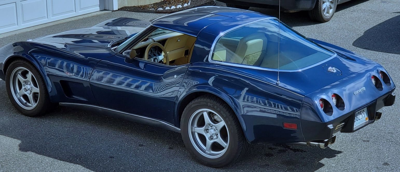

You need to find 17/18 rims you can live with for your C3 in order to get Ultra High Performance Tires. I believe there are steel rally corvette look alike aluminum rims in 18 inch and someone has a replica of the aluminum 15 inch rims in the later 70's like OEM on my 78 in18's.
17 inch SLP C4 ZR1 rims, no longer made, with exact C3 offset.
255/45/17 ZR's in Front and 255/50/17 ZR's in rear. They not only have tons more grip than my old 255/60/15 BFG Radial TA's (all for looks, zero performance for handling and braking) but they ride SO MUCH better on my C3 OEM Gymkhana suspension, upgraded with Bilsteins, 360 monospring, 550 springs 1 inch shorter in front, Poly sway bar bushings front and rear swaybars, poly front control arm bushings, front spreader bar, birdgage reinforced hidden brace etc.....others that own C3s that have been in my car cannot believe how well it rides, tight and sqeek free.........tires are a big part of the ride
