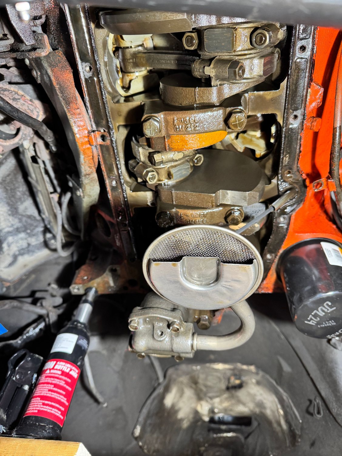

I have another thread where I'm posting details of my conversion from a TH400 to a TKX 5-speed. This is a slight departure from that topic.
I dropped the oil pan on my 350 tonight since its all beat up and I intend to replace it. I also have a leak at the rear that needs to be addressed. However, once I dropped it, I found a veritable Alladin's Cave of plastic debris jammed into the oil pick-up. I can't even imagine the source. Any thoughts from the engine guys amongst us?

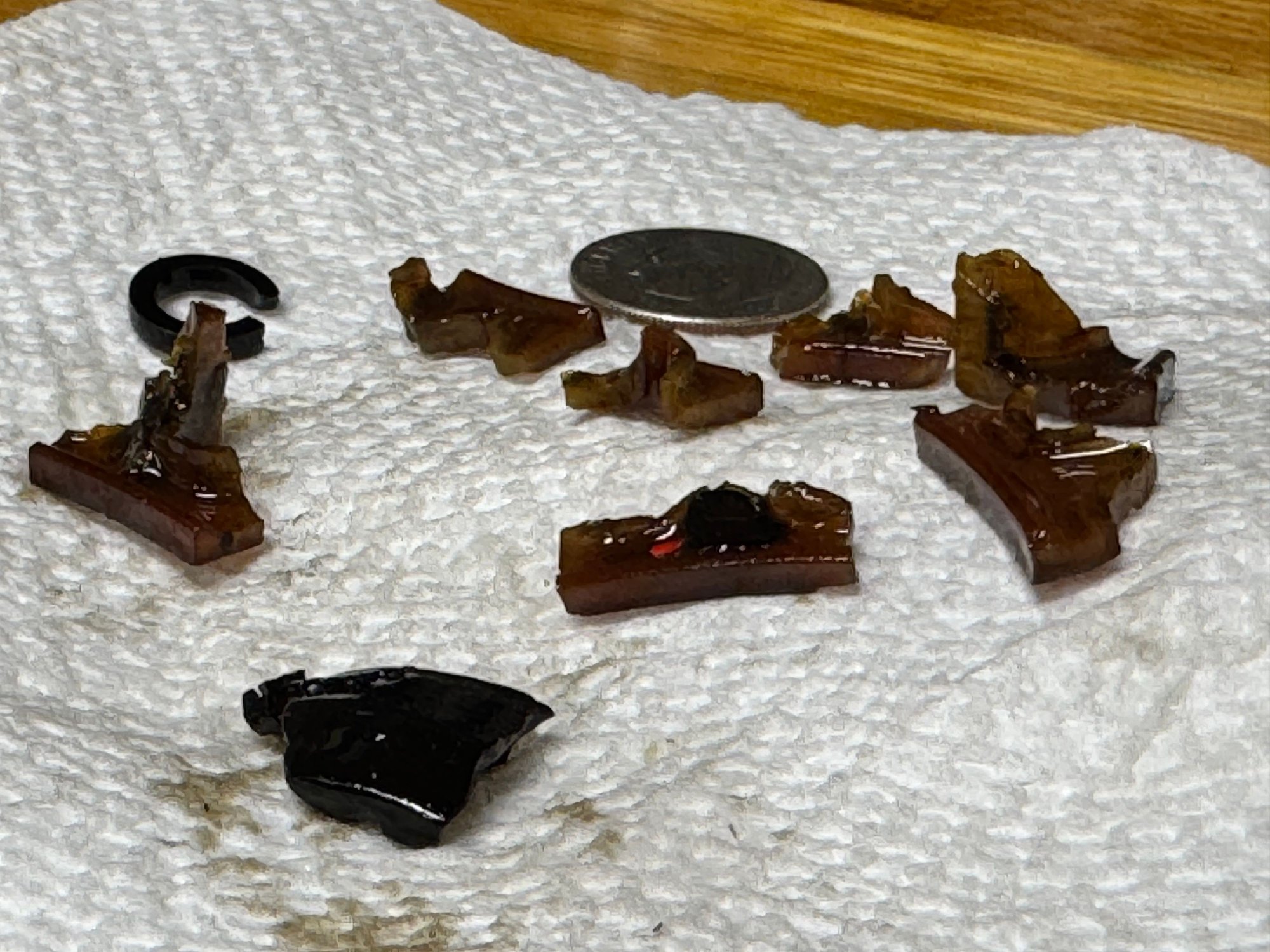

is your nylon timing gear coming apart due to bad camshaft “Walk” or do you have an Ememy somewhere?

Ross72
Did the timing gear previously fail? Only thing I can imagine with one of those plastic "encased" timing gears that fall apart? If you want to play puzzle start arranging them as they would exist on a timing gear......
May have just changed the gear and not cleaned out the sump. No biggie I reckon as long as you got the pieces out. Might wanna eyeball the timing chain area.

Not sure but the remnants appear to be nylon. I recently learned some chevy truck motors from the 70's had nylon teeth on a steel timing gear. If you motor is a Corvette motor then possible bubba used service parts many years ago to replace timing gears or you have a truck motor in your car?

All Gm big and small blocks cam with a nylon gear. As a side note, Bill Jenkins ran nylon gears in his pro stock veg and monza( changed every few runs) as he felt it did not transmit bd harmonics to the cam and distributor, thus a effect the engine timing.

I’d check the timing chain before running that engine, that looks like complete destruction.

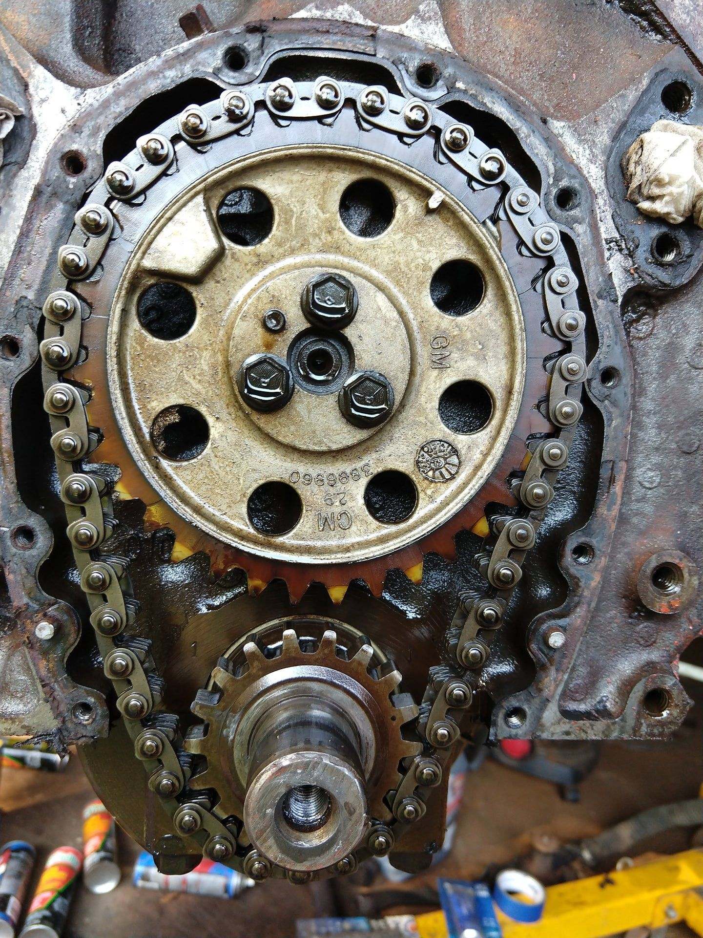

Got it! Upper timing gear. Now, the big question is whether or not this is just leftover debris from a long resolved issue or if there’s a minor disaster lurking beneath my timing cover. The engine ran fine a week ago so it’s hard to imagine my timing gear is completely smoked. I guess the only way to find out, for sure, is to take a look under the timing cover…unless someone has another suggestion. 🤔

with the pan off you've got the worst part of the timing chain job done . If you don't drop the pan the timing cover is a pain to get sealed .

Looking at the front of the engine, dead on, look down on the lower left of the timing case, if you see a bulge that is outward and looks different from the opposite side it’s an indication of the timing case being beat up by a slapping timing chain This could have been from the previous owner who repaired it or current issue
usually when most mechanics do a timing chain they will take a short cut and turn the timing case cover into what is referred to As a “Quick Change” cover like the one sold by Mr Gasket. They grind down the rear steel lip on bottom of the cover that retains the seal. This is done to void dropping the pan during cam changes/reassembly. Signs of this or etc sealer present will be an indication this was the case and they did not drop the pan to clean it out. Now would be a great time to install a melling HV-55 high volume pump, Moroso pump drive and braze the pick up to the pump. If you do the chain , since your halfway there, install a close tru roller timing set and be done with it

Might as well replace it with a real metal timing gear now. That looks like the nylon **** there...

Engine runs fine. I drove it all summer and only parked it a week or so ago.
I was really only hoping to squeeze another summer out of this engine before replacing it with something a little more spicy. It’s got 104,000 miles on it and I don’t think it was terribly potent when it was new. I’ll definitely replace the timing set, but I’m not sure how much more I want to sink into it in the way of upgrades.

Since you're in there replacing that timing set is well worth it. I helped a friend do his ages ago and it was relatively simple...and you're already there.

But OTOH you absolutely do want to check that nylon gear.
If it is still in there, it could "blow" at any time, and leave you stuck on the side of the road.
But from that pile of nylon, I would guess it is long gone....
