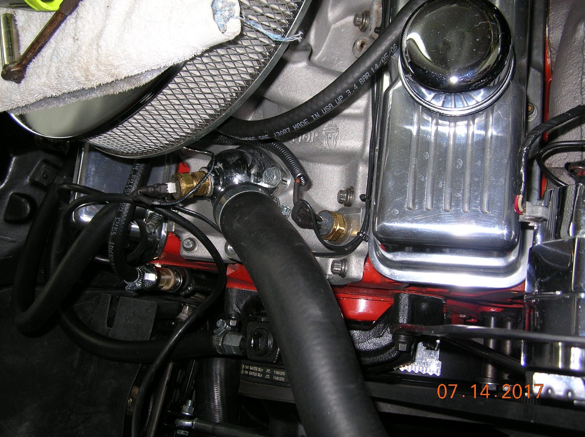

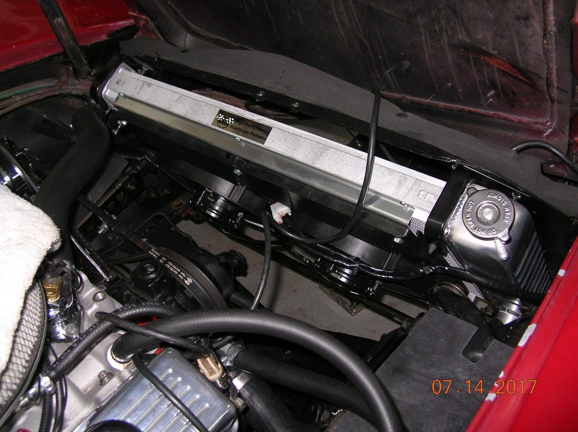

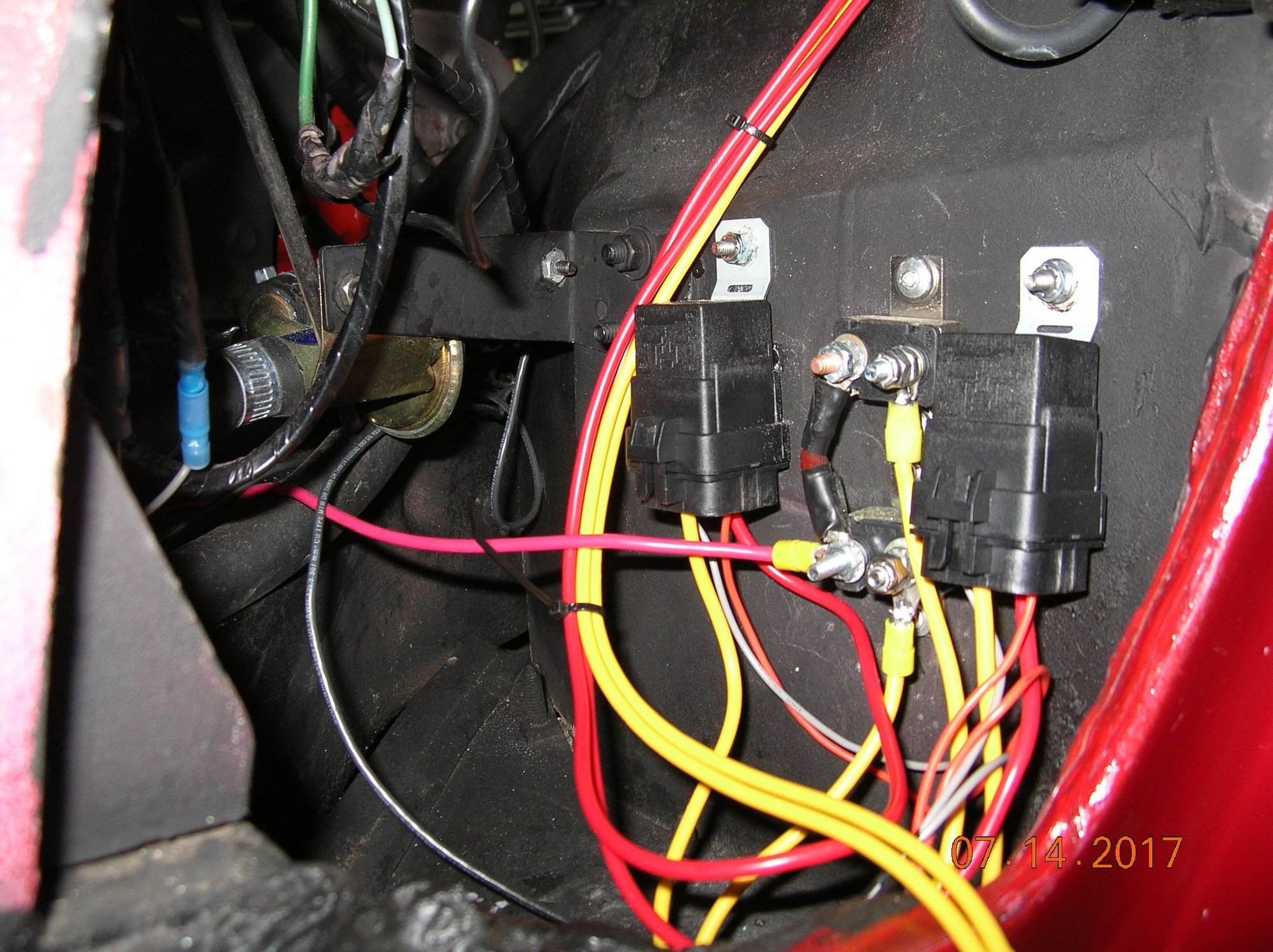

my 71
my 71
fan relays
fan relays
fan stats  / trips
fan stats / trips
One trip is 170 deg, the other is 190. Has been on the car for 15k miles and 4 + years, no issues .
