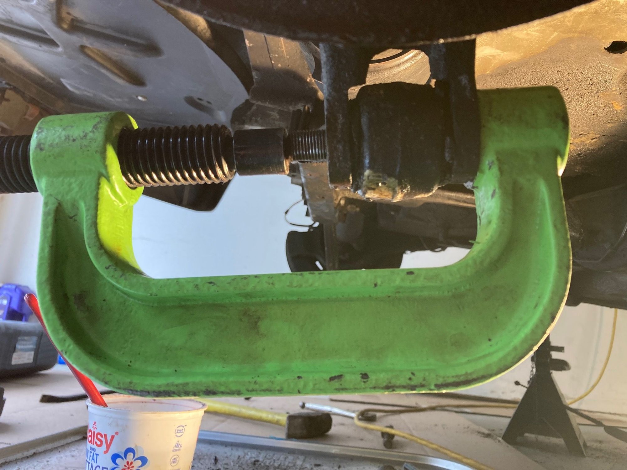

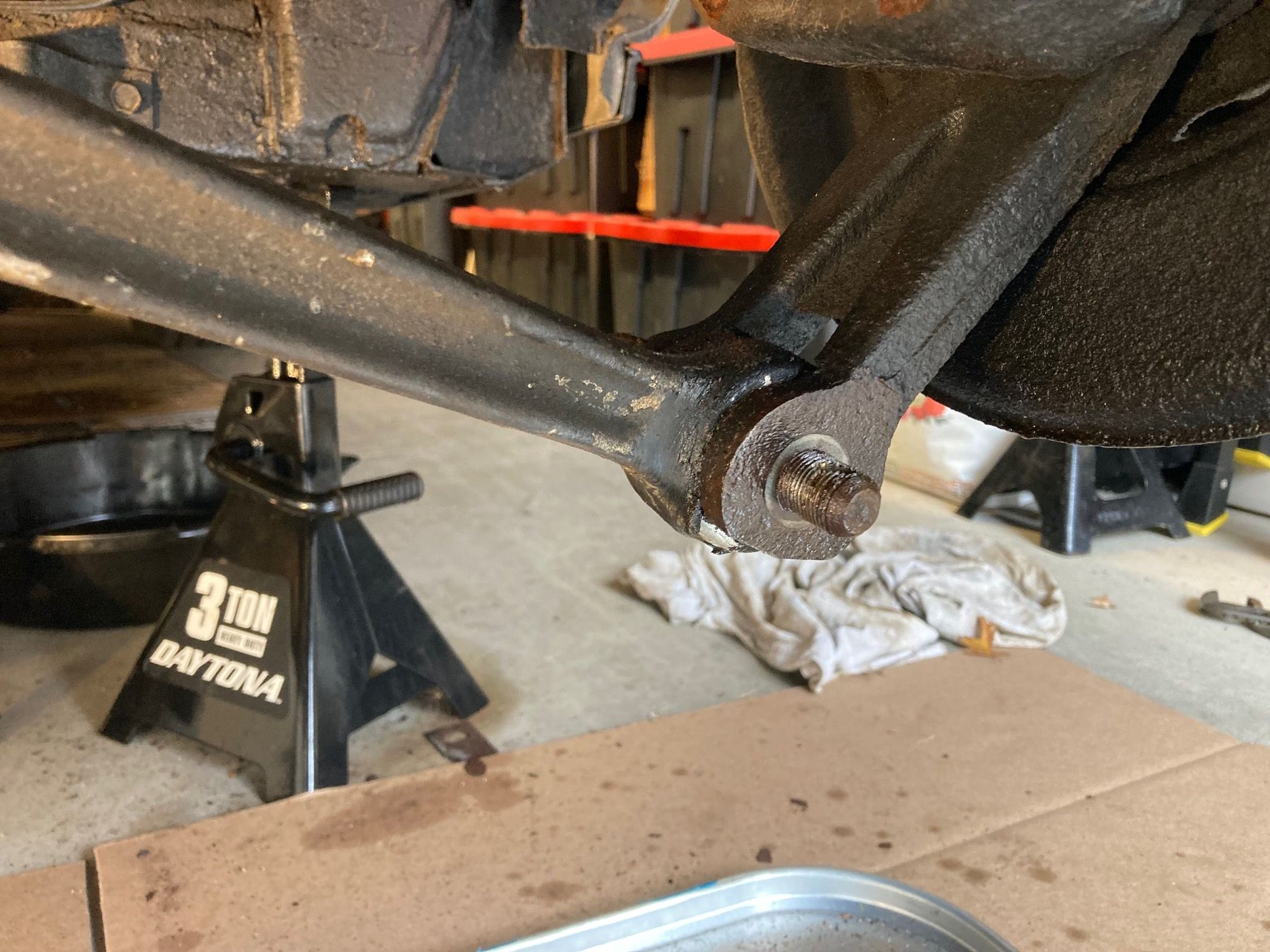

UPDATE: I finally managed to get the shock mounts out of the spindle mount. I'll explain my method below for anyone else that is faced with the same issue.
First I cut off the threaded portion where the shock bolts on (see photos). This allowed me to slip the ball joint removal tool over the end. I used a heat gun from Harbor Freight to heat up the mount location and dowse it with 50/50 trans/acetone mixture. The heat gun gets the metal plenty hot as the 50/50 mix sizzles when applied. I also used a hacksaw blade (just the blade) to saw through the rubber bushing so the 50/50 mix could get to the bushing sleeve. The trans fluid causes rubber to swell and I was thinking the mixture may not be getting through the the bolt and sleeve area. I did this heating and dowsing several times... probably 5-7 times over the course of two days. Then I tightened down on the Ball Joint tool using a breaker bar and a 2 foot cheater pipe. It got to the point where I thought I couldn't get it any tighter, until it popped! Hope this method works for others facing the same issue.
Shock mount bolt.
Shock mount bolt.
Back side of bolt after being cut off... leaving some of the bolt on holds the ball joint tool in place.

Ball joint tool in place (loaner from AutoZone)
