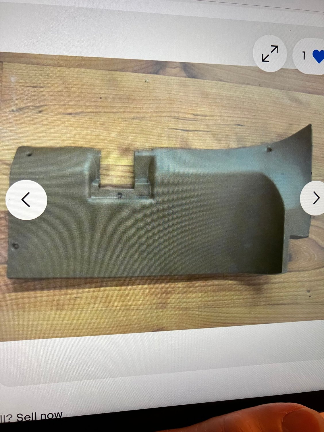

Can someone help me with identifying halo panels with removable rear windows? Mine is a 71 coupe and I’m sorting thru a local Vette suppliers parts trying to find the correct ones. I see that some have the cutouts but no indentation.

The ones without the depression for the window latch bezel are 68's, 69-72 trim panels all have the depression. There were two variations of the 68 trim panel, with the difference being in the size of the latch opening I believe.
