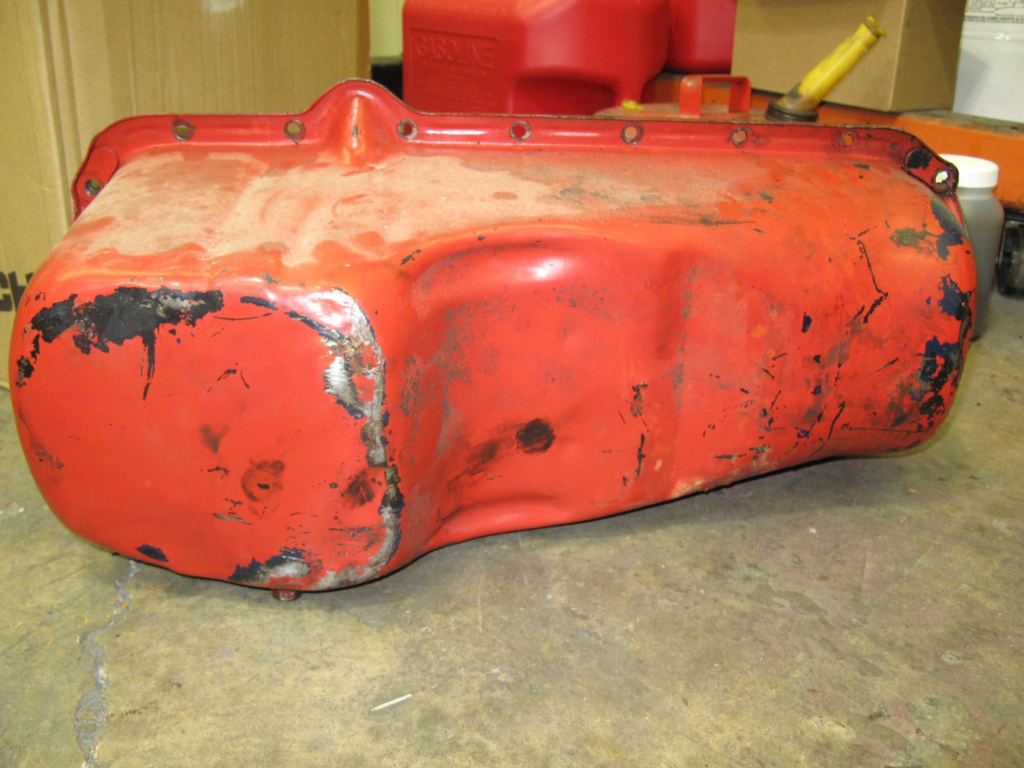

Does this pan look like it would fit? It came with a motor I bought.

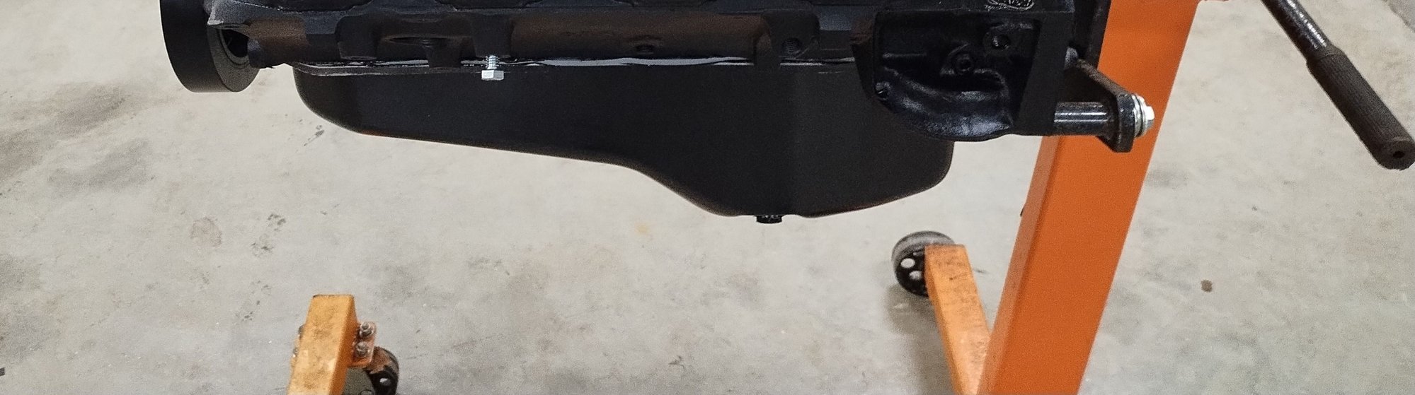

This is what my oil pan looks like on my new crate engine
