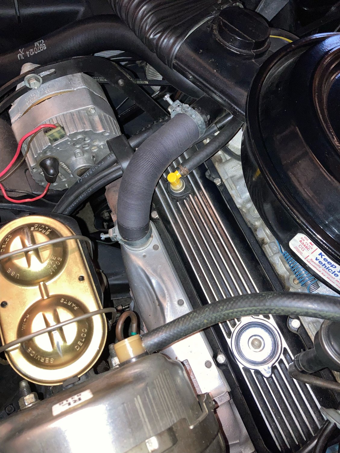

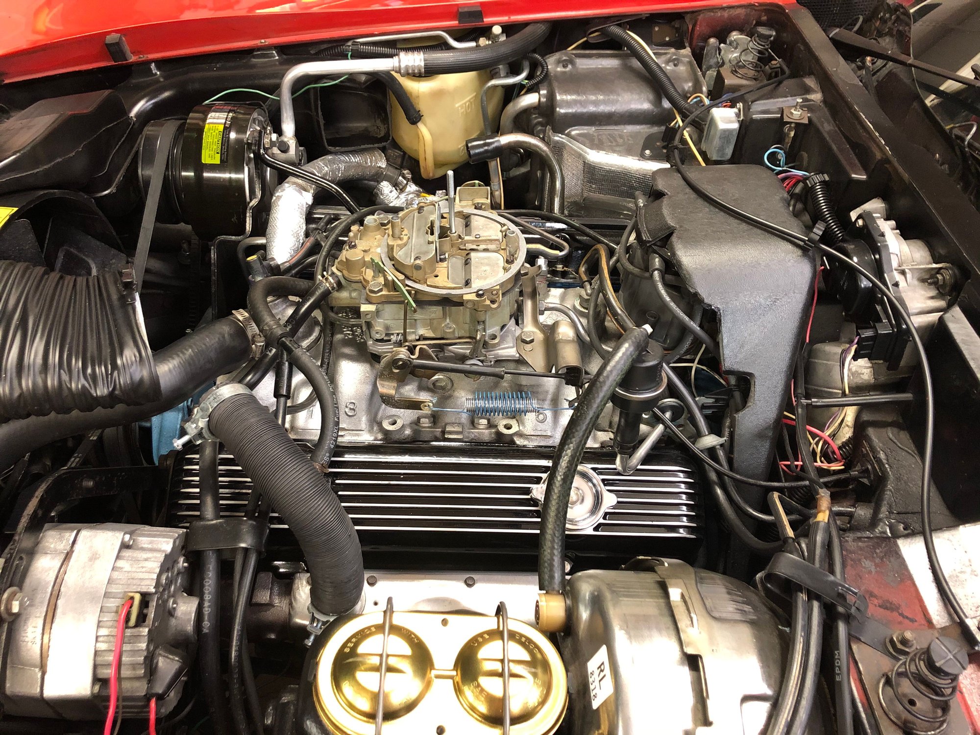

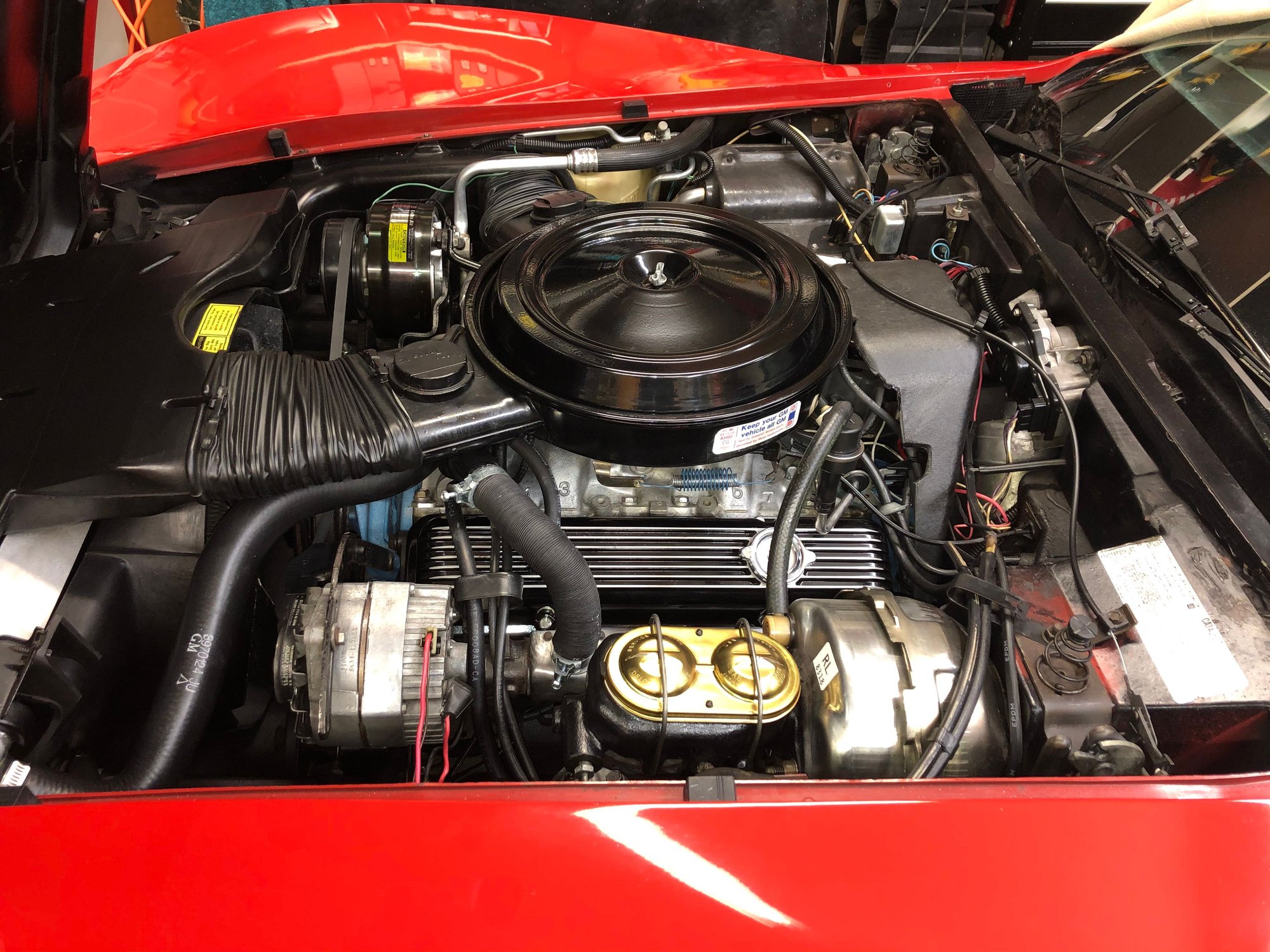

If helpful here is a 79 4sp l82 routing. Egr, air pump, and exhaust flapper preheat valve plugged
looks like brake hose also is supposed to be upright..
i took pics when carburetor rebuilt so i wouldn’t screw up.
your car looks pretty honest and original

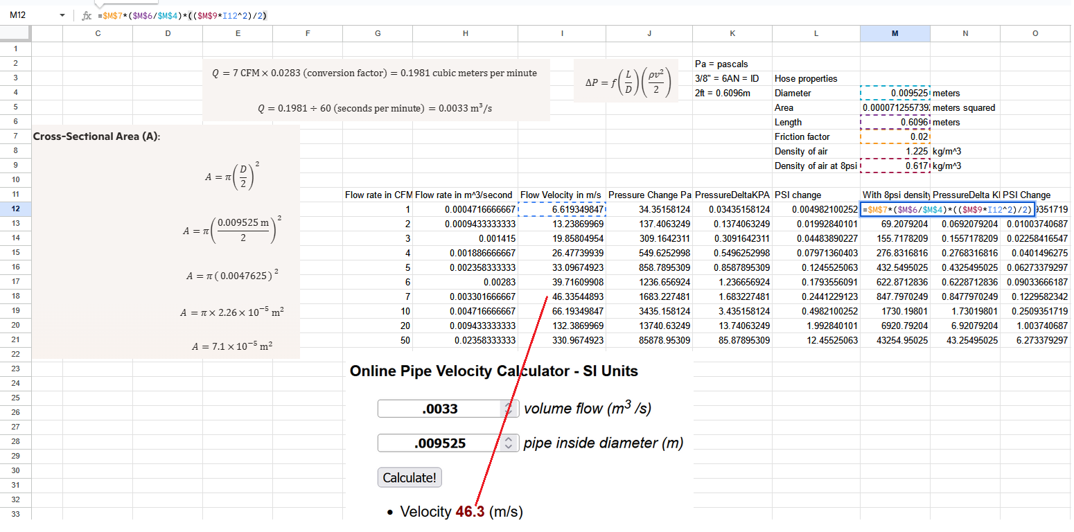

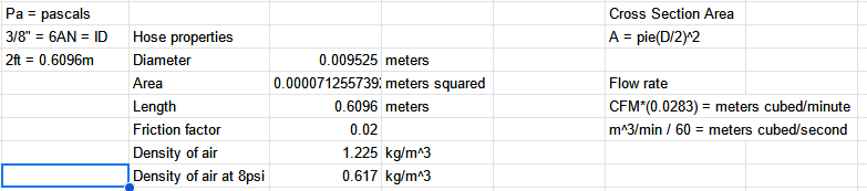

First here is the properties of the air and the Hose being used for PCV / Braking. It is a 2Foot hose in this example, with 3/8" inside diameter. Typical automotive hose.
The air density at atmospheric pressure is around 1.225kg/m^3 however when the intake manifold is at 15"Hg~ The pressure is around 7 or 8psi and the air density is around half. That is typical idle and cruise vacuum applied to the PCV system. The atmosheric pressure is a worst case scenario for wide open throttle, there is no vacuum and the brakes would not work but still lets just see what the pressure drop would be under these bad-as-possible condition.
We will evaluate the change in pressure using Darcy-Weisbach equation

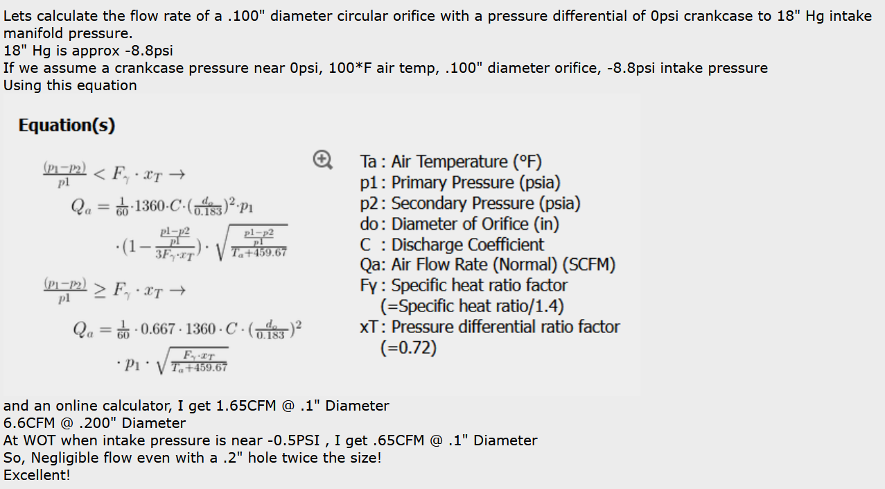

Typical Automotive PCV systems flow 1 to 3CFM. I calculated this already a while back for the fixed orifice 0.1"Diameter on a Corvette for example, this is the equation I am using
https://www.corvetteforum.com/forums...post1605229916

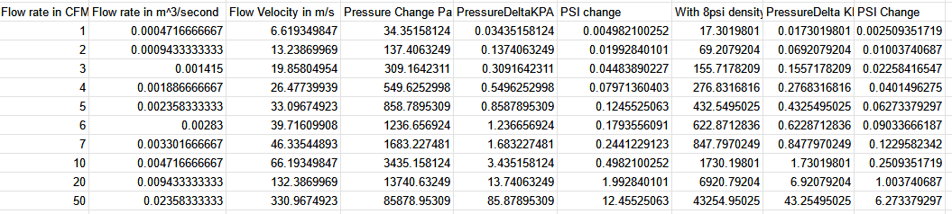

Here are the results with atmospheric pressure and intake manifold vacuum.
'PSI Change' Is the change in pressure due to the flow rate in CFM.
Notice it takes around 20CFM of flow, which is about ten times what the typical automotive PCV system flows, to exert a change of 1PSI in pressure inside the hose, when intake pressure is about 8psi (idle/cruise typical pressure).
Even if we placed 5PCV valves in a 'T' fitting with the brake booster, the change in pressure is only about 1/4 of a psi.
I conclude that PCV flow is negligible with respect to braking performance and that is why I've done it for decades and will continue to do so.
Is it wise to isolate the brake booster hose? Sure why not. But if its not convenient to do so - it really doesn't matter in terms of pressure even with multiple PCV valves tied to the same hose as I have and continue to do so, some engines need 3x pcv valves to evacuate their crankcase. The PCV system is a tuned system, if you change something on the engine like the intake pressure or air filter, the PCV system needs to be re-evaluated.
I am willing to accept and evaluate any counter arguments based on math or evidence such as empirical data collected from an actual vehicle.
Otherwise, A consensus is not evidence, it doesn't matter what you say, just words, people copy an idea and paste it somewhere else. That isn't proof of anything other than human stupidity.

Here you can see my equation and online calculators agreement as I checked my work for each step
In other words, I did the math myself, then checked against a few online calculators to make sure the numbers lines up. Since, I will Rarely edit posts, so I am extremely cautious posting numbers.
