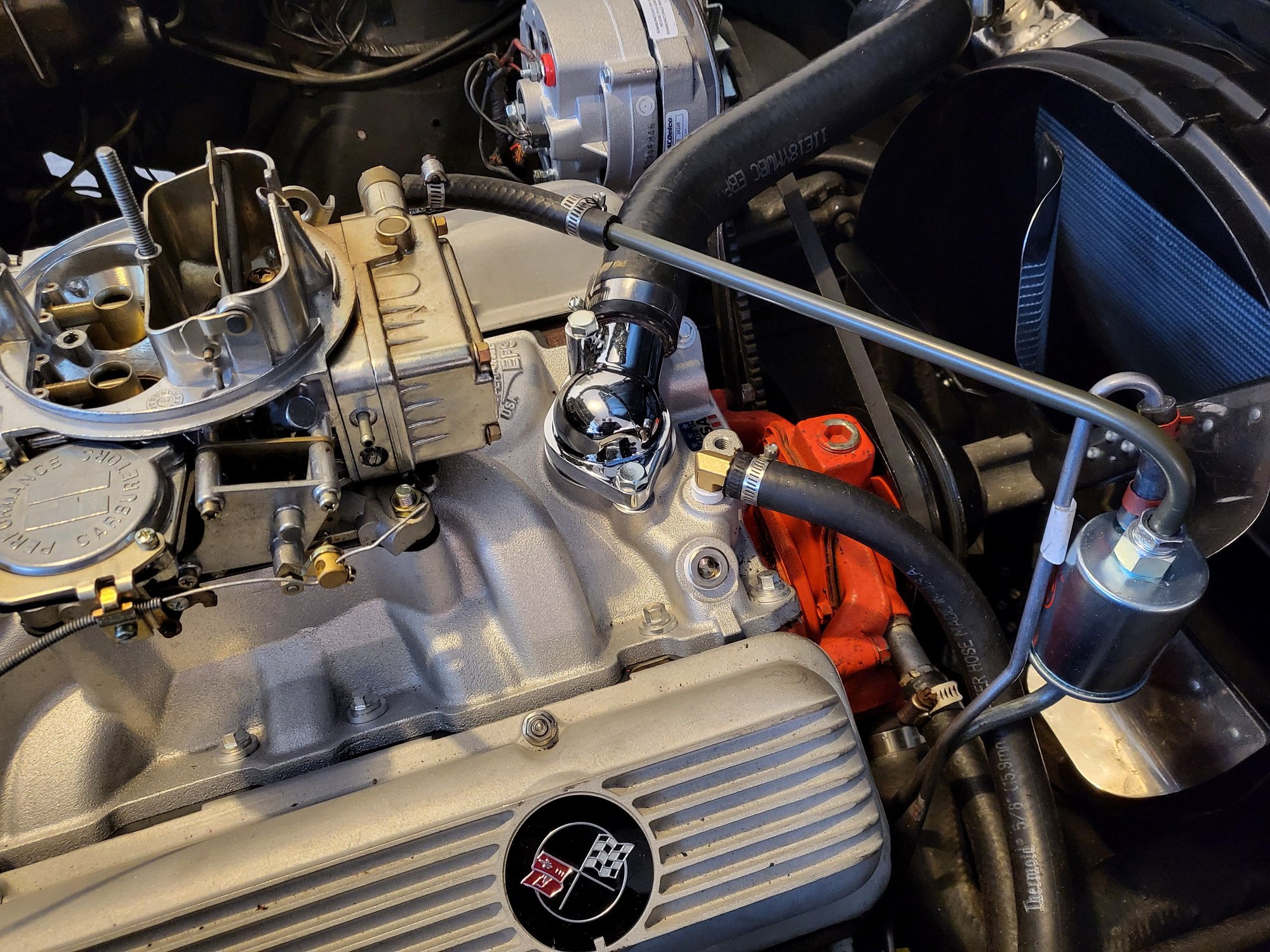

Default 68 pump to carb

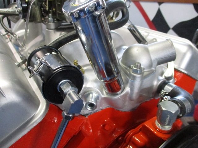

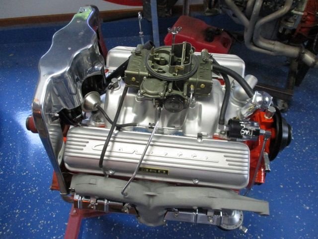

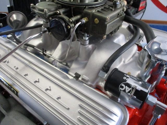

Bringing a 68 back to life. What am I missing, the filter bracket is supposed to fasten to the front of the block. The line seems to be bent the wrong way. Every set I've looked at from all the different suppliers is the same. 68, 327.
The bracket was designed for the original lines and fuel filter and carburetor. Cannot tell from the picture what fuel pump you have. You have a Holley, should be a Quadrajet, the filter should have a nipple for the return line. See the stock picture in the link.

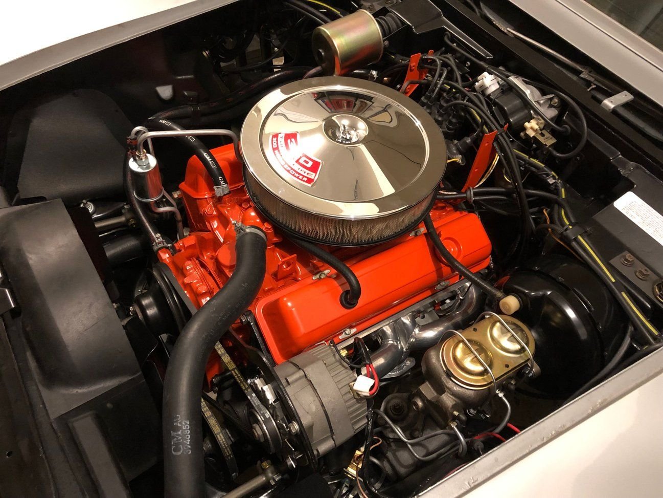

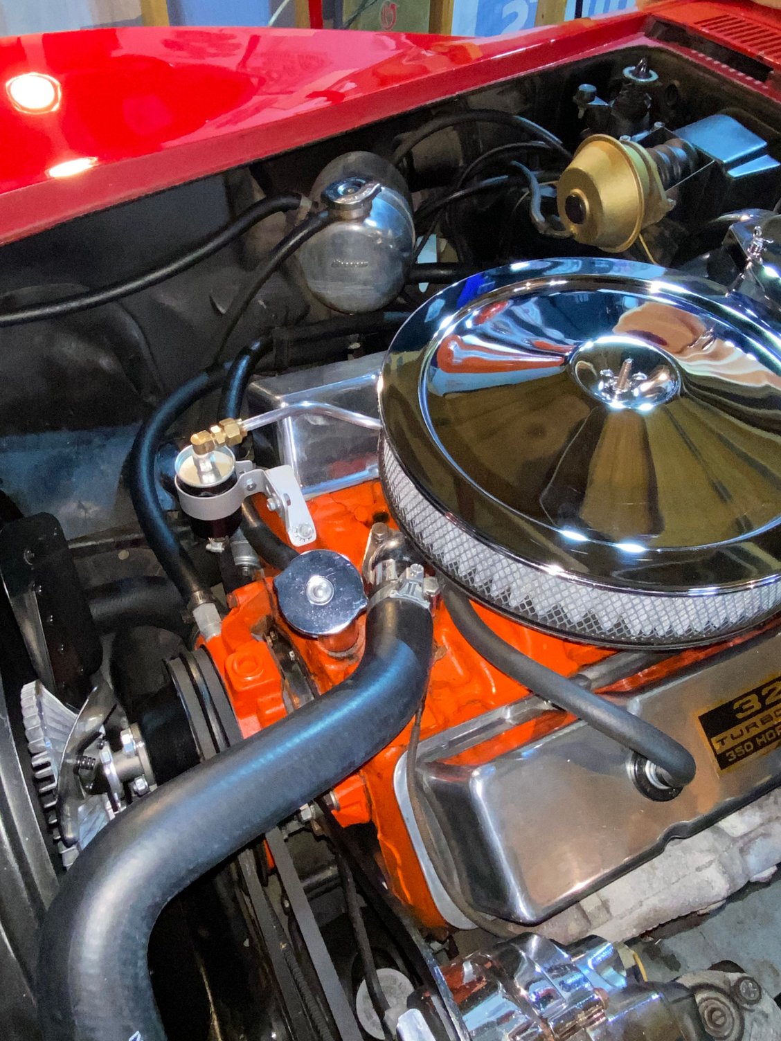

Old Dec 26, 2024 | 11:42 AM
Chagjr's Avatar
Chagjr
Joined: Dec 2022
Posts: 157
Likes: 97

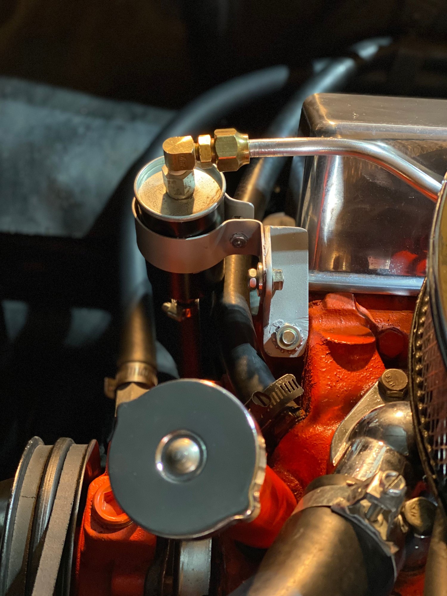

I’m not sure where the bracket is attached in this photo.
Here’s a different photo showing a bracket attached to the head.
From photos Ive seen, I think the bracket you are asking about would have fastened to the air injection pump. I had the same dilemma. I made my own carb inlet line like you. I made a bracket with a factory appearing slant. I used the intake attachment stud for the “65” fuel filter bracket with some pieces/parts I had. I painted the filter for presentation like a GF-90. My heads have no accessory holes.

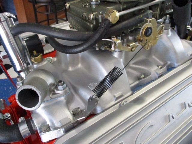

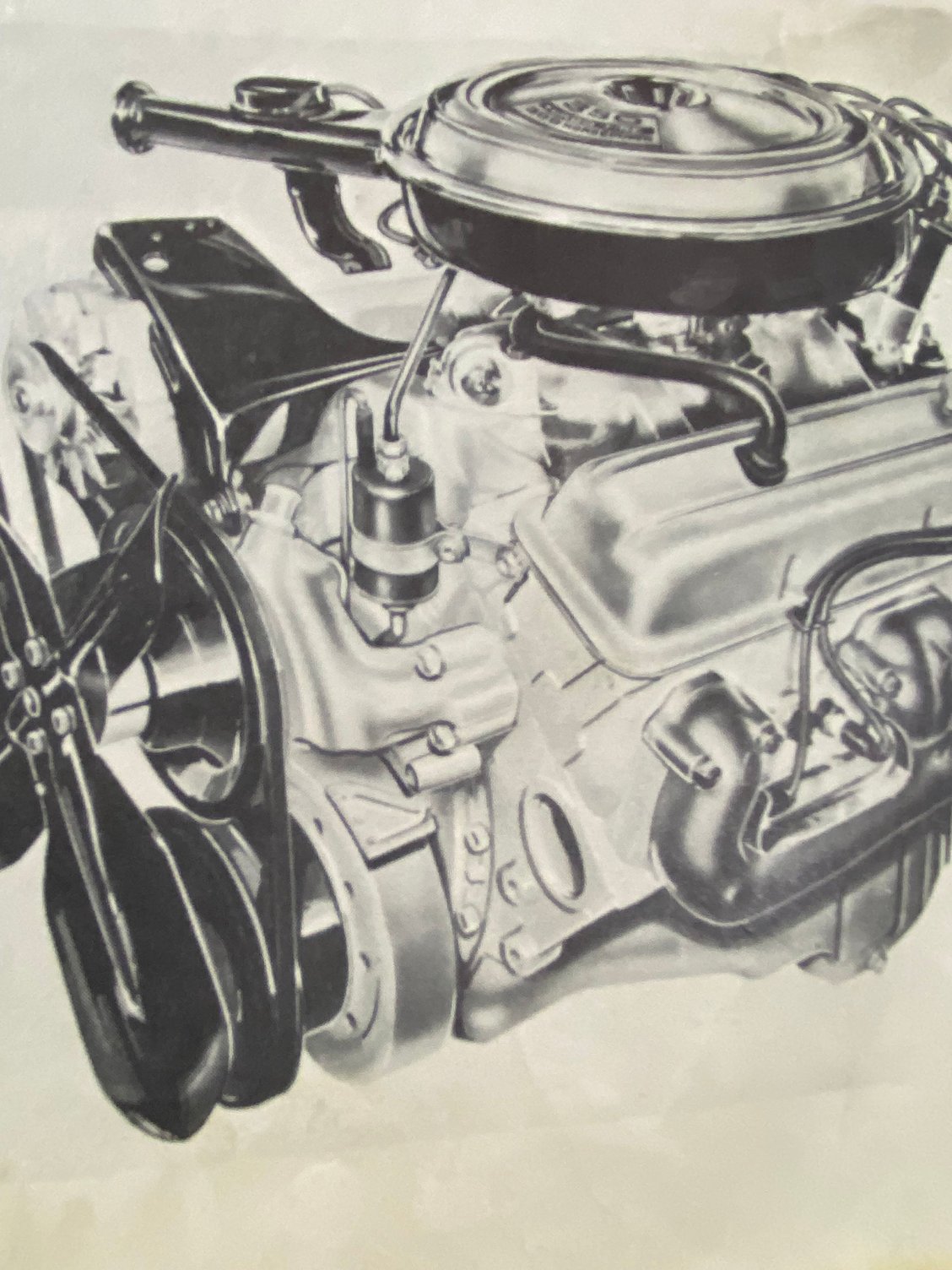

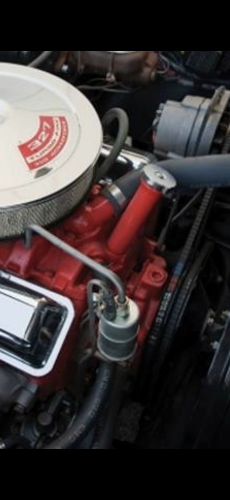

No, the filter bracket does not attach to the front of the block. You're trying to mix-and-match custom aftermarket parts with stock factory parts and expect things to fit and line up. It won't work that way. The stock filter and line system was used with the Q-Jet carb and an A.I.R. pump. You have swapped over to an aftermarket Holley carb, which requires a completely different, custom made fuel line. The stock line used a fuel filter with a return line (which you do not have, but you need it). That filter was attached to the A.I.R. pump bracket with the lower pump bracket bolt. You do not have an A.I.R pump installed, and you don't have the pump bracket, so you can't use the stock filter attach bracket. If you're going to build a custom, non-stock setup, you have to custom build your own fuel lines and bracket.
The stock system, looks like this - you can see how the filter has the return line, and how the filter bracket attaches to the A.I.R. pump bracket bolt.
Here you can see the '68 system installed without the A.I.R. pump, so it hangs out in the middle of nowhere with no bracket support - not the best idea, but at least the correct filter is installed with the return fuel line:
Here is a home-made bracket system that has been installed in place of the A.I.R. pump bracket to secure the filter. Not the cleanest approach, but it works. The correct filter bracket is clearly visible:

What I'm building is a reliable daily driver, don't care about looking factory. This is what I came up with.
I have hood clearance and the air cleaner sits as it should.

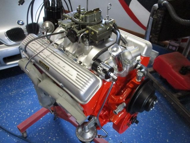

Likes: 6,390
If you just want it to look good, be "stock-like," and be reliable, you can use the 1965 fuel line intended for the single-inlet Holley used on the 327 L79. It looks like this. The '65 filter does not incorporate a return fuel line, however. It would just take a fitting change on the fuel lines and some minor tube fab work to use the '68 filter with return by laying the filter on its side like the '65 system as shown below. It would look a lot cleaner than the ill-fitting system you currently have pieced together:
