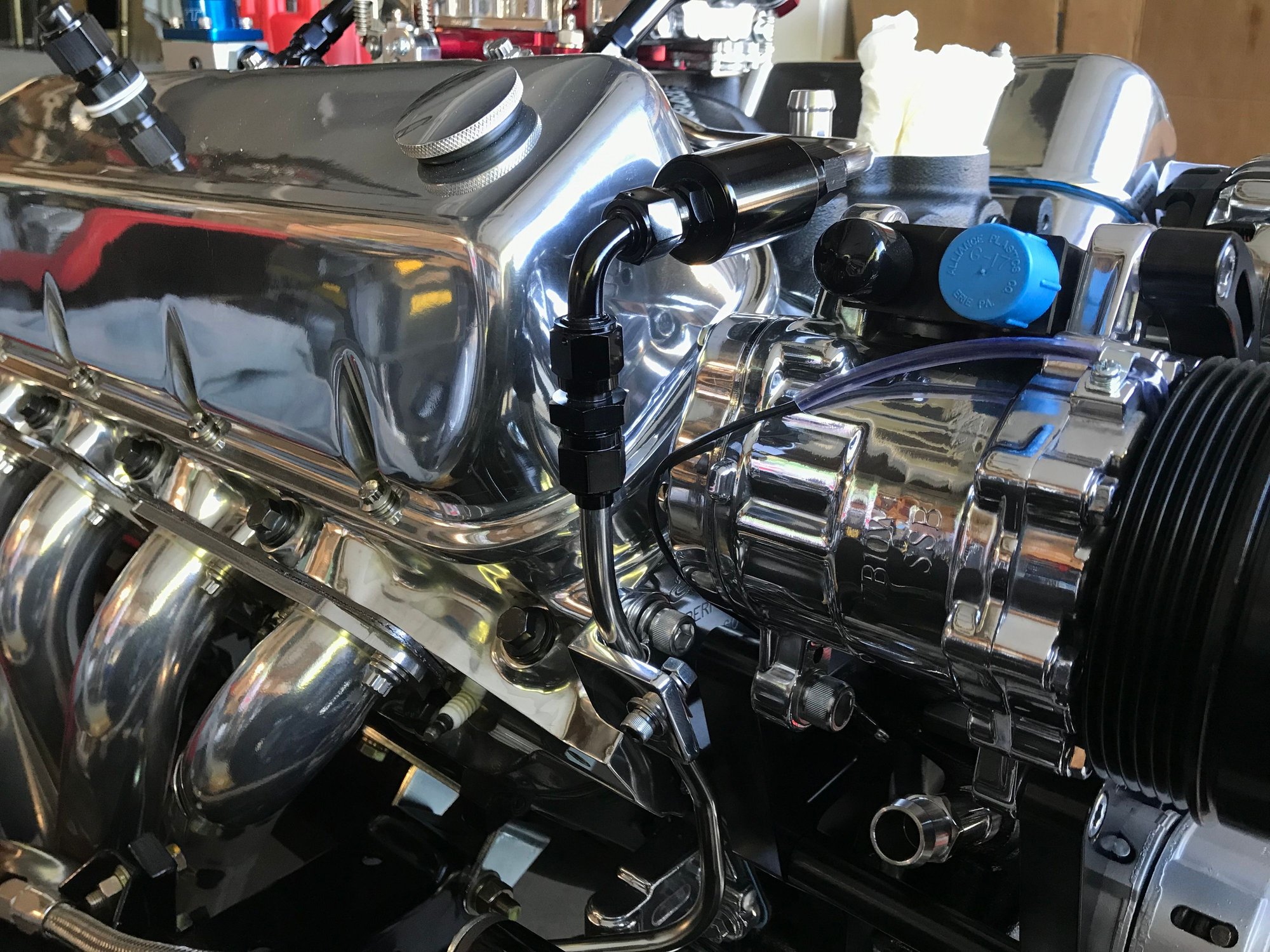

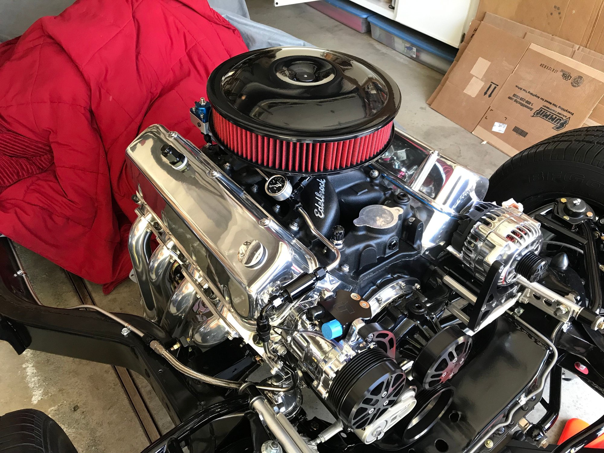

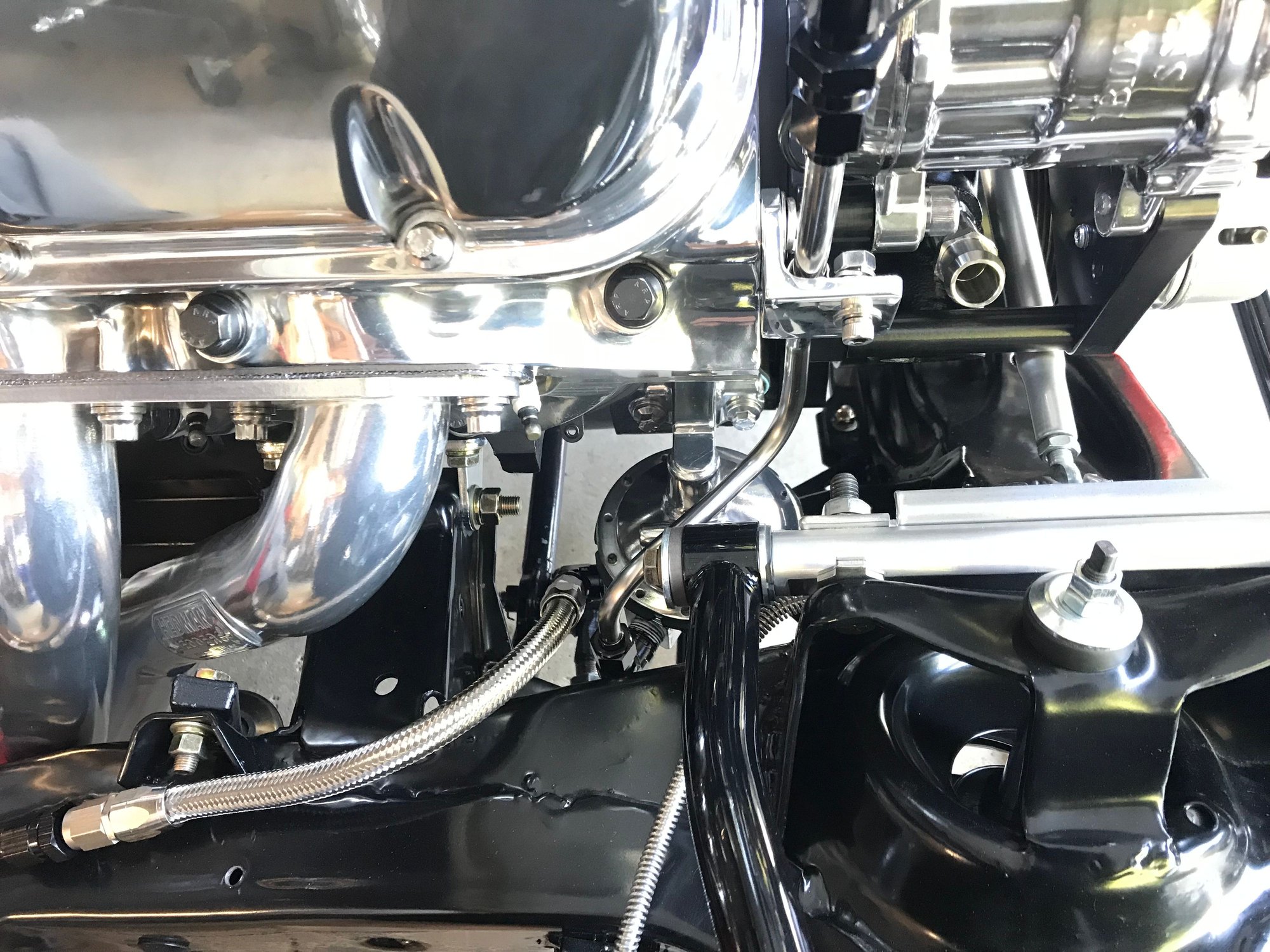

When you ordered your mechanical fuel pump, it should have listed what the output pressure was.
Some pumps are available with as low as 6 psi output pressure and no regulator is needed or required.
Look at Holley’s or Edelbrock’s website for their mechanical pumps and regulators.
Holley makes numerous in line fuel regulators that will work with any type of fuel pump.
Most are adjustable to set the fuel pressure exactly where you want it.
Does your fuel system have a return line to the tank?
If so, you’ll need to order the regulator set up for the return line.
If not you’ll want a dead head regulator for a non return line set up.
Make sure you order the regulator for a mechanical pump for a carburetor and not for an electronic pump or one for EFI.
You may not be able to use your electronic fuel pump with a mechanical pump regulator.
You can easily build your own solid fuel line from your mechanical fuel pump up to your carburetor even with an inline filter and regulator.

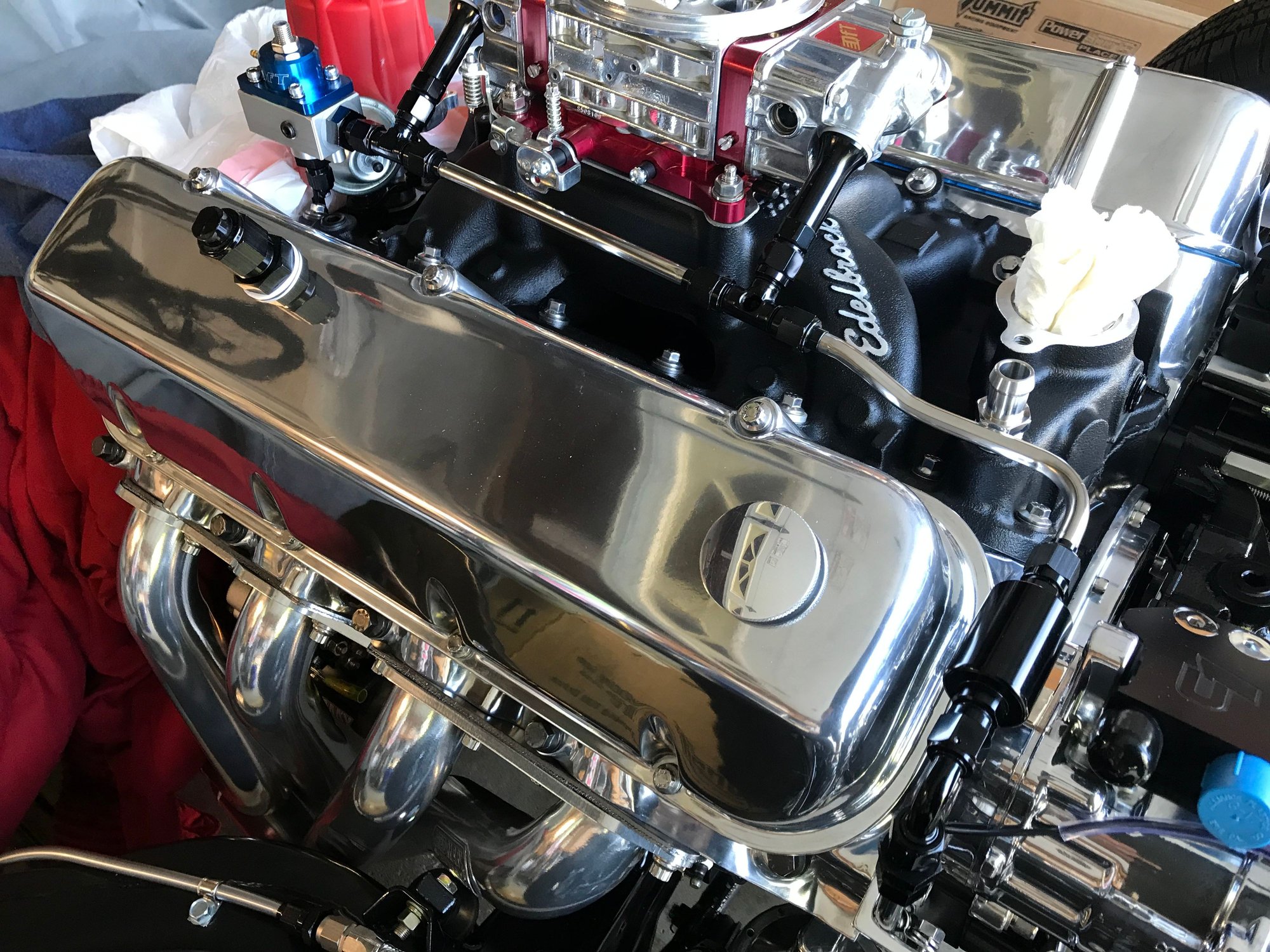

Having the regulator at the end of the fuel log like that ensures that fuel is circulated, to keep cool, and that the pressure at the carb is precisely metered. There should be a return line off of that regulator, perhaps it is not installed yet. Also, a regulator like that can receive a vacuum signal and adjust the pressure slightly, to give higher fuel pressure at WOT, for example. Buick 3800s (V6, EFI) have the regulator at the end of the fuel rail like that, too, with a vacuum signal.
Seems like the OP has a solution, and just needs a hardline connection to the carb. @lars has a whitepaper on fuel lines, with AN fittings and no rubber pieces, that end up looking just like @OldCarBum's excellent example.

Bikespace is correct about the placement of the pressure regulator.
He is also correct about using the correct push rod, especially with a new camshaft.
Using an incorrect material can eat up the rod or the camshaft.
He is also correct (don’t get a big head Bikespace) that I will be installing a return line to the bottom of the regulator.
