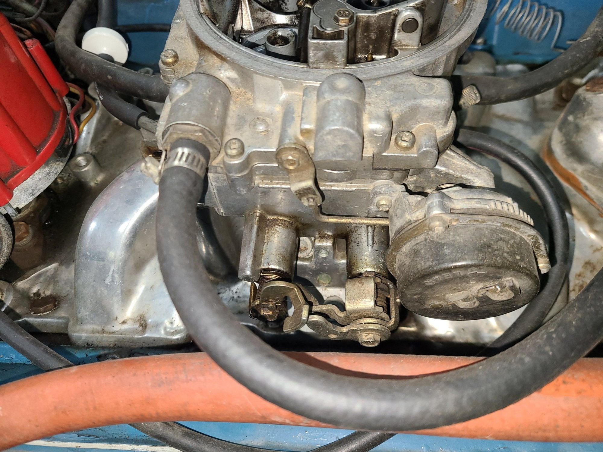

I have a weber carb on my 82 at the moment but I'm looking to replace it with a Quadrajet. I see a lot of Quadrajets close to me on FB Marketplace but don't know what to look for or what numbers I should look for. I'd like to find a rebuildable one and send it the the Quadrajet Guru Lars and get it rebuilt.
Edit: is there a guide somewhere that shows how to identify a Quadrajet?

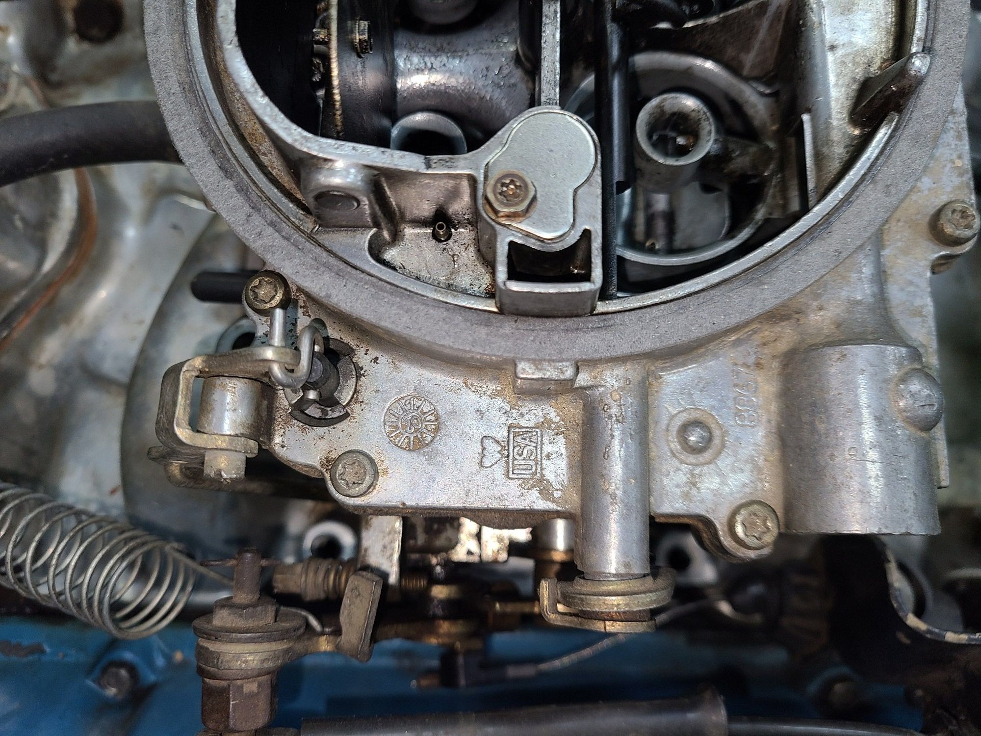

Do you have a picture of the Weber carburetor?
All Quadrajets have the part number on the driver's side of the main body towards the rear. Usually starts with a 7 or 17.

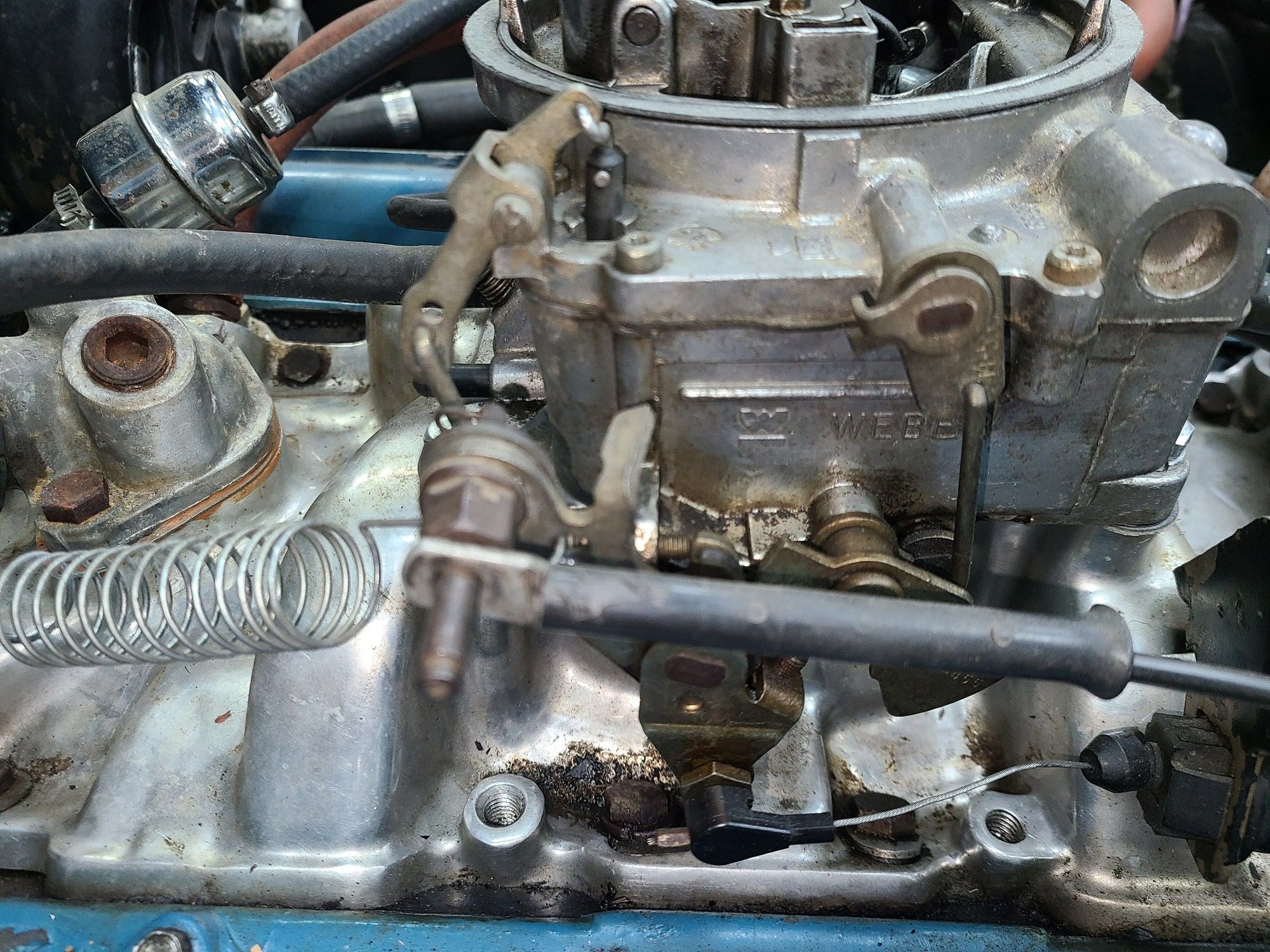

Originally Posted by jthornton
JT
If you do some research I believe you will find that is a Carter Competition Series carburetor even though you may see the name Weber on it. If you look around the edge of the base plate you may find a number.
You have to check the top of the intake manifold. If all 4 holes are the same size a Quadrajet will not fit.
JT
If you do some research I believe you will find that is a Carter Competition Series carburetor even though you see the name Weber on it. If you look around the edge of the base plate you may find a number.
An example.

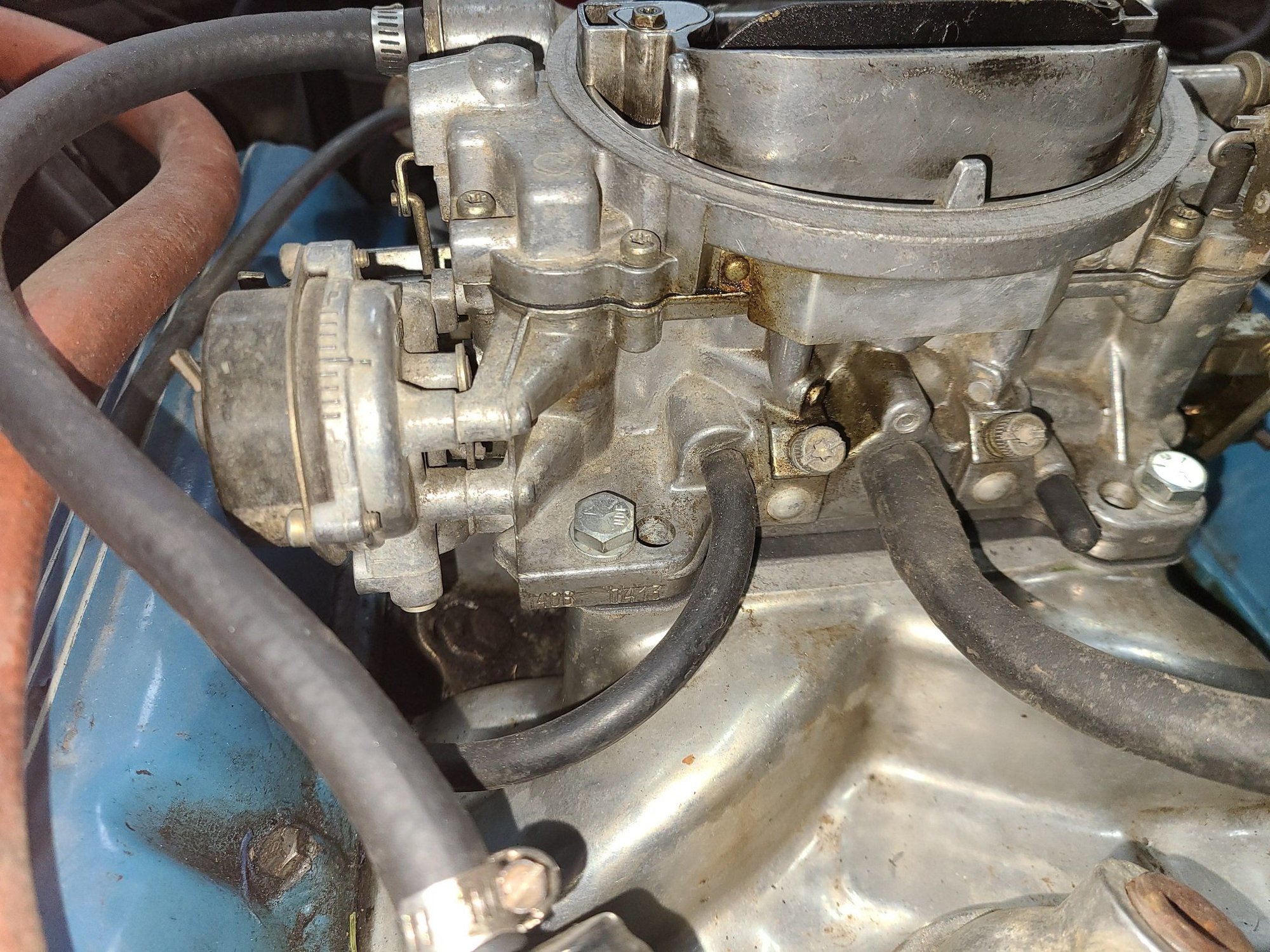

It’s hard to tell from the picture, does that intake manifold have a spread bore mounting pattern for a Quadrajet? If not you would need to change it to one that does.
A stock L83 is fairly close to an L48 from previous years. I would be looking for one of those so the jetting and overall setup is in the ballpark of what you want. A 1975-1980 M4M style carb can be outfitted with an electric choke, which would be my personal choice.

Thanks for the links, the only thing I know is the carburetor and manifold look like they came out of someone's junk pile, the electric choke does not work, I was told not to touch the accelerator when starting or the engine would flood and I've found gas puddled up on the manifold after driving it.
I did take the bolts out of the carburetor and peeked under it and it looks like a spread bore manifold, I'll have to disconnect everything so I can lift the carburetor up without tilting it or gas pours out.
I have no problem changing the manifold to a square bore to fit the Holley Street Warrior Model 4160 Carburetor, just need to know what is a good manifold that is low enough to have a normal air filter on the carburetor.

The first thing you have to do is look at the intake to determine what will correctly mount to it before thinking about Quadrajet versus the Holley you mentioned.

Do a search on Carter AFB tuning to find info. As stated up-thread, this Weber looks like the Carter design. (Carter had their own designs used on Corvettes in the mid-'60s as well as manufactured the Q-Jets later on in conjunction with Rochester.)
You should be able to tell just by looking from above and comparing the pair of forward bores with the size of the rear bores. A spread-bore will show a noticeable size difference between the pairs.
