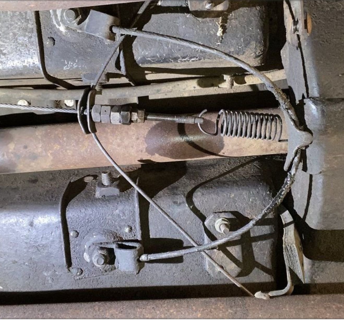

Have you disconnected the cable that runs between the rear inner seat brackets?
