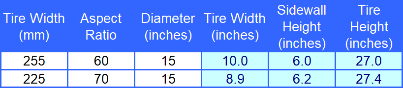

70 series or 60 series tires for my '69 BB?
I've run 255/60/15 tires for a long time, but I'm wondering if there is any real driving difference between them and a 225/70/15. The bigger 60's look very good, and may have a traction advantage, but, are there any differences when normal driving? I've heard that the 60's require more steering effort. True?

With power steering you should never notice any difference in steering effort. Without it you may notice a slight difference at very slow speeds (such as in parallel parking), but once moving the effort shouldn't be any different. In "spirited" driving the wider tire's larger contact patch may actually provide a little more feel and feedback than the 70 series, and obviously will provide more adhesion at the limits.
The original tire on a 69 Corvette (and all 68-72's) was an F70x15, which the modern equivalent of is a 215/70R15. In 73 when Chevrolet went to radials on the Corvette they switched to the slightly larger GR70x15 (225/70R15 today). From 1978 to 1982 all Corvettes came with 225/70R15 tires as standard equipment and 255/60R15's were offered as an option. To be in line with the Government's push to the metric system, in 1978 the tire makers switched from the earlier letter sizes to metric sizing.
Personally I think the slightly taller 225/70 and 255/60 look better on 68-72's because visually they fill the wheel opening better (but the taller tire will have a slight effect on the accuracy of your speedometer).

Gearing and speedo reading would change slightly due to tire height decrease, although I'm not sure if it would be noticable.
