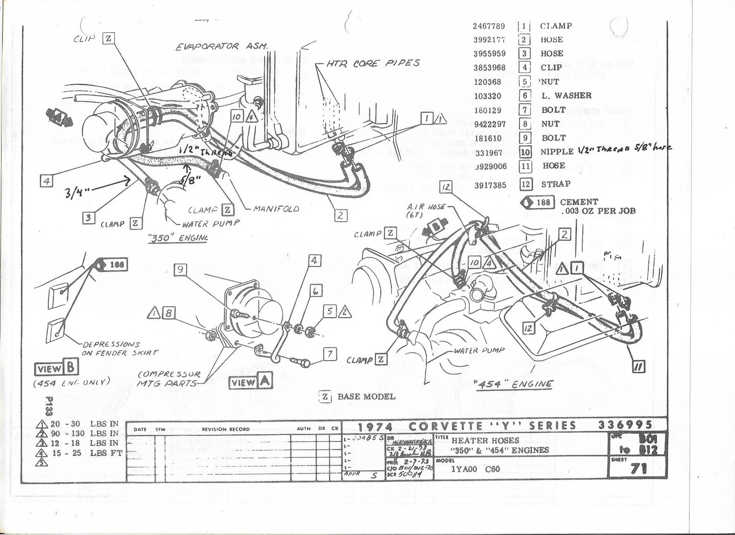

You will need a reducer because one hose is 5/8" and the other is 3/4"..
Connect the hoses as you normally would but put the reducer between the two hoses.
Put some anti-freeze in the engine.

the hose coming from the water pump is 2" and the one coming from the thermostat is 1 1/2"

I misunderstood your question, I thought you were asking about the heater hoses. not the radiator hoses.
