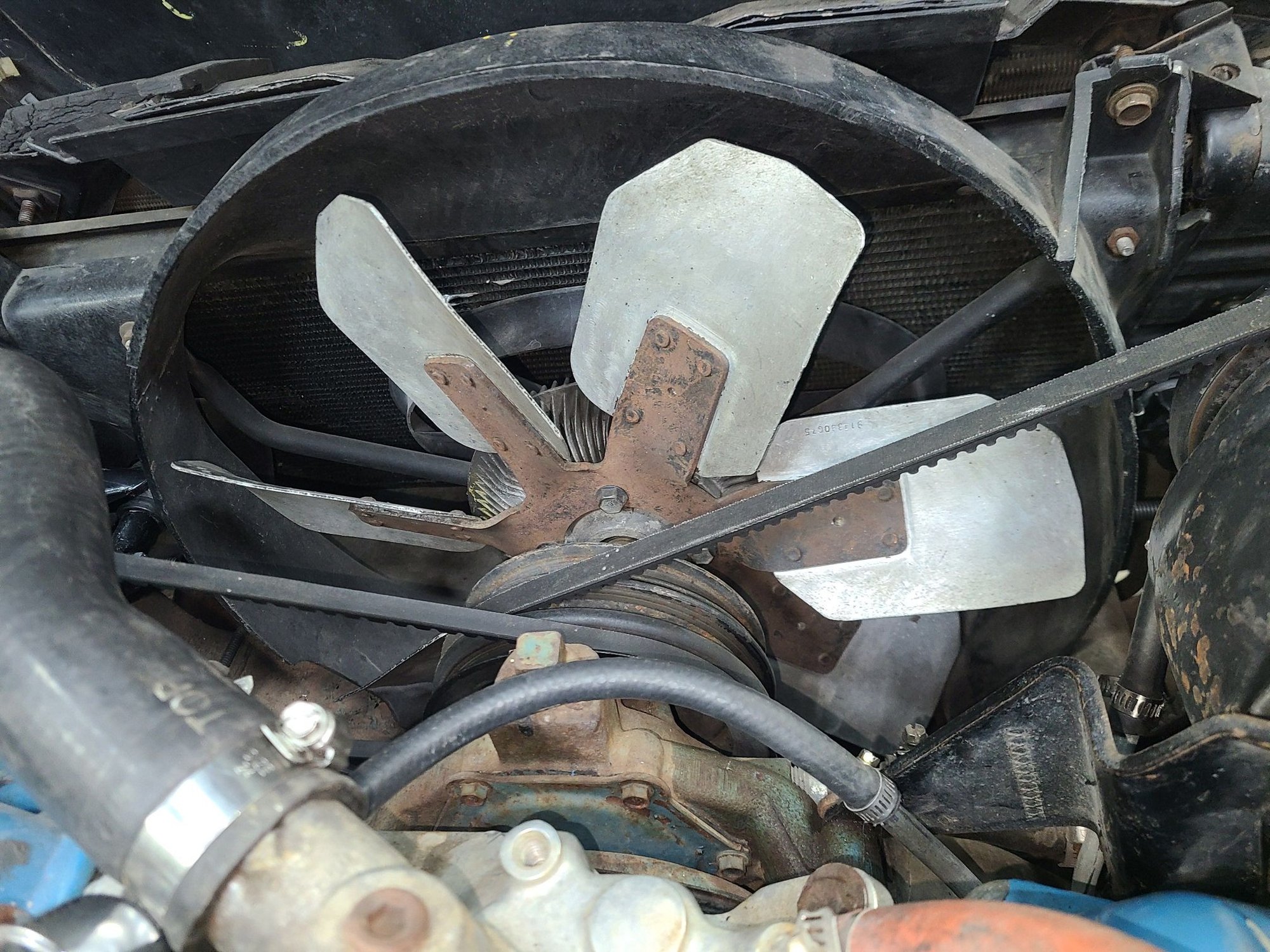

I just put my Holley carburetor on and started it up and noticed the fan was not turning so I shut it off. The fan blades are touching the bottom of the radiator shroud and have about 2" clearance on top. Would the motor mounts cause the motor to sit low?

You didn't mention the engine was leaning to one side. So what's the odds of both front mounts breaking at the same time?
If the tranny mount disintegrated, it would have the opposite effect. Fan would strike at the top.
You sure your shroud didn't move?

If the rubber pads under the radiator were defective or missing, that would drop the rad & shroud down farther away from the fan.
That's not your issue.
C3s shroud do not have some of best mounting hardware in the world. In fact, the bottom of the shroud is supposed to just lay inside the rad support.
And I repeat, "supposed to".
A couple upper bolts missing somewhere or a former mechanic could have installed the shroud incorrectly or chopped on it.
You need to get the front-end up on ramps and inspect the shroud from below. Make sure the bottom edge of the shroud is in fact placed deep inside the support and has not worked its way up & out = striking the fan blades. See if the shroud is movable.
Many shrouds have been hacked, butchered, modified and so on because of the difficulty of removal & installing them.

I took a quick look between chores this morning and the drivers side upper mount bolt for the shroud has a slot and the shroud is all the way up so I'll get it up in the air a bit and see what's wrong. I might have bumped it or moved it rebuilding the front suspension.
Bingo, you are correct both lower tabs are hanging in the air and the shroud is up too far... another Bubba fix in progress now.

Now that the fan shroud is actually installed correctly the fan is in the middle like it should. Big thanks to @HeadsU.P. for the clues.
