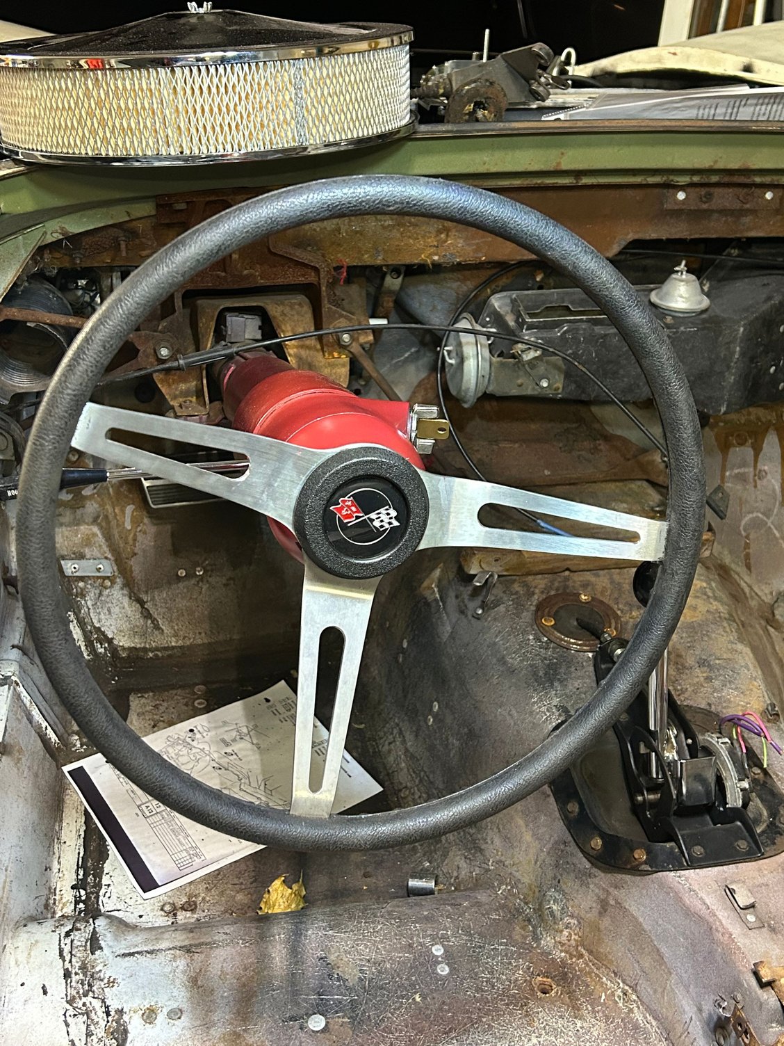

Working on a 69 base 350 auto with my 19 year old son. we have the drive train installed and new wiring harness installed. I wired in the neutral safety switch and the ignition switch. What else is needed just to crank the engine. We have new cables on the battery
and good grounds. There are no fuses in the block. what is needed to see if it cranks. Thanks.

The flex plate and torque converter spin properly. I’m thinking the starter ?

Replaced the ignition switch on the column and she cranked right over. Thank you for all your help.
