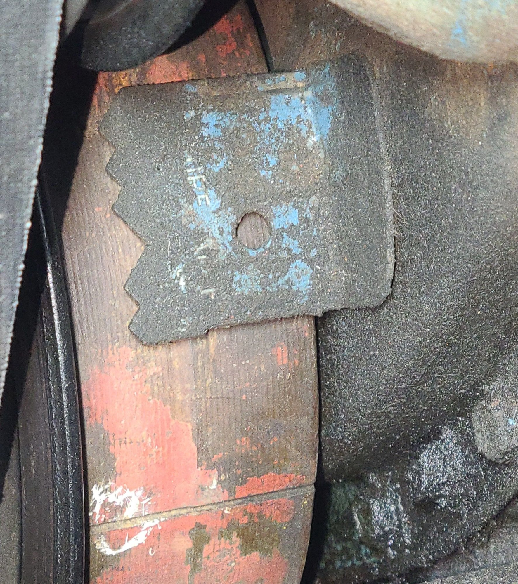

What is a good currently available timing light to get. I want to set my timing and need a new timing light as mine is from the 80's
Of course I can't read anything on the timing tab... maybe it will clean up a bit.

I have an Innova dial back timing light that I bought on eBay for $50 a few years ago. It looks like now Harbor Freight is selling a different one for $30.
All you’ll need on your timing tab is a mark at zero, which should be this larger indent here.

I wish we could encase that tab relic on a shelf somewhere, glass epoxy the exact state

In your pic, At the very top of your timing tab is about 10-12 BTDC…you can barely make out the “before” above “0” mark.
I aim for 8-10BTDC. Also, if you have an old one from 80’s it might be way better than my 2020 cheap version.

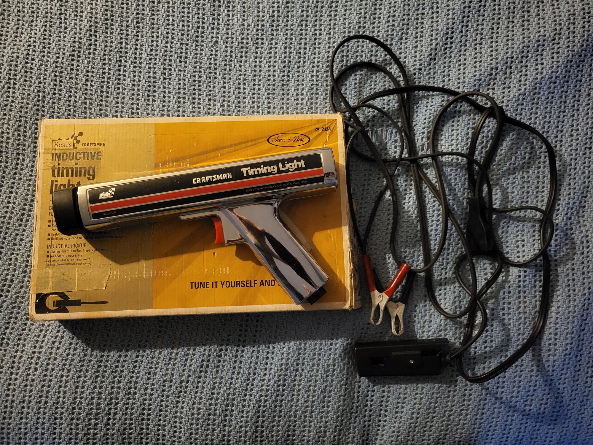

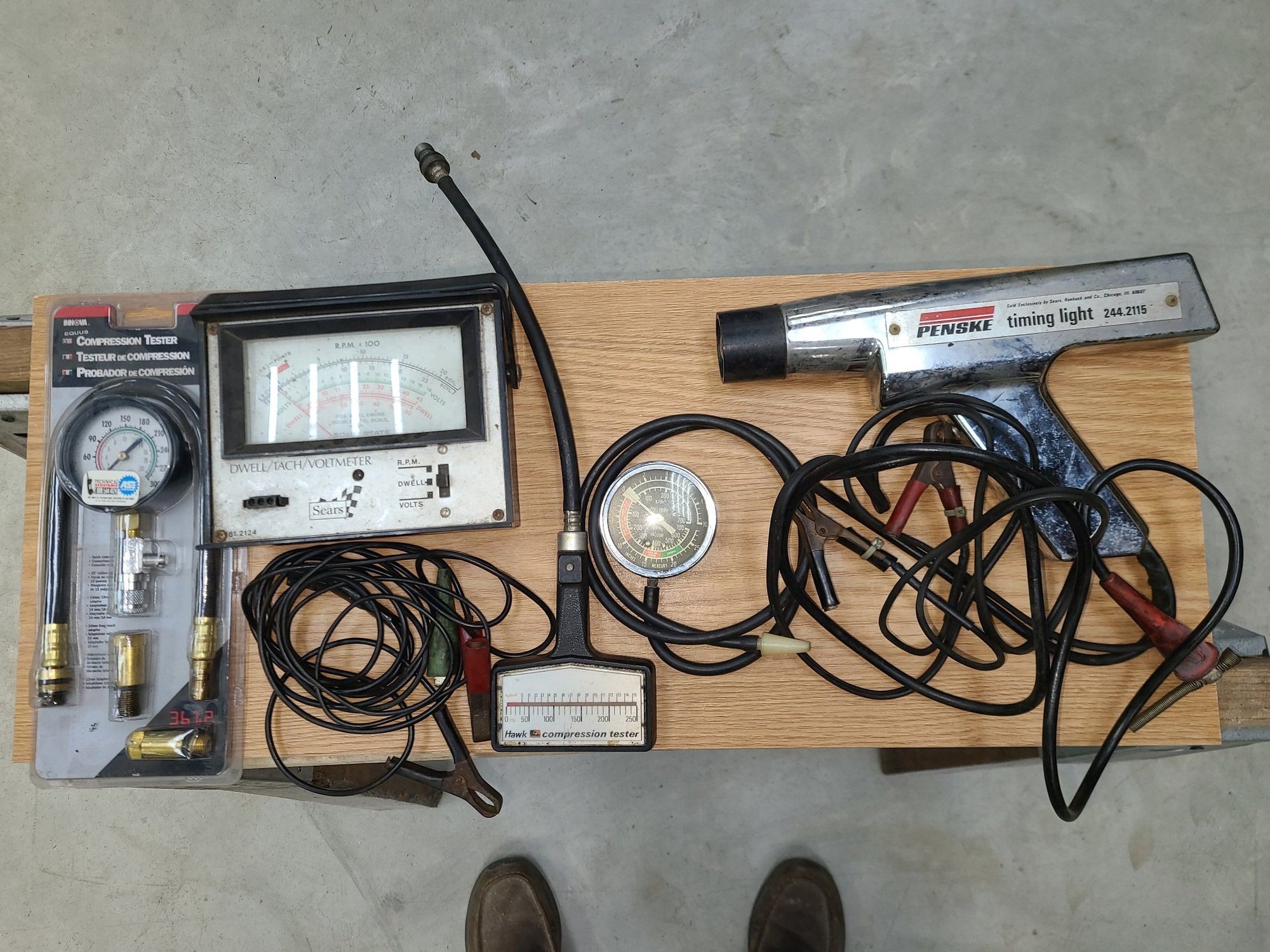

Here's my collection of diagnostic tools... looks like the newer compression tester is only 20 years old or so. I did clean off the timing tab and can read the numbers now so at least if the timing light still works I can set the idle timing once I get the ignition parts in.
JT

Originally Posted by jthornton
JT
I had the same Penske timing light. That timing light pre dates high energy ignition systems. Being all metal and non inductive, that light would shock me when using on a HEI. Good timing light though.

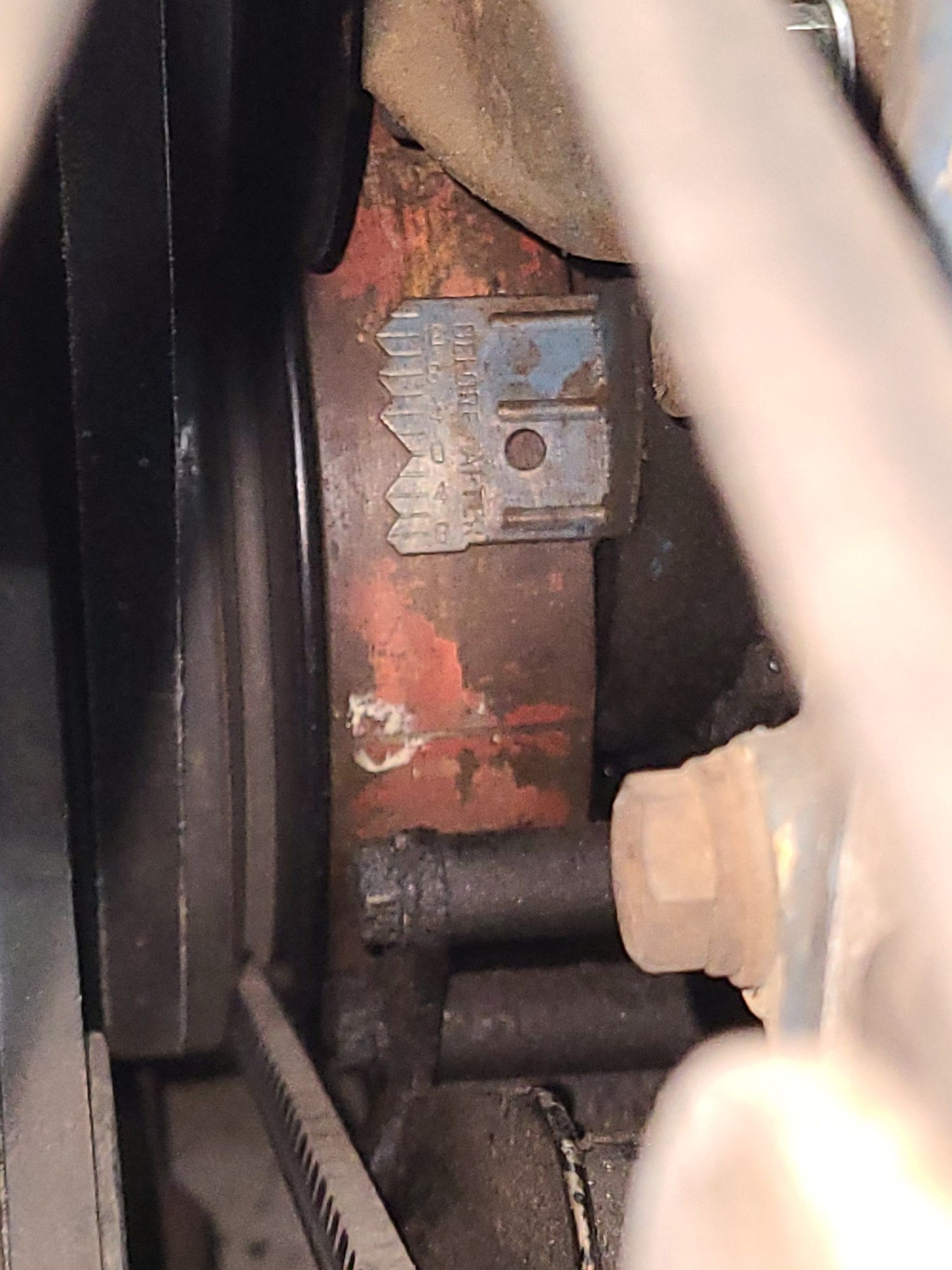

I did manage to get the timing tab cleaned off enough to read the numbers.
JT

Wow, I’m surprised it cleaned up that much. I thought it was rusted through all the lines and numbers. Good job on that.

Dont worry the inertia ring will slip and turn the tab into an agent of chaos. The tab could already be 1* off. Its part of the allure of owning one of those, of never not knowing not ever exactly what the timing truly is for sure ever... ahhaha
