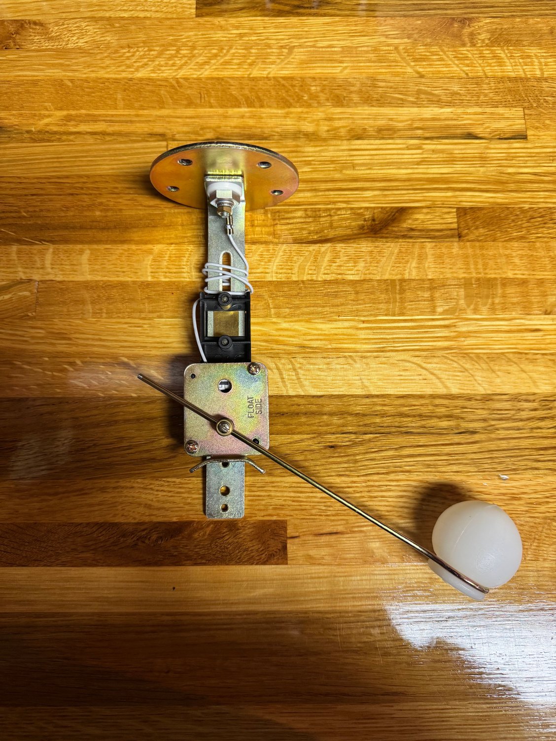

So, vent discussion aside, I adjusted the float rod on my new fuel sender and ran it through its paces with the Fluke meter. Same number of ohms at full sweep, but it seemed backwards at first because I forgot that the original float mounts from the bottom and the new float mounts from the top. I want to say it was 0-60 or 0-90 ohms. I forget now. 🤔
I also rotated the float rod by 90° so that it bisected the float ball instead of being at the bottom of it. I can’t decide if that gives me more or less margin at “E” - maybe neither. 🤔

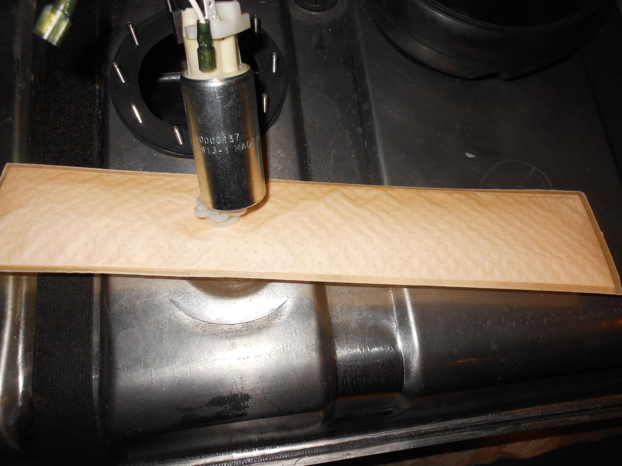

The Holley Hydra Mat is not cheap at all. The piece that came with my Holley Sniper's OEM Fuel Module would normally cost $220 by itself. It is a great product that really works well at sucking only fuel thru the hydra mat. It will pull fuel in with a absolute minimum of gasoline anywhere near the hydra-mat.
"Perfect for vehicles experiencing fuel starvation during hard cornering, acceleration, stopping, inclines, and low fuel conditions"
While installing the hydra mat, I placed it on the floor of the tank near the rear. From here it never had any issues with sloshing around and stalling the engine due to low fuel pressure. Using the gas tank fill opening I was able to reach an arm into the tank and push the hydra mat where I believed it would be most valuable and work the best for me.
If I did have any air being sucked in then I would likely buy a bigger piece of Hydra Mat and that would likely solve that issue. It is a shame that Holley charges so bloomin much for the Hydra mat! I suspect more and more racers will be using this material just because it really works. If I put a BIG Holley sticker on my car maybe they will give me a better price for a chunk of hydra mat. I would use it in every car I own because it does make a difference!

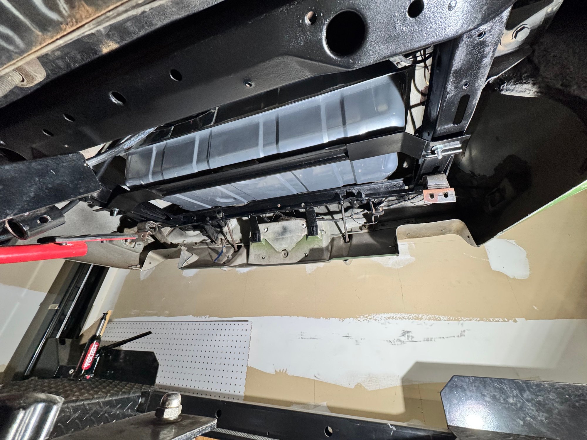

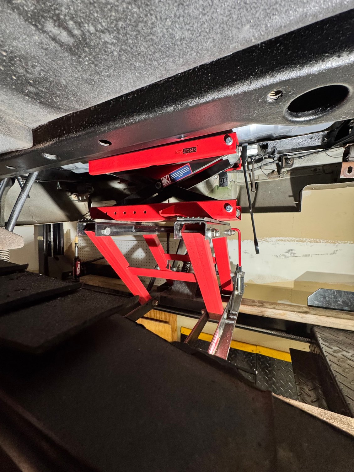

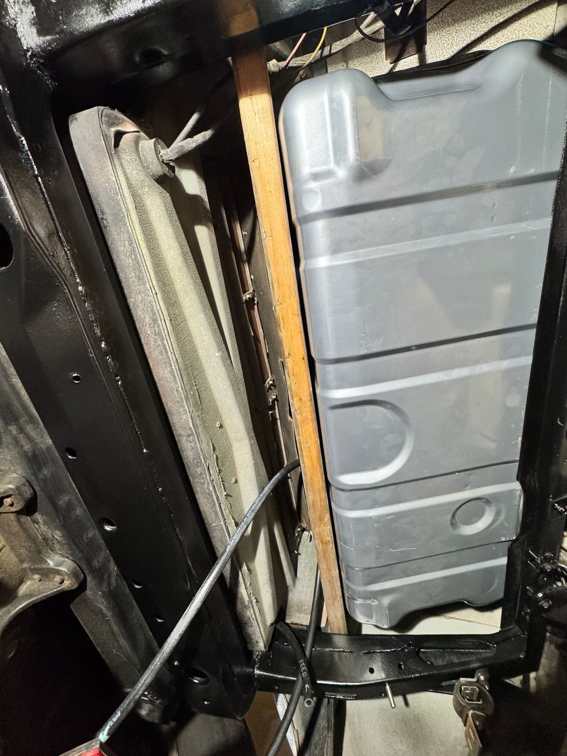

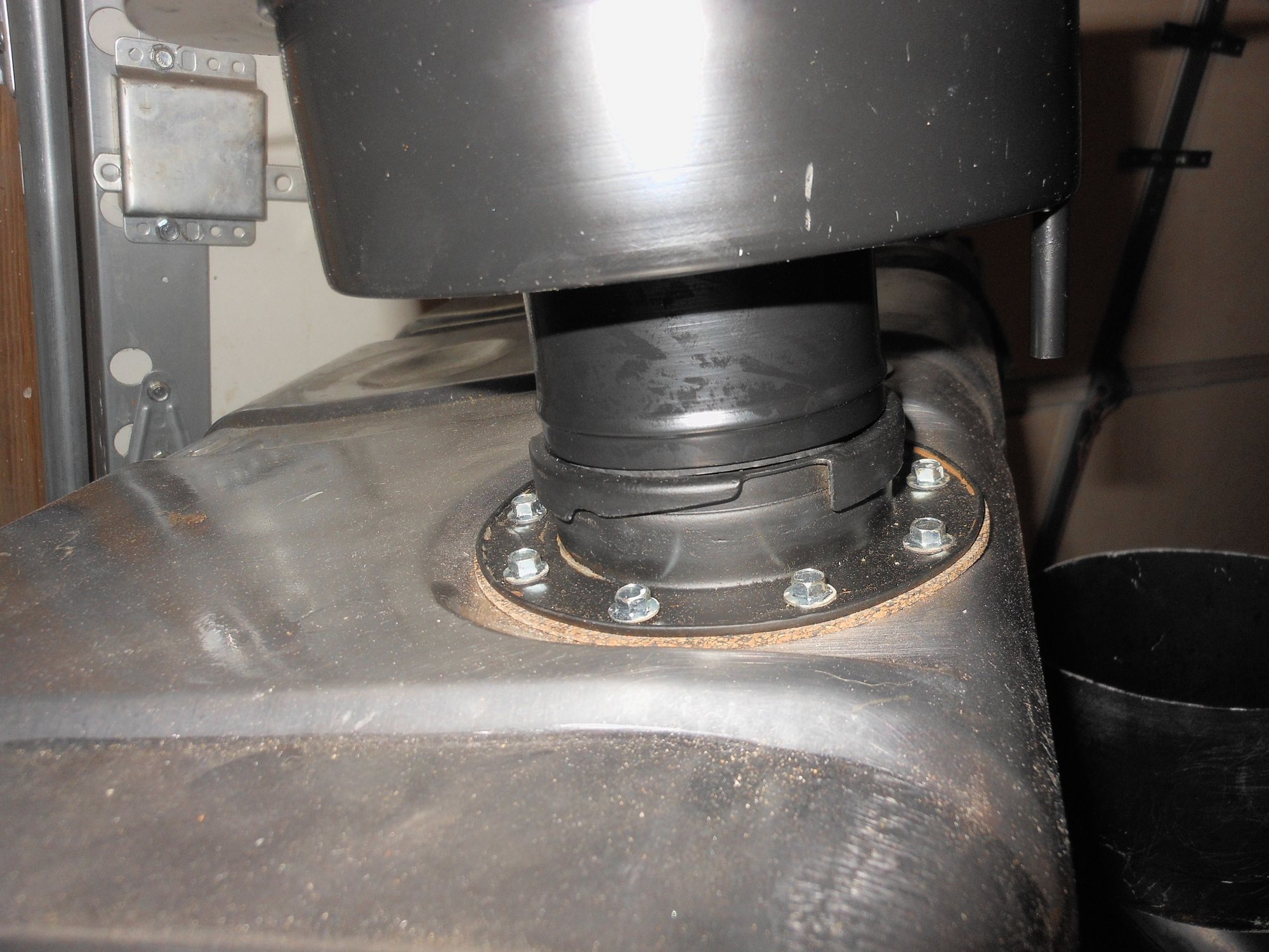

Did some test fitting of the tank over the weekend. Wrestling it into place by myself was a little bit of a challenge, so I used a combination of lifts to get it into place and a 2x4 to support it while installing the bottom brace. The new straps are a real pain in the butt, but I’ll get them sorted soon enough.

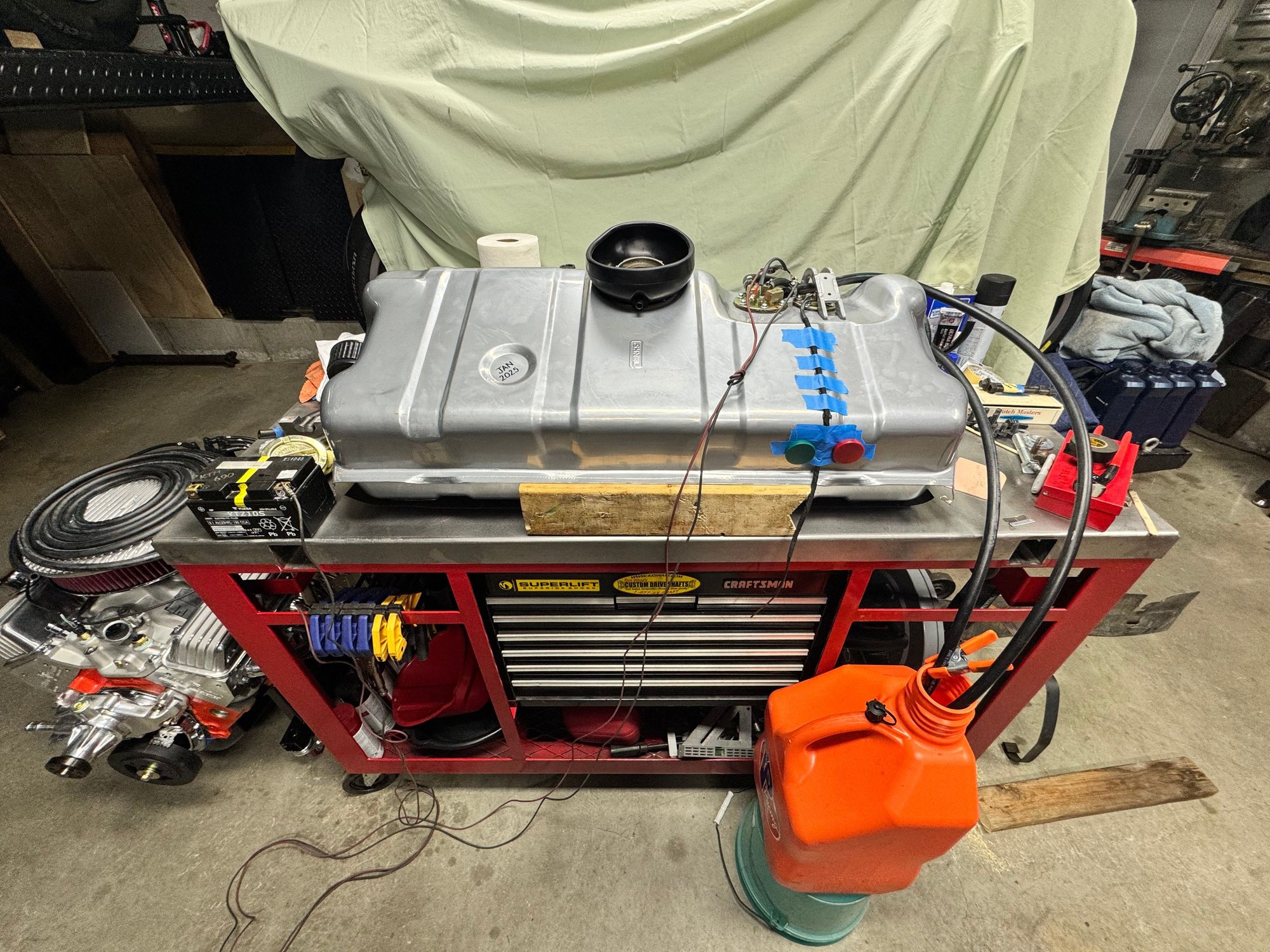

Back out of the car and on the bench, I put a few gallons of gas in the tank and then tested the fuel pump.

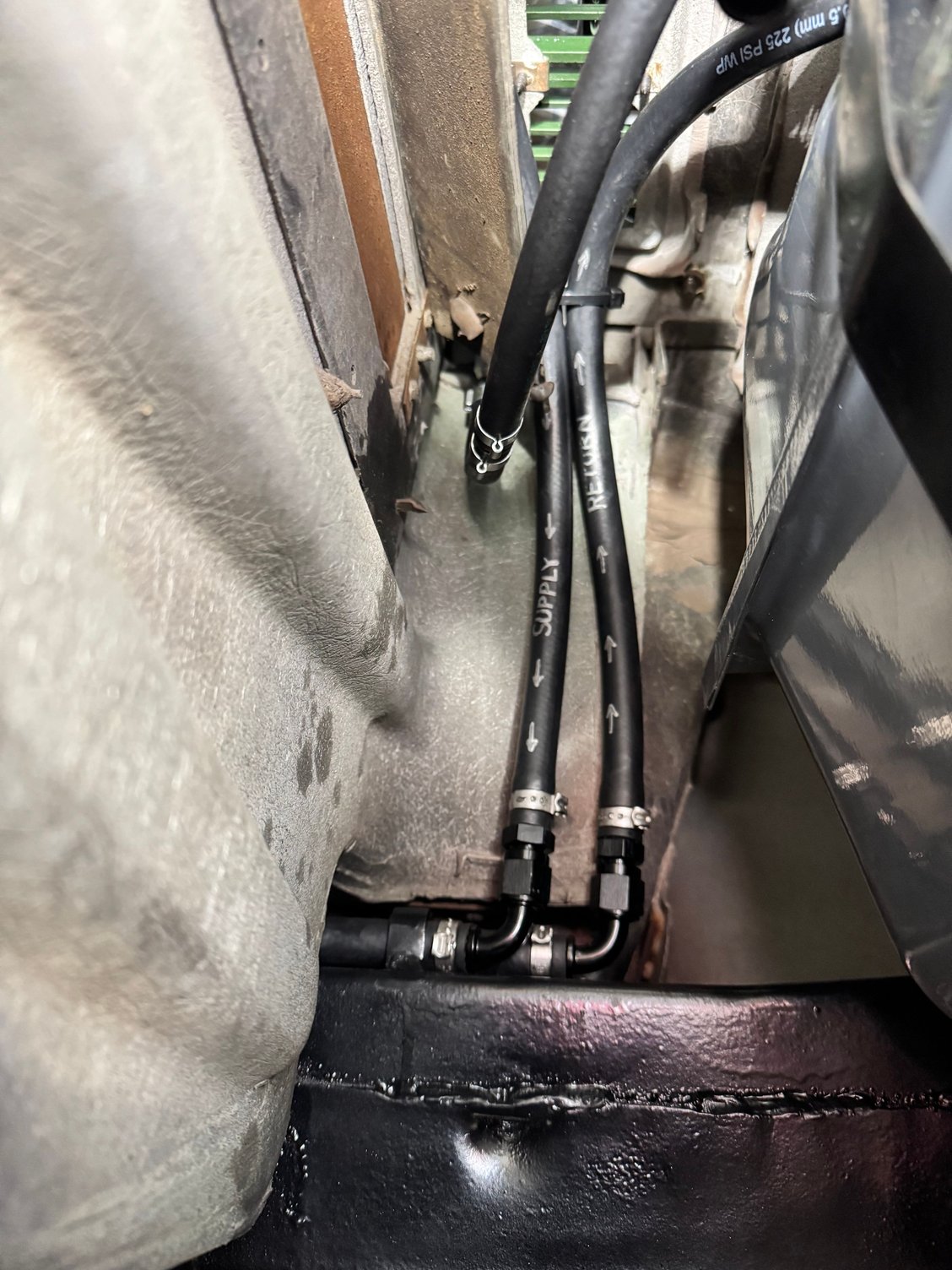

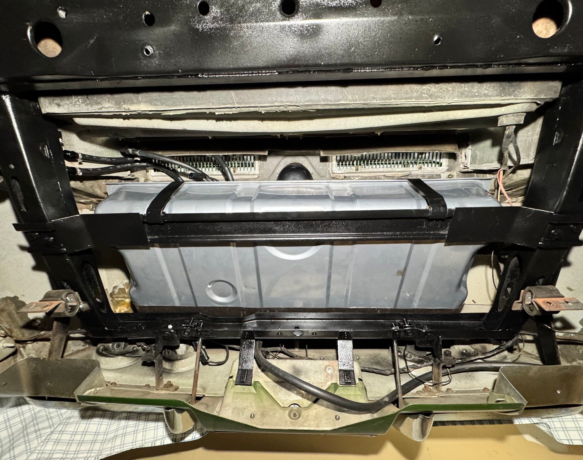

Got the tank permanently mounted tonight. I spent way too long wrestling with the aftermarket tank straps before I went back to the originals. A little clean up and some fresh paint and they were good as new. The new plastic shield on the back side of the tank was a bit of a challenge, but I got it done.
I ran Earl’s Vapor Guard EFI hose and AN style connectors.
After I tightened everything down, I lowered the car on the lift so that I could check the gas cap alignment against the access door. I was off by half an inch, so I went back and loosened everything all over again to make adjustments. I’d recommend checking BEFORE you tighten the straps. 😜
