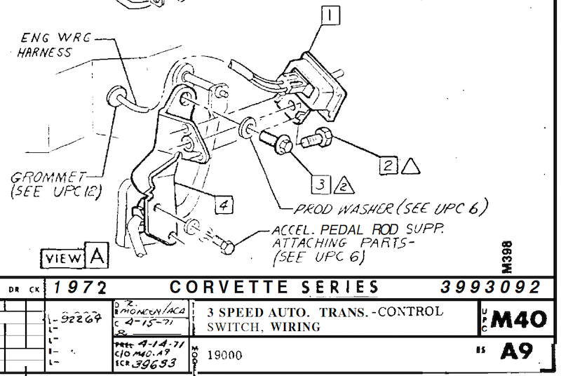

Hey Folks,
I have seen many posts regarding this subject, but none match my situation. I noticed a while back that I didn't have a kickdown with my automatic transmission. There is a wire going to the solenoid on the transmission and I found a two-pronged plug just hanging loose under the dash, one wire pink and one wire orange. Most instances I have found had an orange and brown wire. Could this be the intended connection to the switch?
A secondary question: is there a way to access the switch without removing the dashboard?
Thanks!

The TH400 switch sits on top of the accelerator pedal linkage on the driver's side of the firewall. It's waaay up there. The wires should be in a dedicated connector and come through the firewall in the tach cable grommet. I don't recall the wire colors, plus I'm color blind so some shades of red/pink/purple/green/teal/orange are a crap shoot for me to ID correctly.
It is adjustable for proper operation, so after it's installed, it needs to be "zeroed" to full pedal depression.
You don't need to remove any part of the dash to access it, but removing the seat will help keep your back unkinked.
The switch is #1 in this AIM diagram:

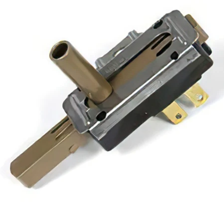

I found a bracket and a switch. Question about the wiring orientation as I am not certain, can't find any references, and the car didn't have a switch to begin with: which spade connection does the tranny wire and ignition wire go to on the switch? I would think that the tranny wire would go to the spade that corresponds to the location the switch travels to when at WOT.
Old Feb 8, 2025 | 07:10 PM
barkingrats's Avatar
barkingrats
1967 Pedal Car Champion
Joined: Mar 2020
Posts: 9,137
Likes: 4,248
From: US-PNW
I don't think it matters if the connector will go on in either orientation. Switches that do require a specific wire orientation have keyways or shapes that only allow one way to connect. This switch has just the two bare terminals so either orientation is fine – when engaged the switch just connects both wires together.
