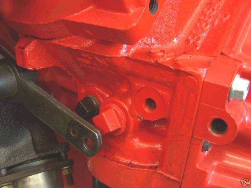

1) It's possible but not probable that the engine sat on a rack for 3 months before being chosen for an installation. The majority of engines are cast and then assembled 1 to 4 weeks prior to the car assembly.
2) Look on the side of the block above the oil filter for 2 threaded and plugged bolt holes. (black and orange in this pic by J.Hinckley - the threaded hole above and right of the orange plug is for the clutch pivot) If present, it may indicate a 4-bolt mains, solid lifter block which the 435hp came with; if no plugs then it's a 2-bolt, hydraulic lifter block (L36/L68 if original to Corvette). The L-68 is an L-36 block with a changed intake - there is no difference in the assemblage of the block or heads.

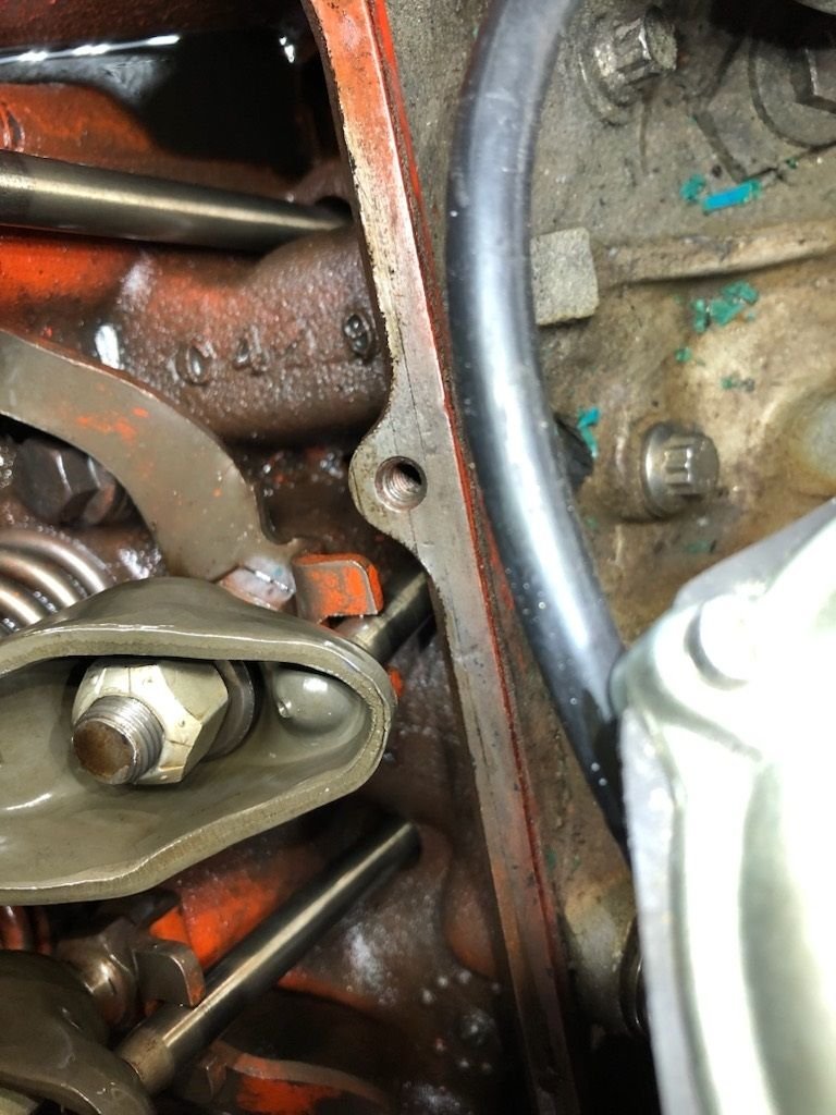

I'm back, with a little more information, and a lot more confusion. The owner sent me some photos, and rather than clear things up, they have only confused me even more thoroughly than I was before. He said he couldn't get a photo of the casting number, but thought it looked like 8963512. I'm guessing he misread the first digit, and it's really 3963512, which would make it a 1969 block.
The block date code looks to me like A118 followed by a space and then a 9.  If Im reading it correctly then the block was cast January 11, 1968.  I dont know what the 9 means.  Is that the year, and I am misreading the beginning of the date code?
The block date code looks to me like A118 followed by a space and then a 9. If I'm reading it correctly then the block was cast January 11, 1968. I don't know what the 9 means. Is that the year, and I am misreading the beginning of the date code?

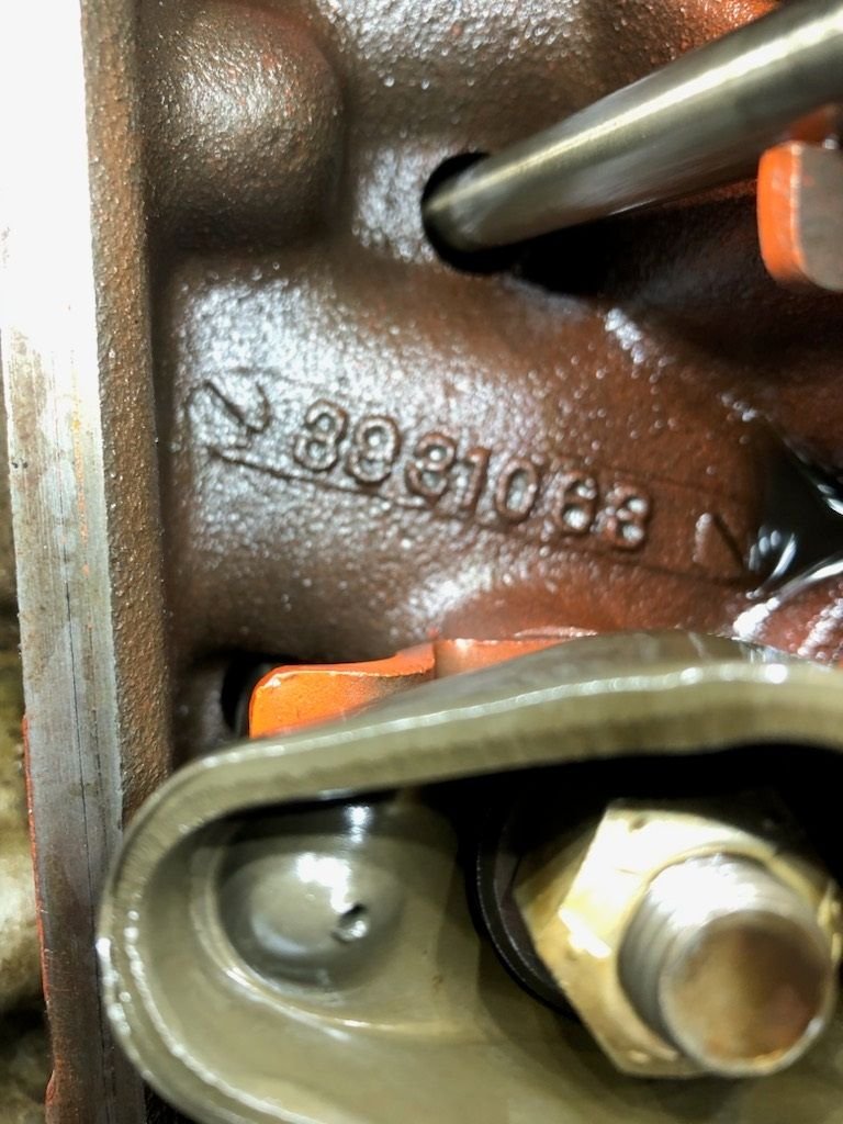

The head casting number looks like 3931063, which should be a 1969 L36 or L68, so that would match with the block casting number.
There is also what looks like a C4 and a 9 separated by a large space.  Is this the date code?
In another location there is a PA followed by two digits that I cant make out.  Both of them could be 3 or 8.  Finally, there is a circle of 11 dots with a dial pointing to the seventh dot.  I cant find anything about what the PA code or the dots mean.
In another location there is a PA followed by two digits that I can't make out. Both of them could be 3 or 8. Finally, there is a circle of 11 dots with a dial pointing to the seventh dot. I can't find anything about what the PA code or the dots mean.

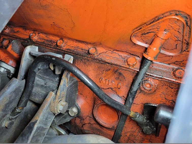

Also, he sent me this photo of this mysterious information located on the block near the oil filter.  Can anyone shed some light on it?
Based on the block casting number and the head number, it seems like the engine is out of a '69, but if I'm reading the block date code correctly that would be highly improbable. Maybe what I think is an 8 is really nothing, and the 9 is the year? If that's the case then it seems like everything might match and someone swapped out the original engine for one from a '69. If anyone can help unconfuse me, I'd sure appreciate it.

  1. The casting date for the block, I believe, is Jan. 11, 1969 and for the head it's March 4, 1969 (screw between the 4 and nine). Could the gap in the block casting date be a screw head?
  2. What you are seeing with PAxx is merely an abbreviation of "Passenger" as opposed to "Truck", nothing more.
  3. The 11 dots and pointer is the clock indicating what shift was working when it was cast.
  4. I don't recall if the K on the side of the block indicates which casting pattern was used... but that may be what it is. If so, different blocks will have different letters just by the luck of the draw of which patterns were used when pouring the hundreds of blocks per day(edit below). I know the pattern sometimes appears on the top of the rear flange where the casting number is located. (Casting info locations changed over time.)
What the dates mean is that the parts had to have been cast a week or more prior to the car's VIN (birthday) which doesn't seem to be the case, being the car is a '68.
edit: reworded so as not to imply a single pattern produced all blocks on a given day
