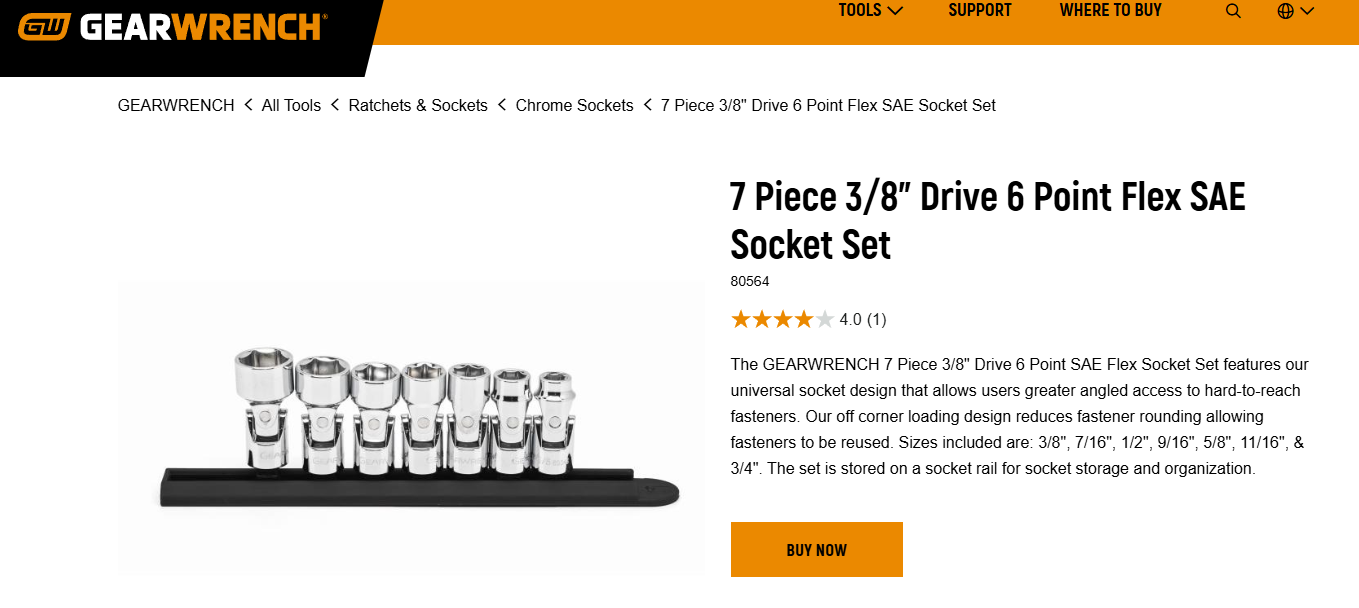

It's been about 5 years since I did my clutch. But I'm thinking both upper bolts, swivel socket on a long extension. Not a swivel and a socket. But a actual snap-on swivel socket.
I'm really certain it wasn't a drama at all. Removing or installing.
this is what i did.. but budget swivel
there ya go! For a guy at home who seldom uses his tools. This could be an answer, of course, as long as it doesn't break when you need it!
