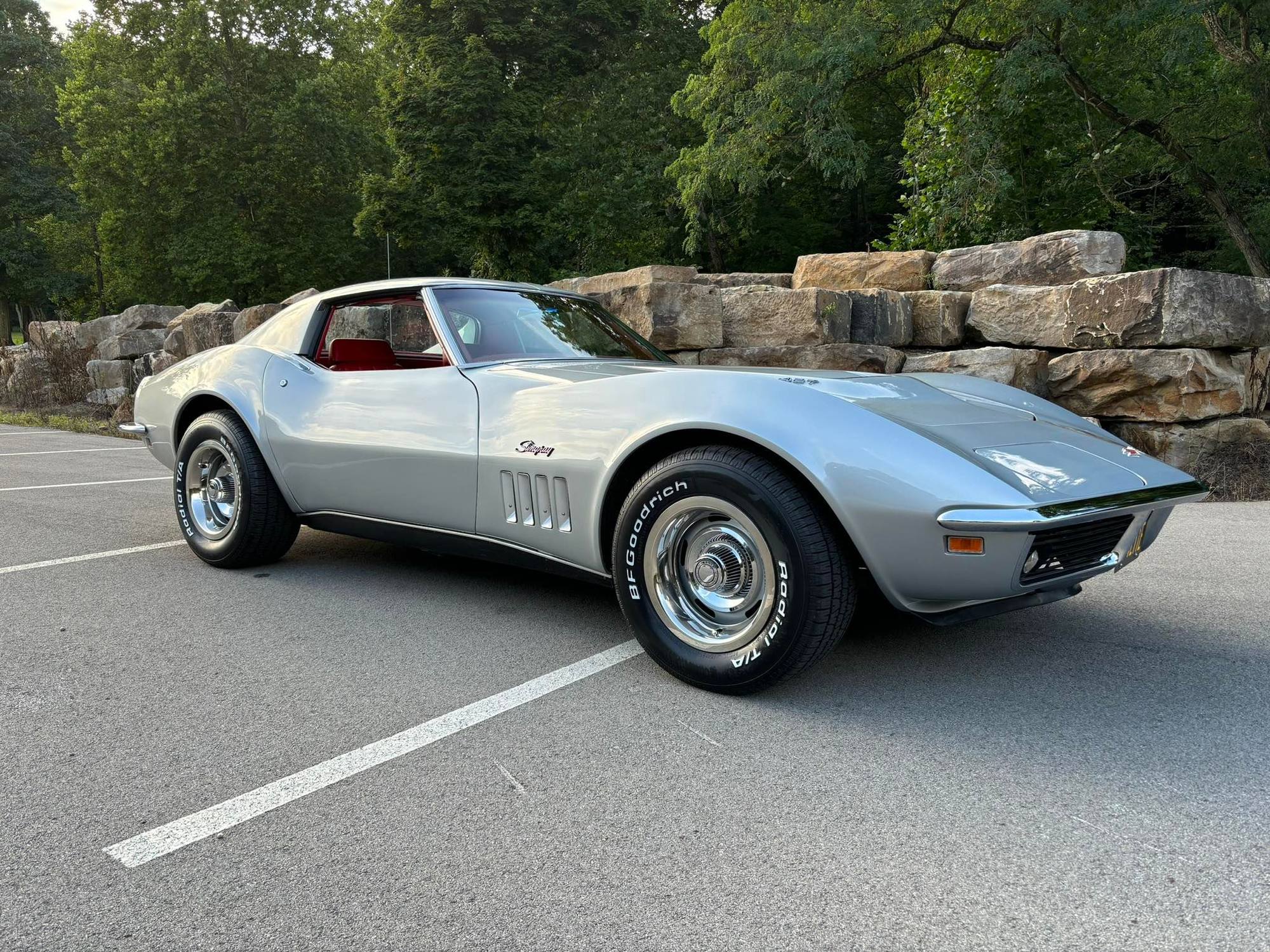

Hello all. Last year I bought a 1969 Corvette 427/390hp. The car has 52k miles on it but it was restored several years ago that included a motor rebuild. I have spent the last year trying to fix the sins of the previous owner. My friend owns a speed shop and he has been doing most of the work.
My problem is that the motor chokes and stumbles when accelerating somewhere over 4000 rpm. It will not smoothly accelerate. We have cleaned the fuel lines and replaced the fuel pump, installed the correct rebuilt quadrajet carb, replaced the intake manifold, installed an electronic ignition module, new plug wires, smoke tested the vacuum system, compression test, and a multitude of other checks...but it still chokes.
The only abnormality we can find is that if the plugs are pulled immediately after a test run the #1 plug (drivers side front cylinder) is a little darker than the other plugs. We are out of ideas.
Any thoughts??
