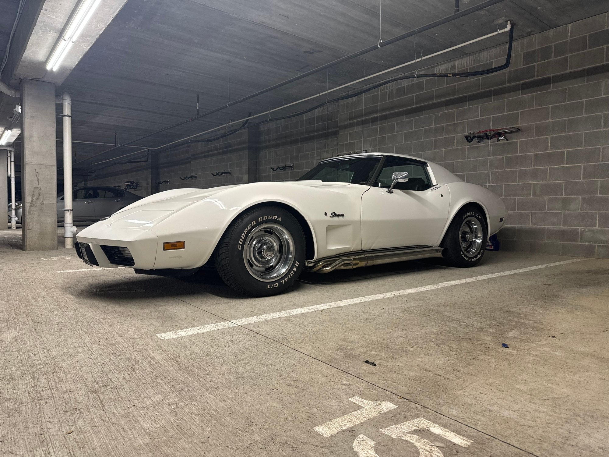

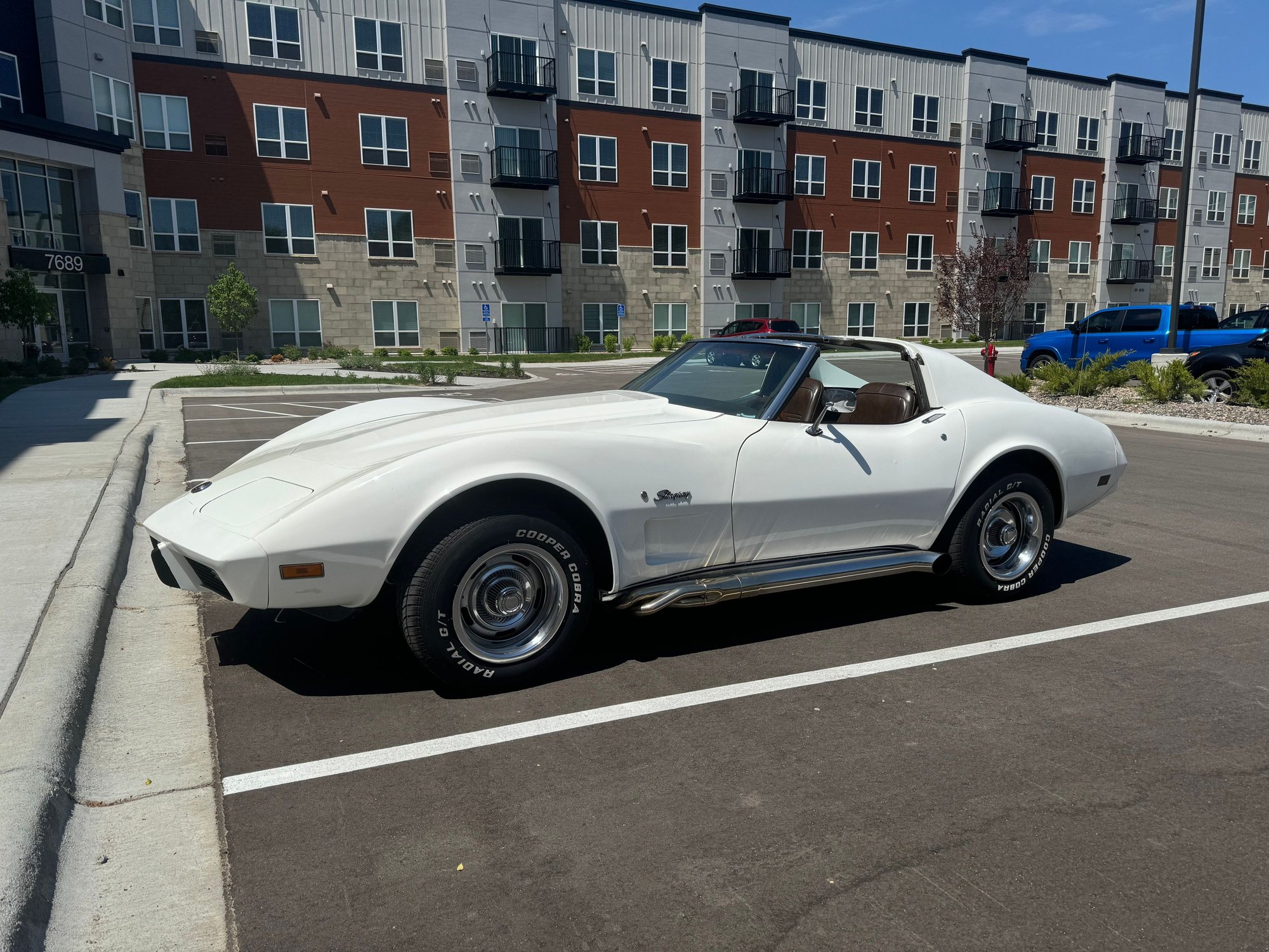

Looking back at my camera roll it appears I started in mid May, and was done by mid June.
Keep in mind though I did a full front and rear coilover conversion, only worked on weekends, spent a bit of time waiting on parts, took a vacation, and got rained out a couple of times. Not to mention the beer breaks too.
Basically, I have no idea.
I understand the sentiment of the 15” wheels though. It’s really hard to beat the look. If it’s any consolation some people report that the car rides smoother with them because of more sidewall.
