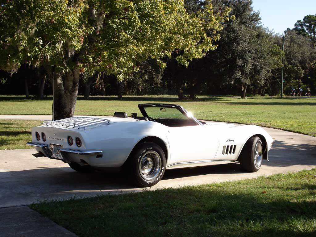

The Corvette? She's a 1969 350/350. Nothing special, a driver versus a show car.
Top down, favorite view.
