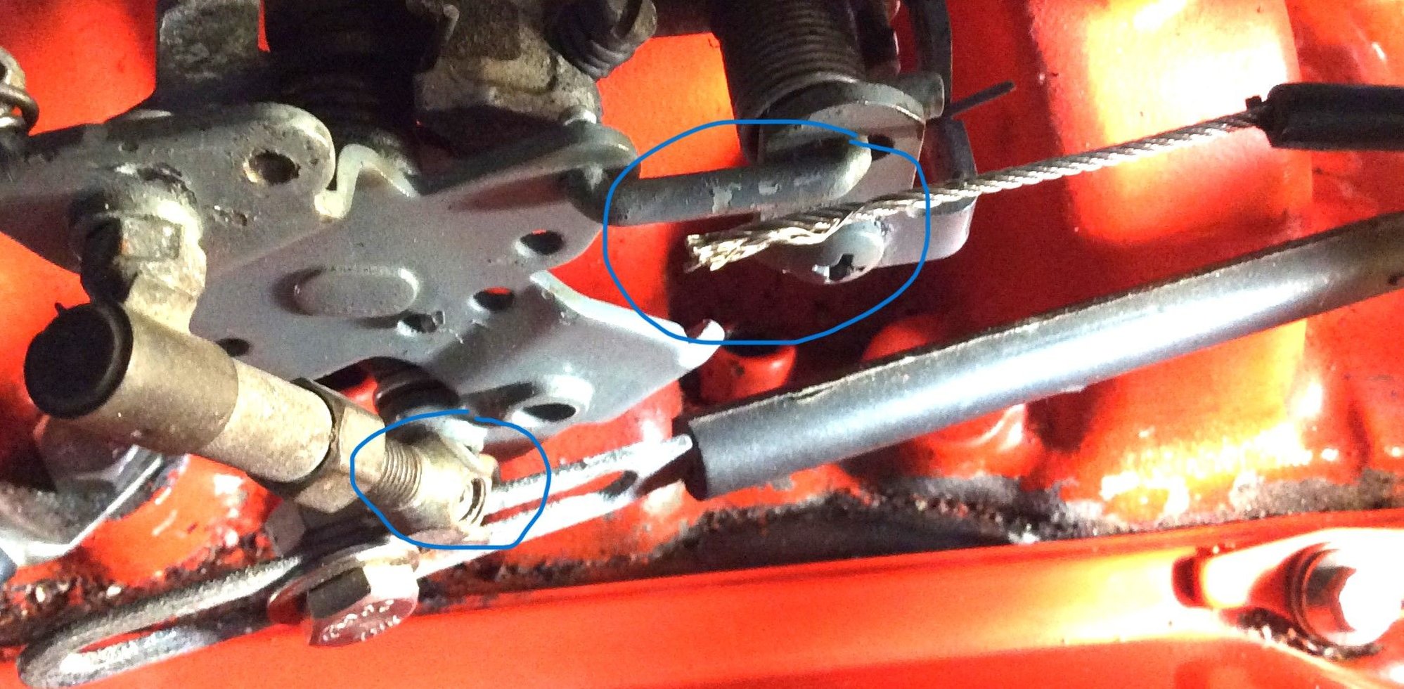

Ok, you had to fabricate a bracket for the OE style cable to work correctly. The old stock bracket did not work with the sniper? Can you send a picture?
Here's what happened to my current cable. The steel shredded and released from the connector. I think it's a Lokar. Scary ****!

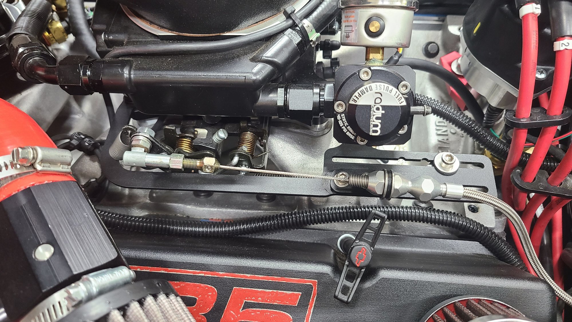

The positioning of the "Holley" Sniper throttle bracket is very similar to the positioning of any Holley Carburetor. If I recall, my stock L-48 with the stock Q-Jet throttle cable arrangement had to be manipulated to get it to work with the first Holley carb that I put on it in 1990 something...
Typically most users that migrate to a Holley carburetor, then to a Holley Sniper, don't have to do much with the throttle cable configuration. However, some adjustment may be necessary to ensure you have the correct alignment and proper travel - without over travel. Severed / pulled apart relatively new (such as a Lokar cable) are usually signs of an improper cable travel setup.
There are numerous kits out there for Holley throttle brackets. Some have adjustable brackets, or even multiple bracket types for different configurations. I like some of these because it allows some flexibility on bracket placement / angle as well as spring attachment flexibility.
Here's an example:
I used the Lokar cable (which pivots and allows length adjustment) and an aftermarket throttle mounting bracket. I used the bracket that went best with the Lokar fitting and I also used a lower bracket to adjust spring angle and tension. I also added an additional spring on the forward side of the throttle bracket so it would pull forward aiding the other spring returning the Sniper to the 0% TPS consistently.

I have the Lokar cable setup as well with over 10,000 miles on it. Make sure your WOT tension isn't too tight. It's not good on the throttle input shaft and your cable can severe (or pull free) if you have too much tension in your setup.
