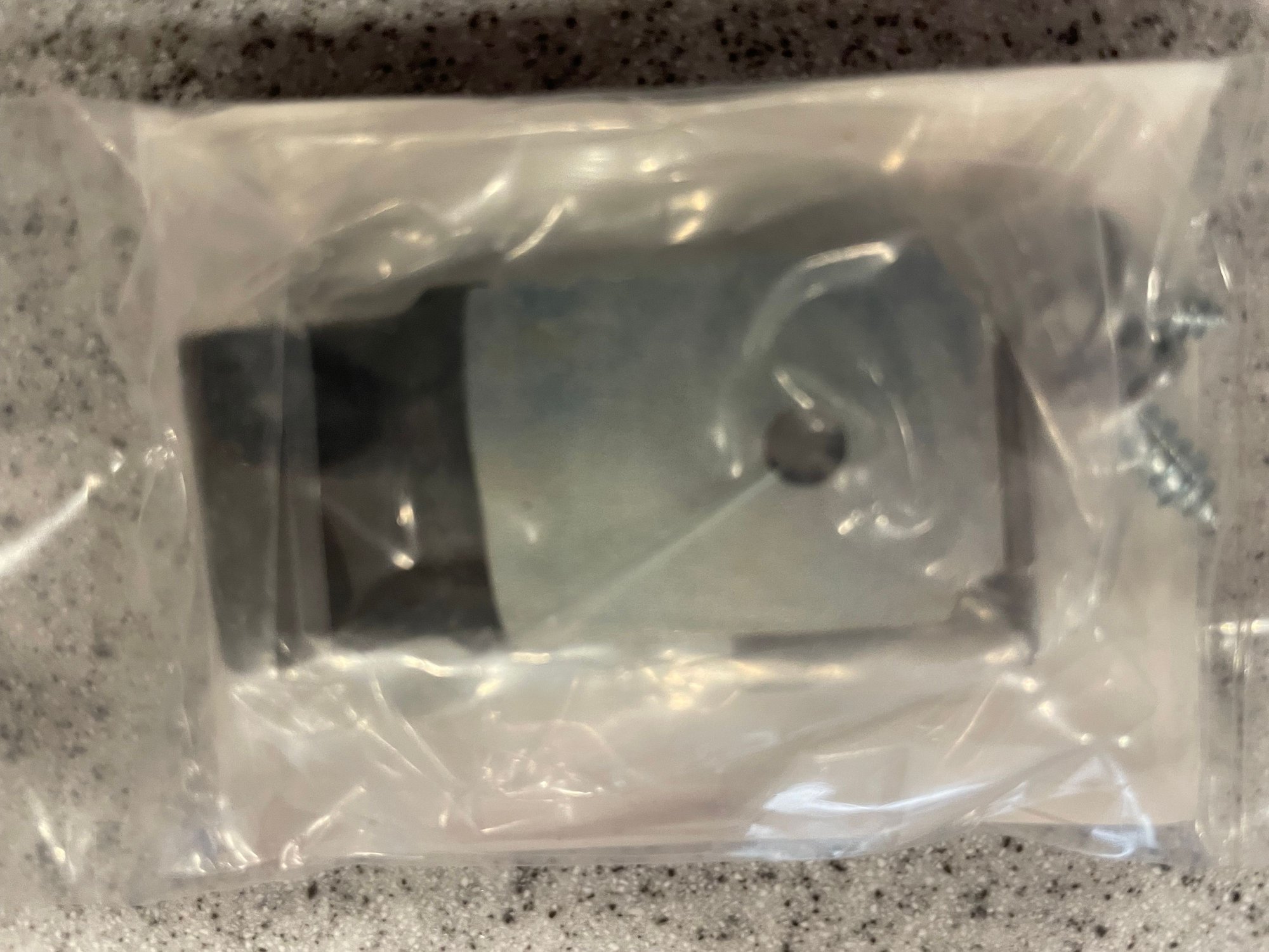

Default Alternative Parts
These are the parts I found, I believe, on eBay and though they don't match perfectly and aren't for a 'Vette, I'm going to modify the size if necessary and use them on mine. Hope this helps.

That helps a lot. Pretty good chance that Chevy used parts across different models.

Amazon's got them for $15.75.

Bought them...
