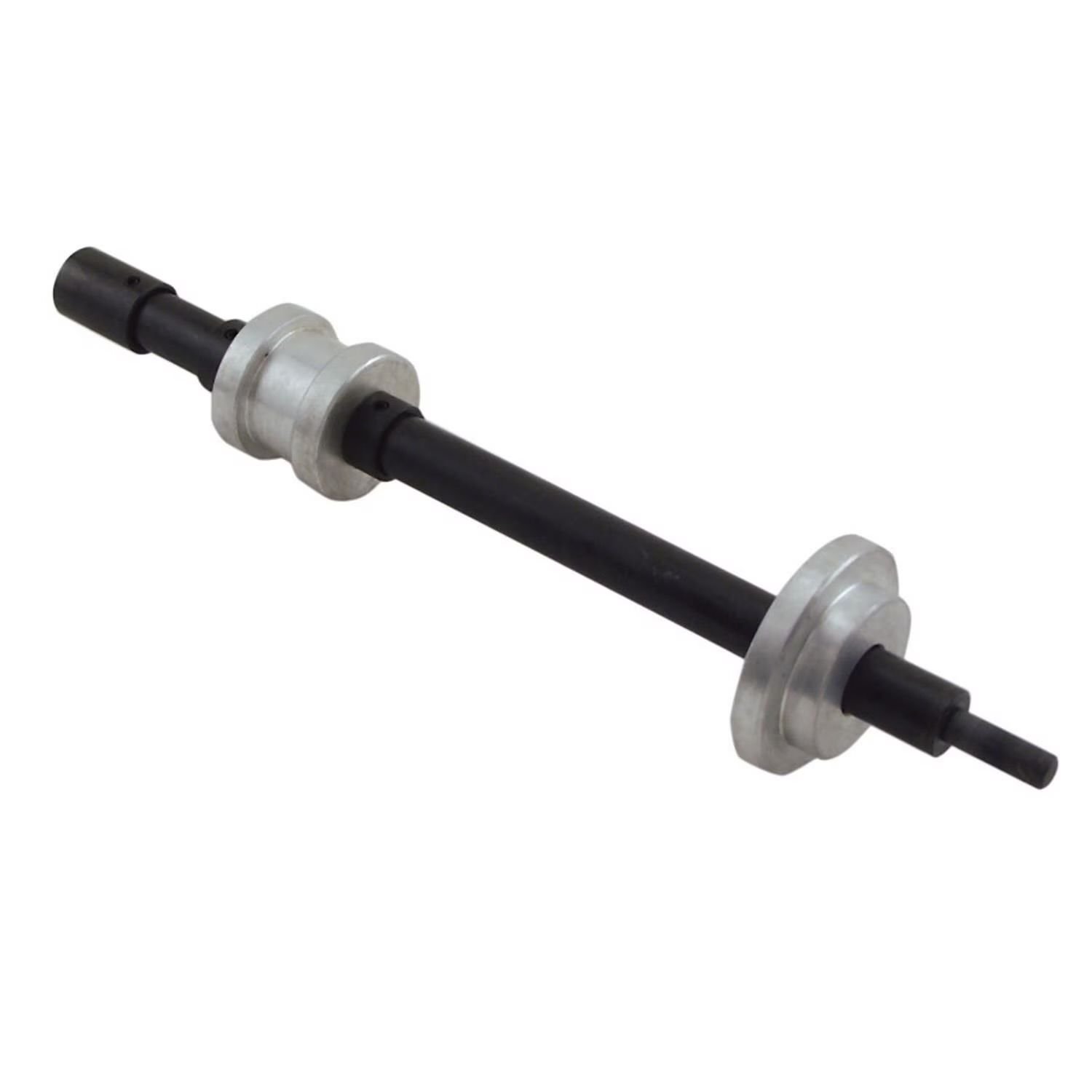

Or are you talking about the kind of Priming tool that fits down into the oil pump's drive slot and lets you spin the oil filter therefore pre-lubing the engine. I use a Pre-lube tool that drives my oil pump after I have pulled the distributor, spark plugs and valve covers. This tool needs a strong drill so use a corded drill and not a battery powered one for the job. I pump the oil until I see it running down the rocker arms and then rotate the engine and then run the drill again ensuring that everything that needs oil got covered. This way is easy to do but many folks are afraid of pulling their distributor to do this work.
Do you have any part numbers from Jeg's? All I saw were stand alone 2 gallon tanks with hoses to attach. The drill type lubing tool is cheap in comparison and does the job very nicely.

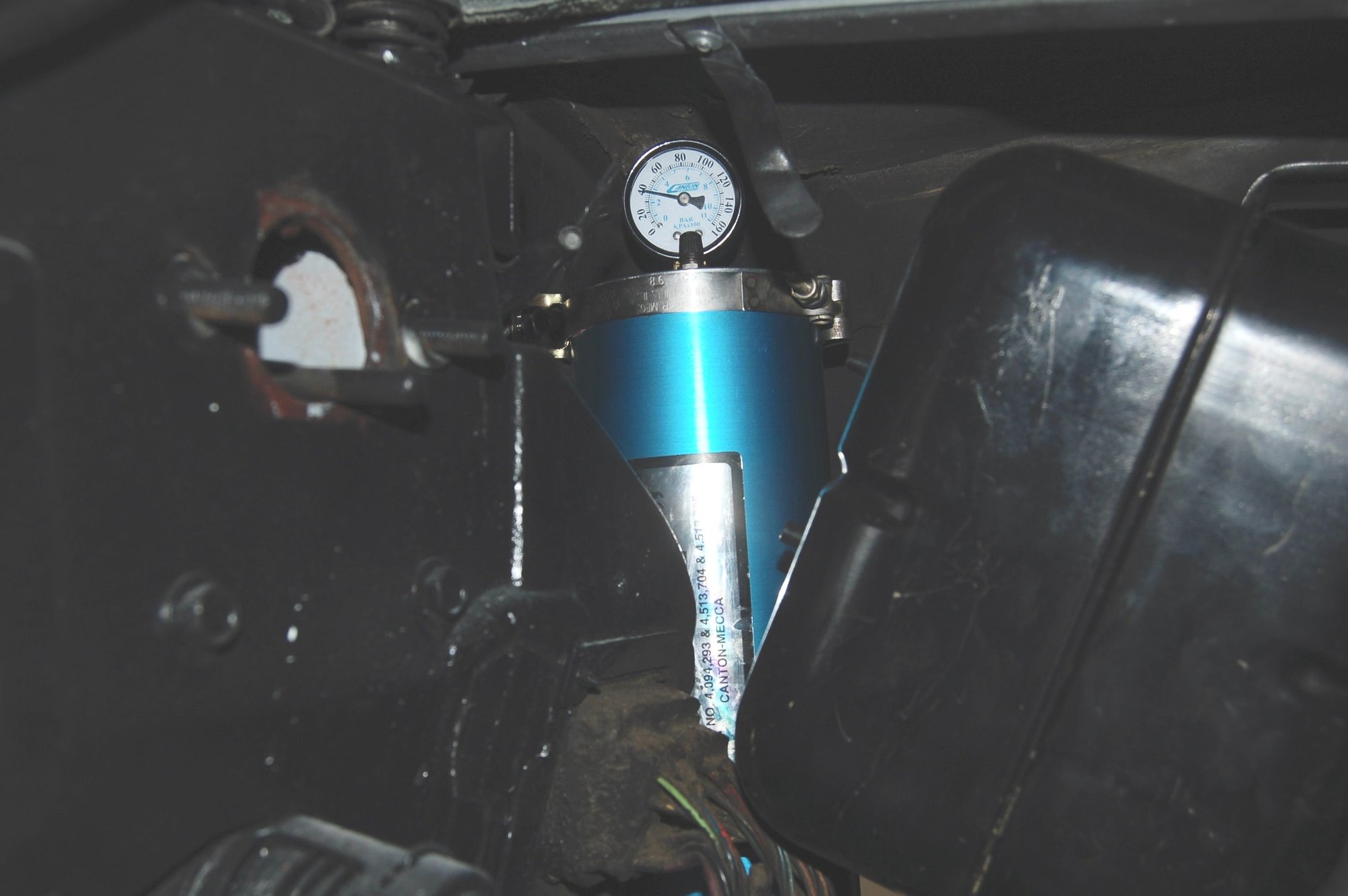

I think you are talking about the Accusump? You can connect to prelube a motor everytime you start up and as well fill in any low spots. I had a problem with that on hard deceleration.
Great idea, the downside is finding a space to mount it. I managed to put it next to the vacuum tank on the driver's side.

Most part stores have a distributor style oil pump drive tool you can rent. You pay a deposit then get it back when you return the tool. Much cheaper than spending money on a tool you only use once a year.

The tool that drives the oil pump using a drill is a great tool to have around. I like the idea of letting loose the extra oil before cranking on an engine that has sat for several months. I could not remember the Accusump (made by Canton Racing) name but that concept really impresses me. Thank you ignatz for helping me get the right name, I really appreciate your help!
Having an Accusump, the engine has extra oil available for protection when you are accelerating hard or cornering like a crazy man. It also protect the engine from wear while cranking because you can release the oil before starting to cover the parts in a layer of oil.
These systems are going to be close to $500 from taking a quick look at their website. Here is the link to an Accusump Accumulator:

If you are "comfortable" with removing and re-installing your distributor then I would use the electric drill adapter that drives the actual oil pump inside the engine. The Peterson product actually has it's own little oil pump for pre-lubricating the engine. I think it is better to spin the actual oil pump versus using a small auxiliary pump when pre-lubing the engine.
