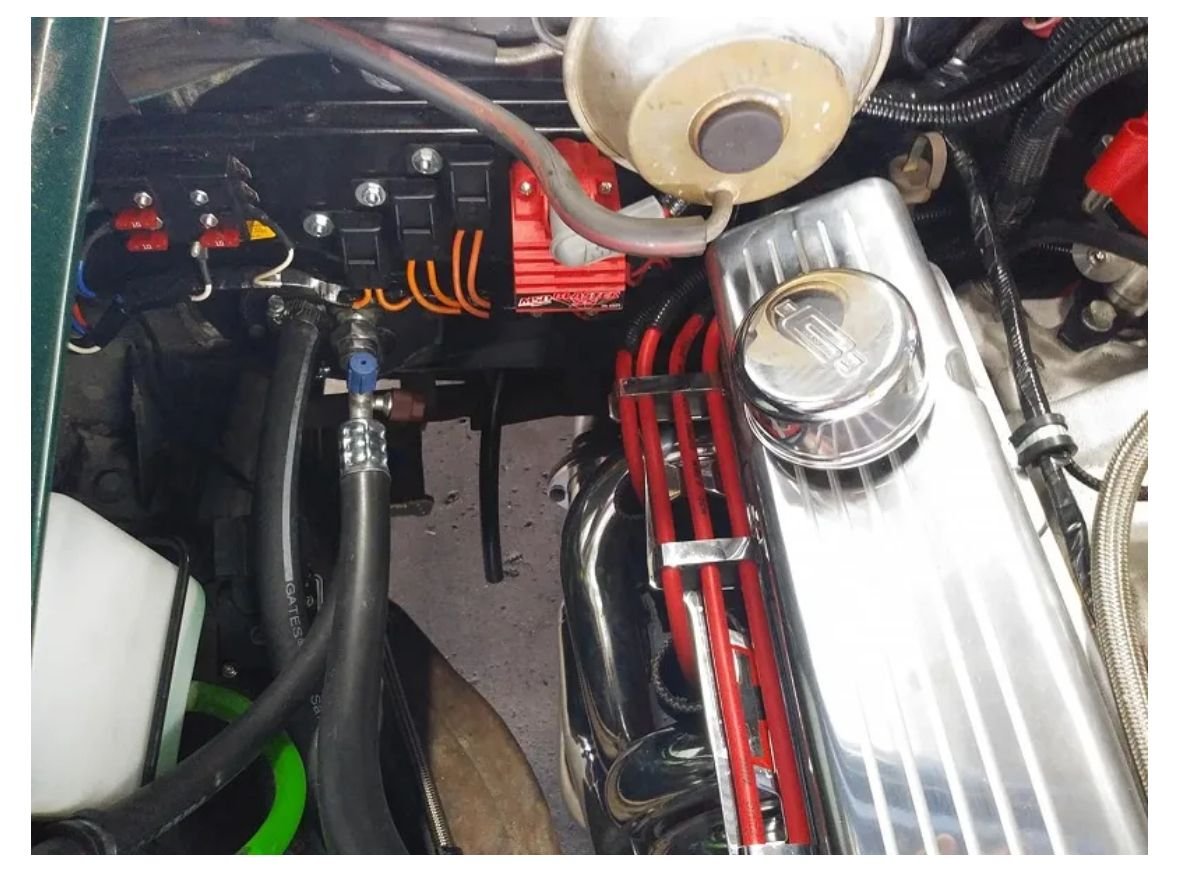

If you remove all the HVAC or change over to Vintage Air it adds a lot of room in the engine bay where the evaporator box used to be. On the other Corvette forum there’s a user named Autowiz that does a lot of aftermarket EFI installs and custom wiring. He builds an electrical center in this spot which looks very clean in my opinion.
There’s still a little room in this area even with the evaporator box. Some people find room in the nose of the car or behind the dash to mount the ECM.

That looks like a good spot my only worry would be the heat from the side pipes potentially.
