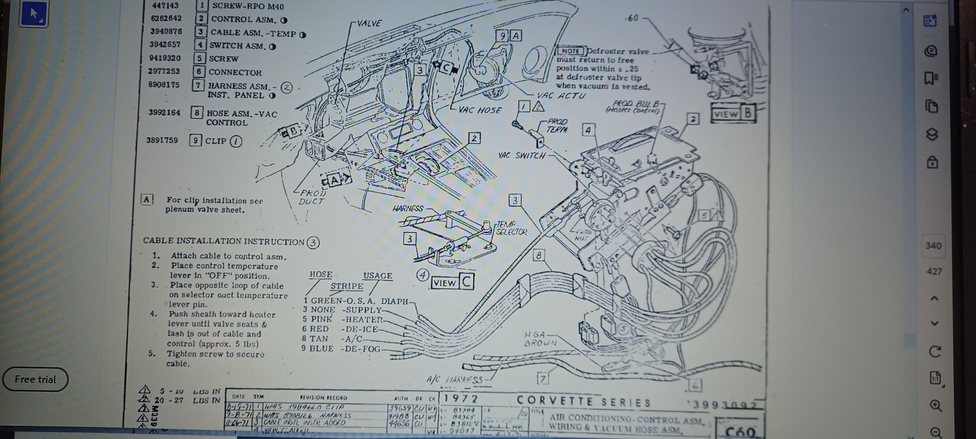

This is from my 72 AIM. I'm sure 73 is the same.
