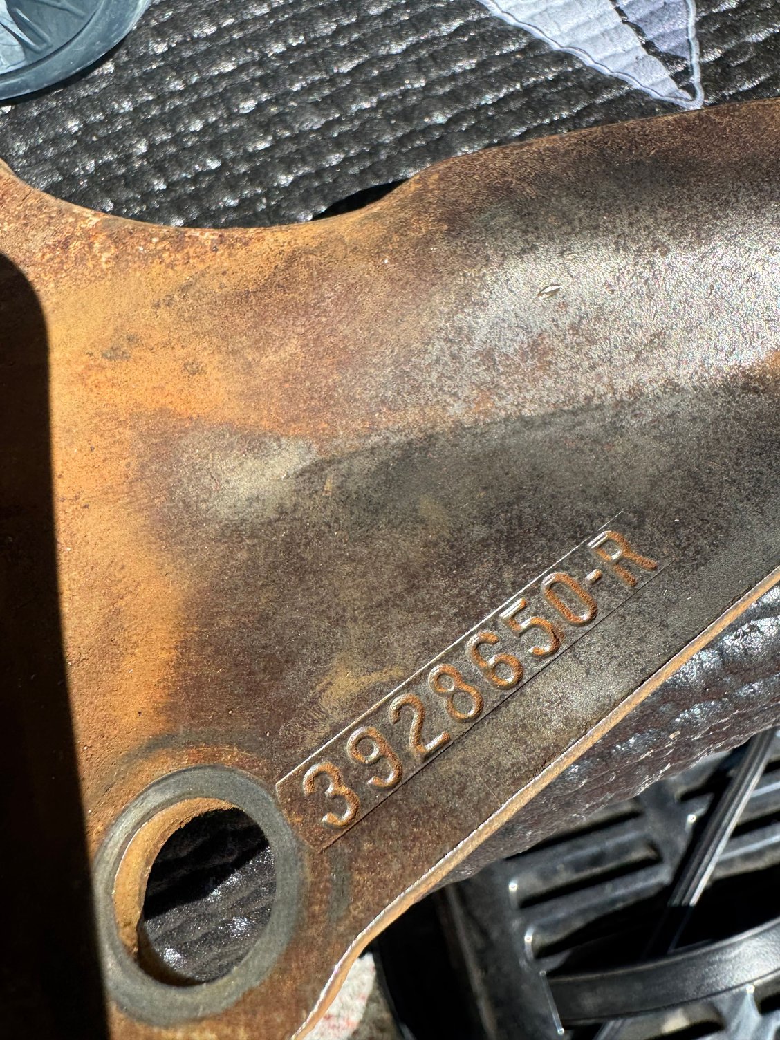

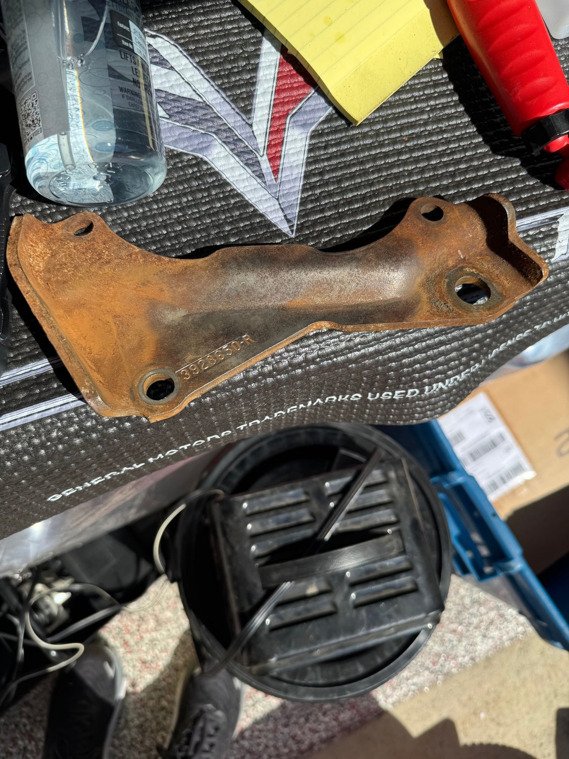

Hello all and thank you in advance for your feedback. Please see the attached photos of a front brake caliper bracket. This is for 1972 Corvette. What was the correct finish for this bracket. Thanks again.

The front support brackets are cadmium dichromate. A gold finish like your carburetor, headlight ,wiper door actuators and brake master cylinder cover but of a lower sheen.

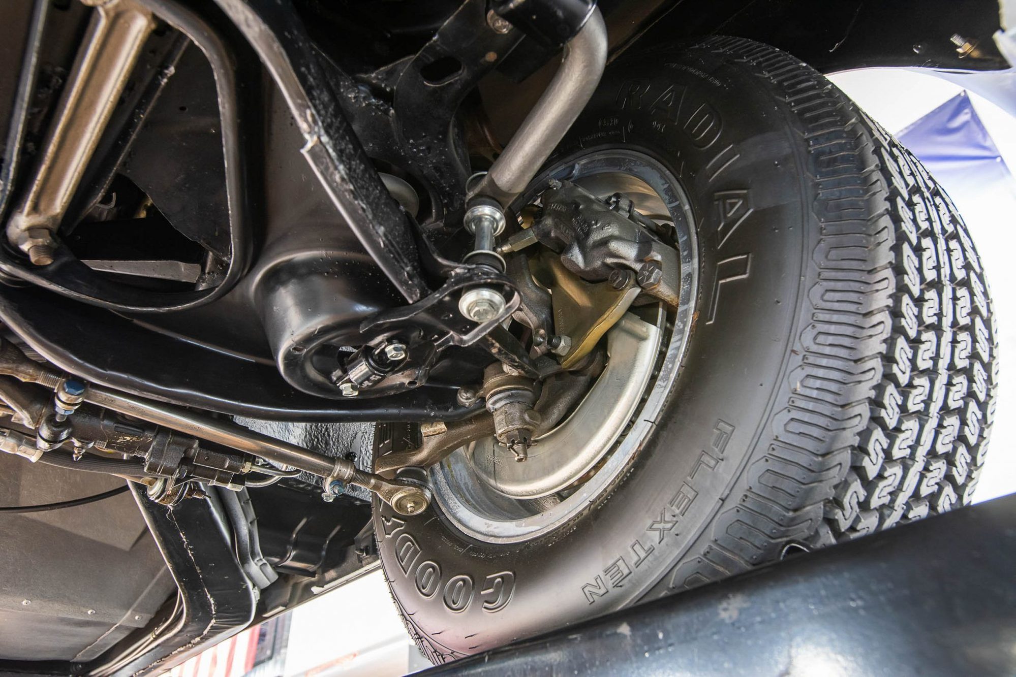

Like this?

Thank you guys for the feedback and the picture. The pictures is a great looking picture and I’m gonna use it as a reference. Thanks again.
