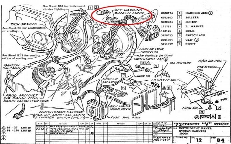

I have a 72 Base Coupe. I have the dash removed, and I noticed a disconnected harness behind the speedo (see pic). I cannot find anything close by that it may have been connected to. Any ideas?

Key buzzer. It was likely removed because of the God awful noise it makes.

Ah - not surprised. The car was my Father-In-Law's for 43 years. It seems like something he would have done.
