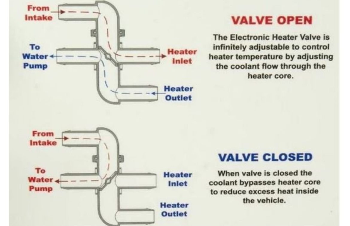

Lots of things that were sufficient when the car was new, turned out to be insufficient when these cars reach 10 times the expected service life.
Whether hot or cold, that coolant is still at 15 psi, and will leak out of a leaky heater coil. Unless you block the heater loop completely, via plugs, or two valves.
Old Mar 2, 2025 | 01:33 PM

If you were replacing the mixing valve in your shower, would you only shut off the hot water?
You need two valves to seal off the heater core, which is exactly what @interpon posted. Even though there isn't "flow", there is still pressure, that will go somewhere. Most likely, through the leaking heater core, and out onto the passenger-side carpet.
A brand-new 04-06 GTO heater valve might actually provide the bypass you expect, but there is zero chance that an OEM heater valve is stopping or bypassing 15 PSI.

GTO heater valve discussion here:
https://www.corvetteforum.com/forums...-get-heat.html
Originally Posted by TorchZ51
Install this valve and it will allow water flow on the backside of the LS thermostat (valve closed position) to allow the thermostat to open properly. The in the valve open position, water is directed water through heater core when needed.
Technically that is one valve, but one that functions as designed (probably).

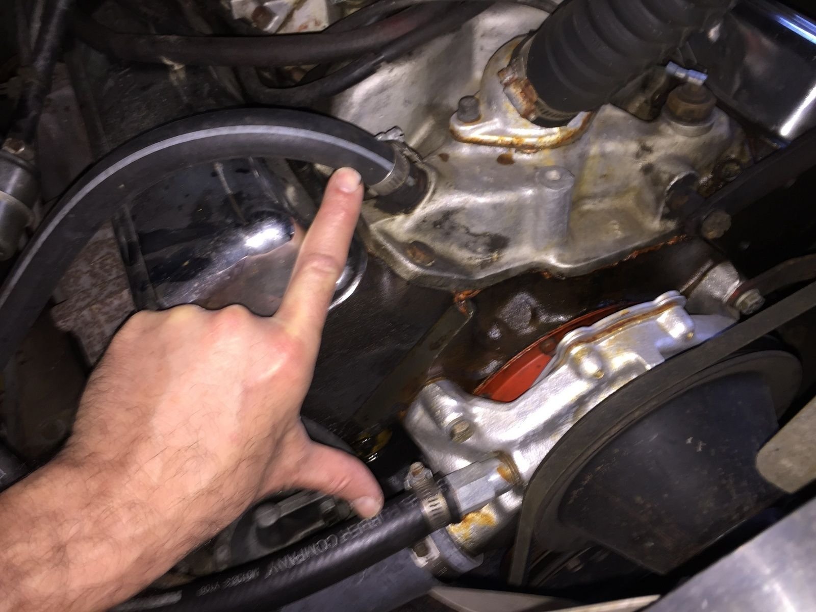

One shut-off will stop unwanted heat in the cabin.
But two valves are needed if an actual leak begins at the core.
Another option for temporary repair is a heater hose splice fitting.
One end of the black plastic adaptor is 5/8" the other end 3/4", less than $10.
Most of us figured out that one valve will do, to replace the crappy original valve and contain summer heat.
Some, insist on an overkill of two valves, just in case. (of a leak)
Some people carry two spare tires, just in case.
