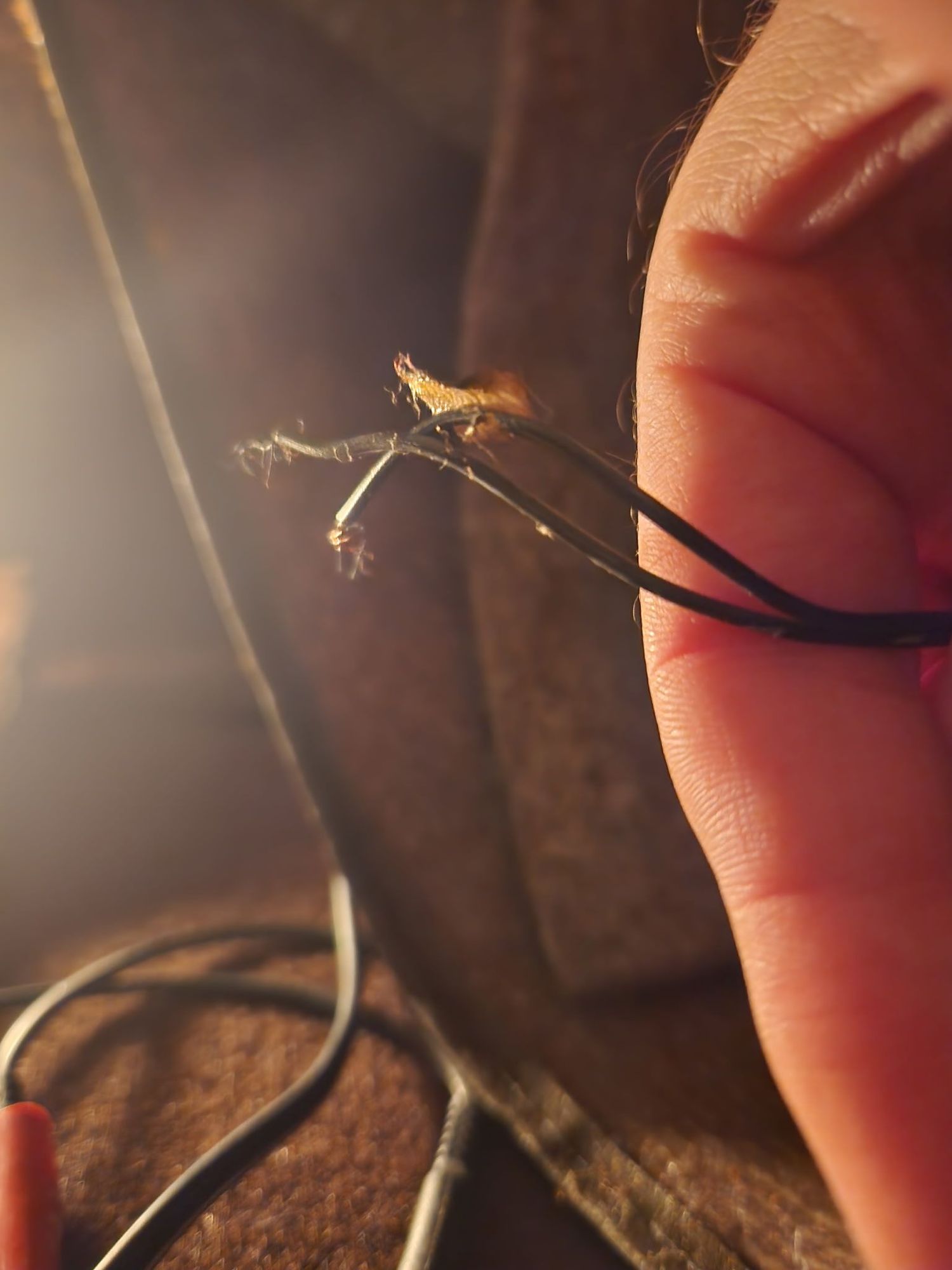

Default Update on wires
So much husband has been digging around in the car and has discovered a couple of disconnected wires under the back window inside the car. Anyone know what they could be for? Thinking it maybe for the alarm system.
Also, he's located the ground bolt and we are going to clean it and replace the nuts.
If you are talking about the ground bolt on the bsckside of the tail light housings, advise him to go cautiosly if they do not spin free easily. Those bolts snap very easily.
