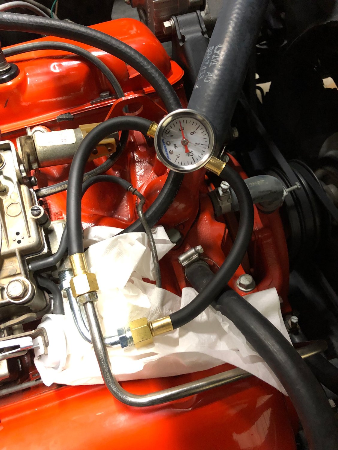

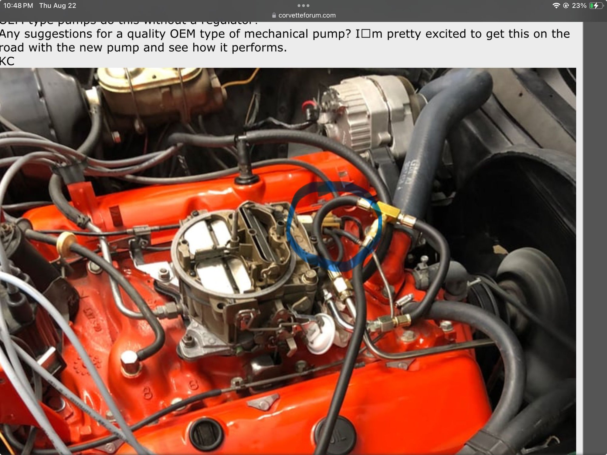

This is the setup I made from parts on Amazon.

Thanks for the suggestions. I was able to cobble together a gauge and an old fuel line and was able to check the pressure. All is good.

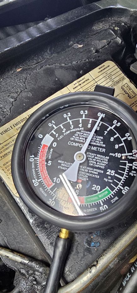

I used a unit from Harbor Freight. It worked well. After many tests I was averaging about 6psi while cranking dead headed.
I also had my carb rebuilt by Phil. (72 LT1) You will be happy!
