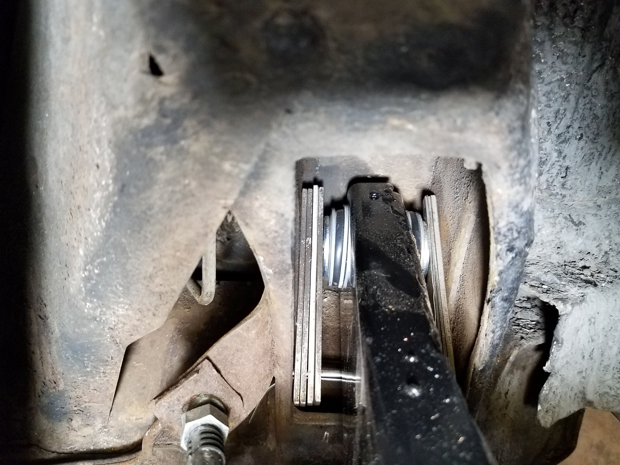

I removed my trailing arms 5 weeks ago because I had noticed, with the rear jacked up, both tires would rock a little when pulling at the 12 and 6 o'clock positions. I was trying to evaluate options for upgrading the outer axles during the rebuilding. Most of that is in the thread linked below.
https://www.corvetteforum.com/forums...rms-today.html
I decided on Bairs, in PA, to do the rebuilding. They offered to disassemble the arms and check the components while I watched if I wanted to deliver them in person. That's what I did and I watched as they checked the axle splines, the axles themselves and the bare trailing arms for straightness. No problems were noted. I decided to reuse my original axles because there is really no direct replacement, 17 spline axle that is clearly superior to my axles which have withstood years of abuse and still appear good.
They shipped the arms back to me in a week. I reinstalled them, using the same stainless steel shims on the front of the arms that were there before. I took the car out for a test drive today and aside from a small brake fluid leak, all is well. After the winter I will get the wheels aligned but it appears to be tracking straight as is.
