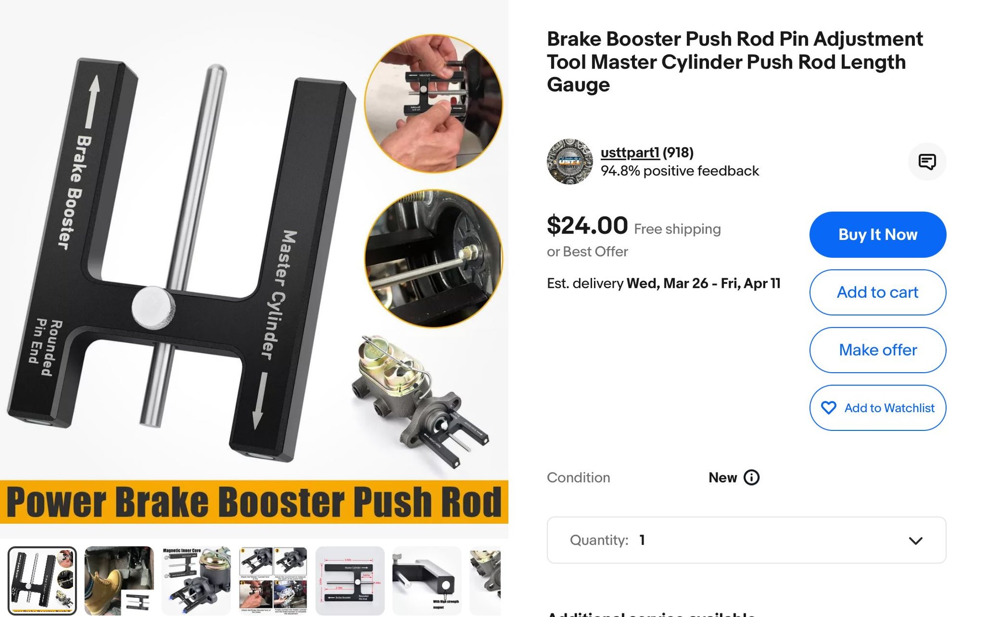

As mentioned in here, and from my preparations (studies and storage of good posts/threads) for when I will be doing this, I might recommend this tool. Various ‘Vette vendors sell them, but they are also available for less elsewhere. As in a previous post, the rod length is crucial to not damage things. This tool helps set the depth.

Yep, used that tool.

.060" is WAY to much gap in the booster pin. You will end up with a dead spot at brake apply, IMO.

I was told to use a sheet of paper as a 'feeler' gauge when setting this gap.
No sure exactly how wide a single sheet of paper is.
