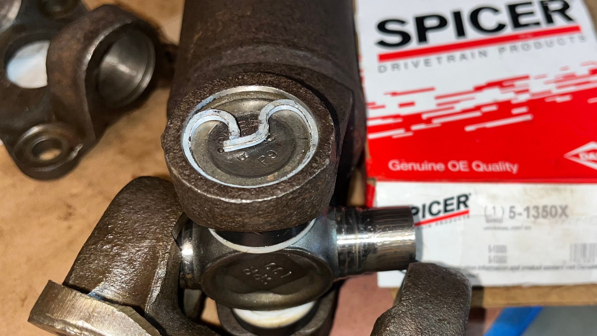

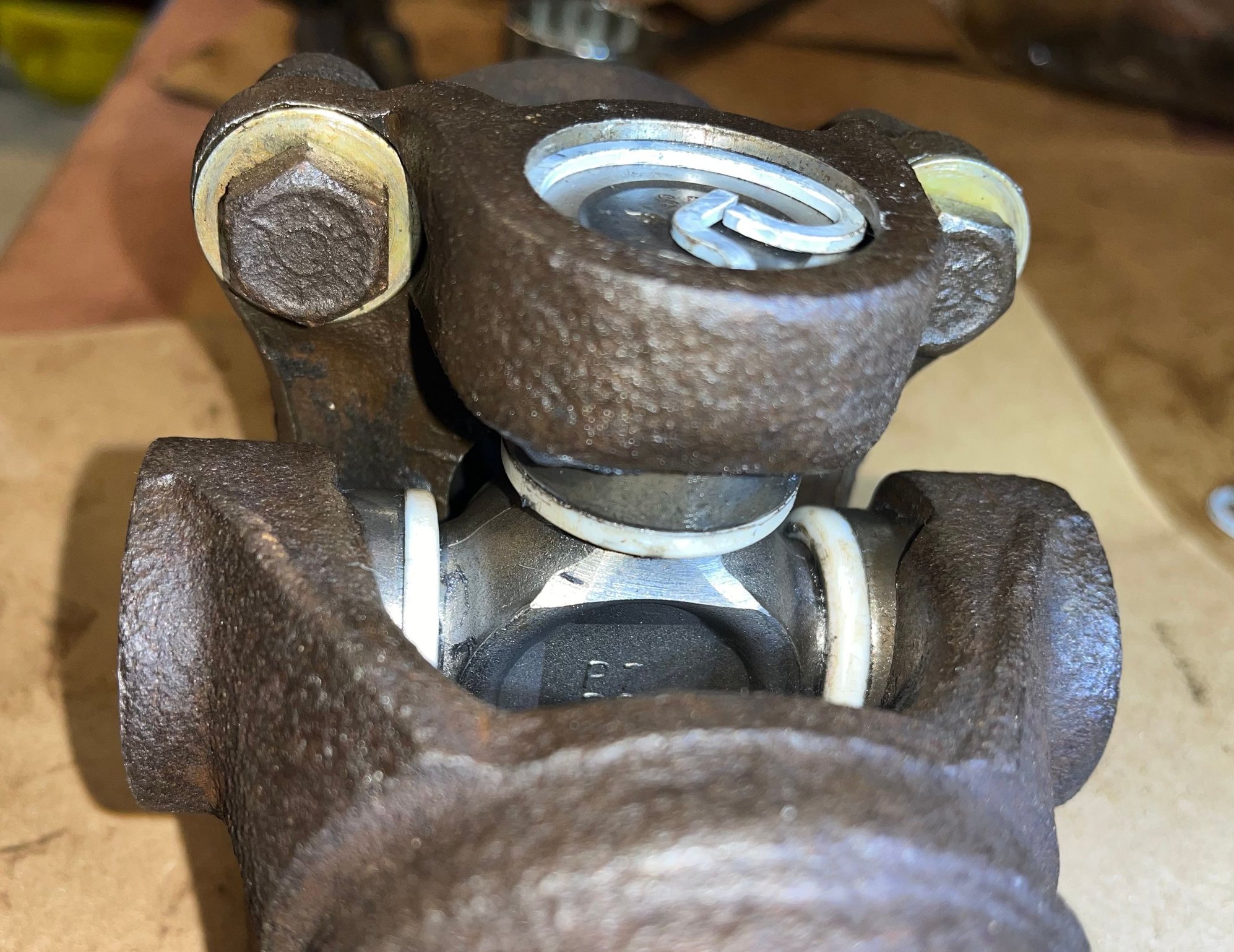

For reference, here’s a comparison of the original versus the new Spicer. And I only had to grind the spider, not the flange thankfully.
