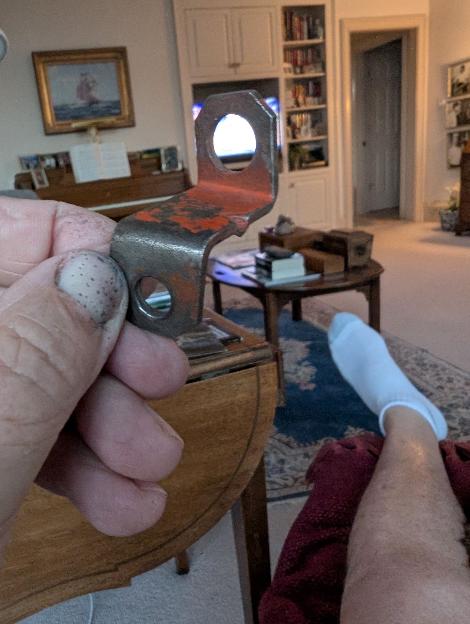

Default Bracket identification
Can someone tell me what this is. I think it was mounted to my original Muncie. Been painting lol.

The clipped corners (and orange paint) make me think engine lift bracket. My engines don't use that style, but maybe small blocks do...
Thats what I thought as well. Has the the small hole for the bolt and larger hole for the hook up. But never seen that style on a Corvette.

Could it be for the sift lock cable . That`s the cable that goes from the rear shift fork , on the trans , up to the steering column at the firewall. You needed to put the trans in reverse to unlock the ignition so you can remove the key .
Steven
Steven you are the winner ! Lol. That is what it is, confirmed by a look in the Zip catalog. I was pretty sure it was on my transmission, but does definitely look exactly like an engine lift bracket too. Thanks again for the help guys!👍😁
