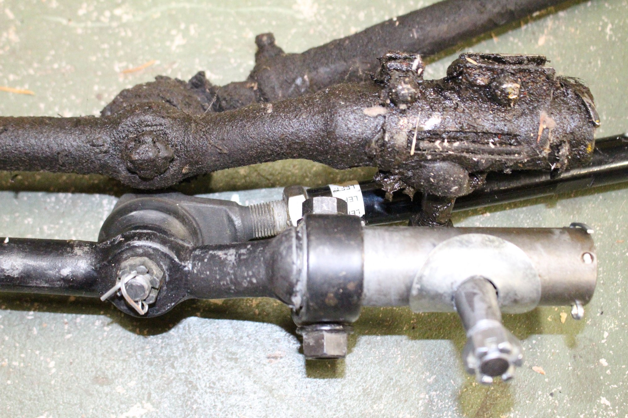

MS centerlink above. PS centerlink below, with Borgeson adapter on it. I swear the pitman arm stud does not look like it lines up with the upper one. A different distance to the the tie rod joint.

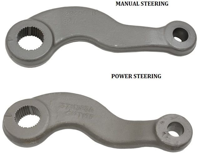

Two different Pitman arms. I need to get two of them side by side to see what the difference is. Is it Clocking? or angle? Probably the PS version needed to move the connection point a little for all the hoses to clear. Look at the missing spline spacer in the gearbox connection. It is at a different clock angle.

Which centerlink and which pitman arm do you have?
There are two of each.
MS & PS.
You may need to try a different combination of parts.

It had pwr str. so the center link and pitman arm are for pwr strng with the kit adapter. The longer manual steering center link makes sense to me when using outer holes in knuckles. The longer pitman arm would make the problem worse.
The brackets welded onto the Borgeson box are not far off. Just enough for a noticeable tilt in the center link and the inner tierod grease fitting hits control arm.
