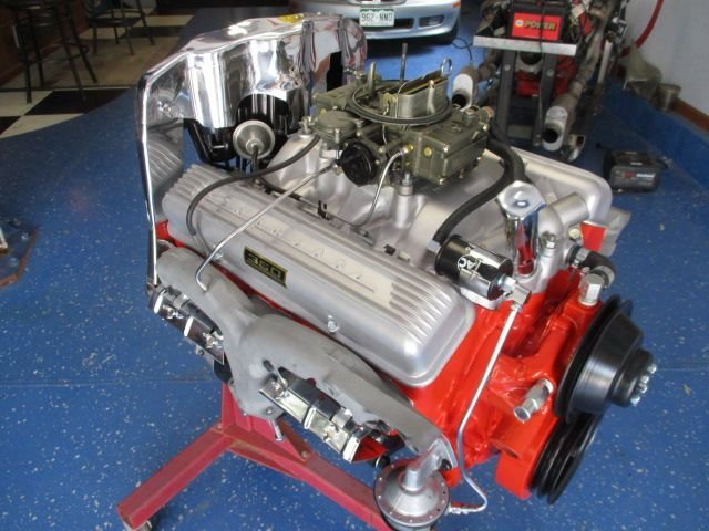

"Vette Facts" is riddled with errors - you have to be very careful when getting "factual info" from that source. As you noted, the 1968 L79 never came with a Holley carb - in 1968, they were all Q-Jets.
1965 L79 with the Holley carb. '65-'67 looked like this. Last year for the Holley on the L79 was 1967. Q-Jet was used in 1968. In 1969, the L79 was no longer available and was replaced with the L46 350.
Lars

QUOTE=lars;1608698038]
Lars[/QUOTE]
Except that 67 had a divorced choke and different fuel plumbing.
bill

Yes, of course. The point was that the early 327 L79s had the Holley carb, and the last year, in 1968, had the Q-Jet. - not a Holley.
