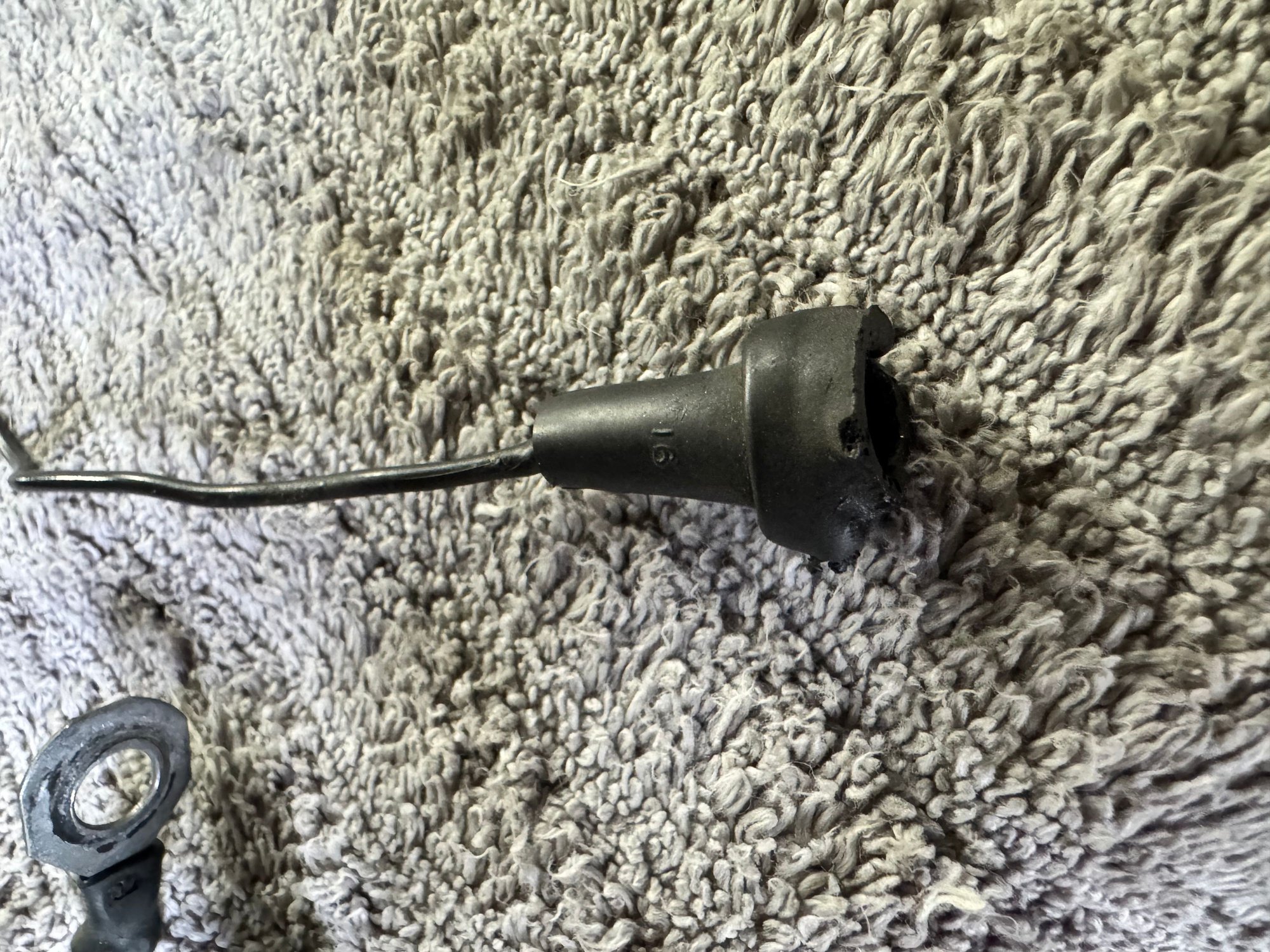

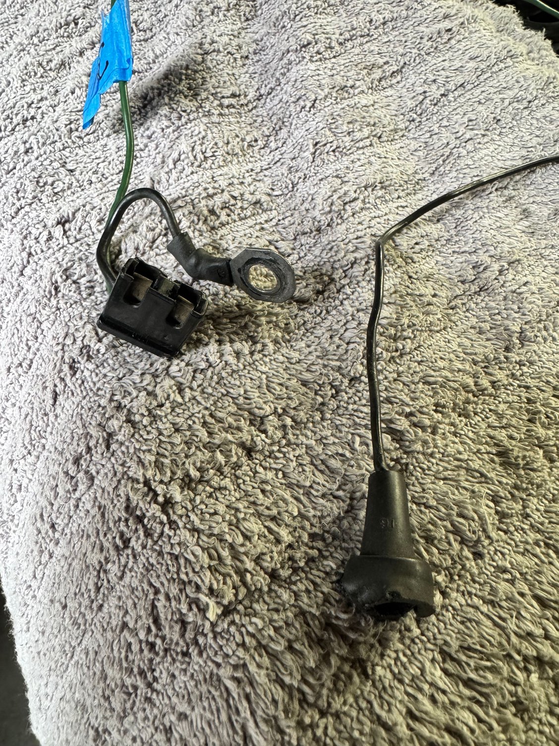

I’m in the middle or reinstalling my AC compressor on my ‘72 and I just found this black wire with a partially melted rubber boot/connector tucked into the passenger side fender. As far as I know, it wasn’t connected when I pulled the engine or it would be labeled. Anyone recognize it. It’s coming from the compressor harness.

Might go to the carb if automatic

Perhaps superheat switch?
That’s my guess based on the shape of the connector and you said it’s coming from the AC harness

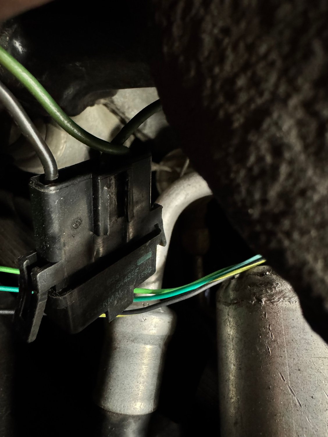

Does the round connector go to your blower motor? And the other one go behind the clutch on the compressor?

The flat connector with the green and black wires goes to the AC compressor clutch. I’m just trying to identify the round black single wire connector in the first picture.

Goes to the super heat switch in back of compressor. My 72 has same connector

Thanks. It wasn’t connected to anything and, from the looks of it, it hasn’t been connected in quite a while. I’ll do some Googling.

When I replaced the compressor during a/c rebuild I left the superheat out so mines not connected either. A/C works fine without it.
