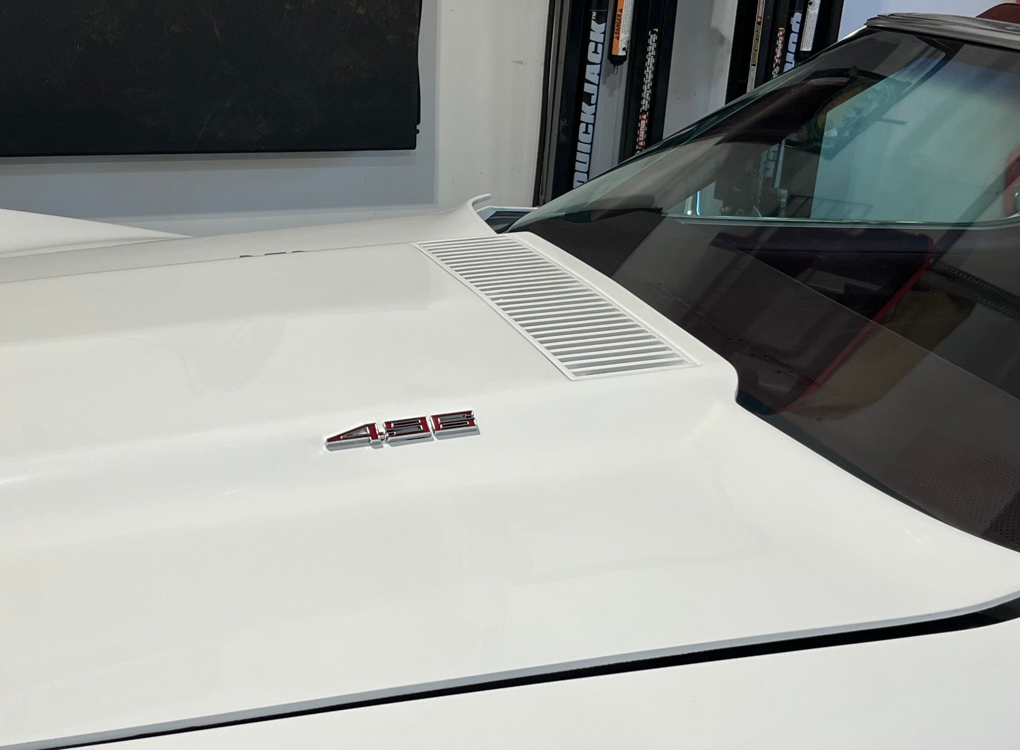

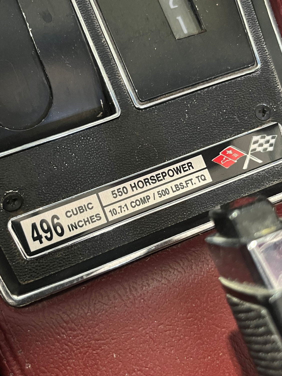

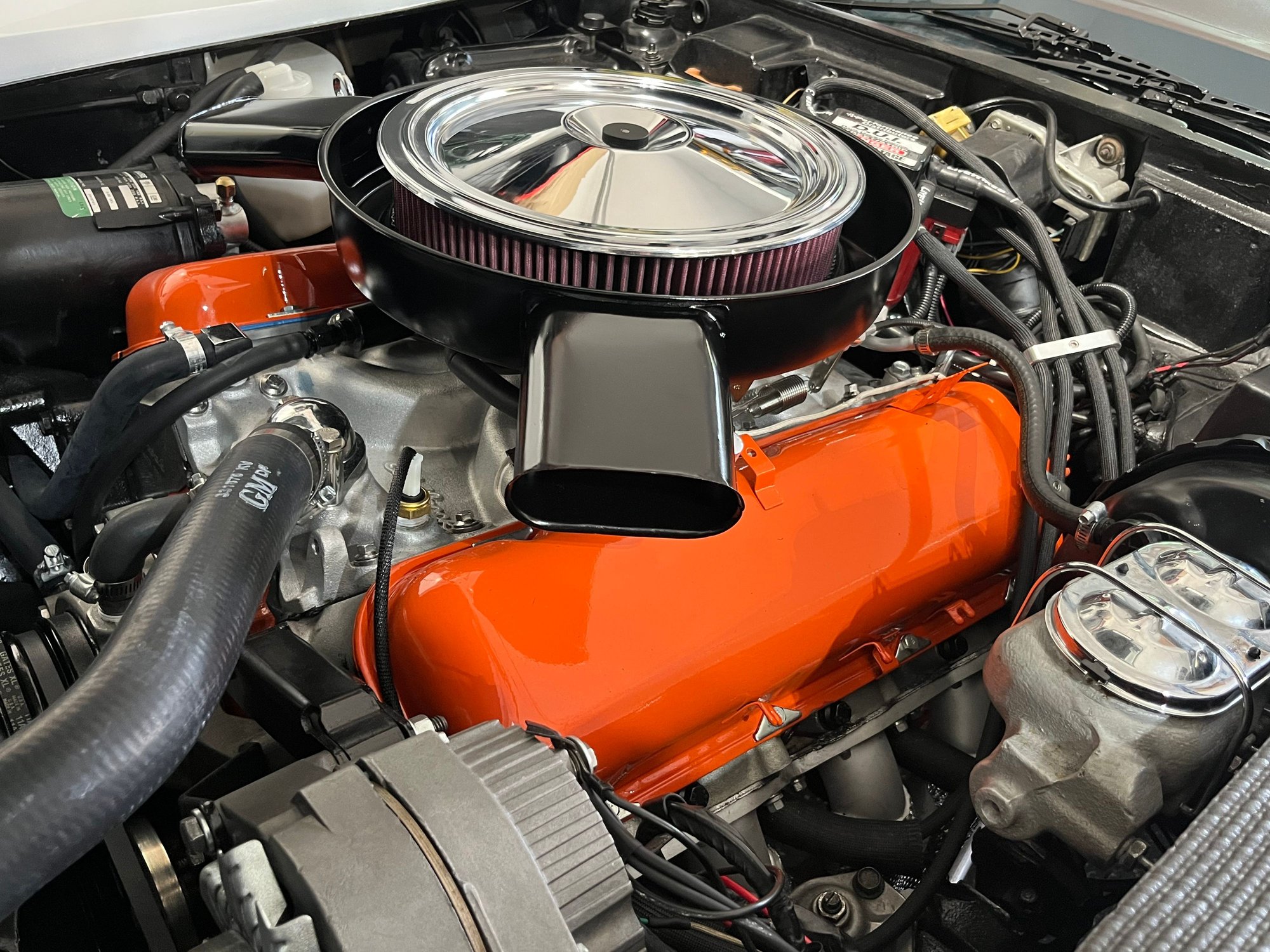

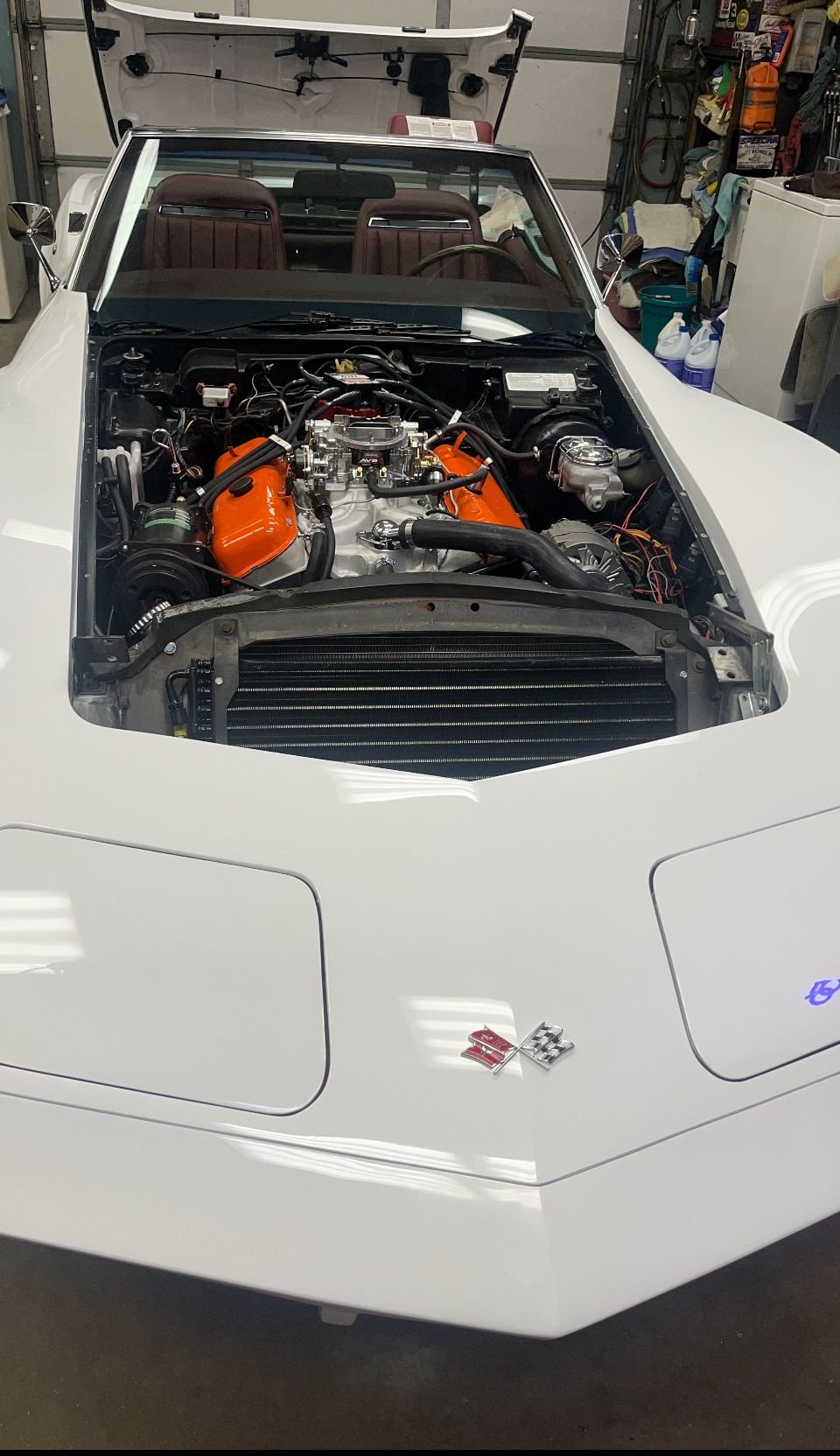

Old Apr 17, 2025 | 03:09 AM
Jetglow's Avatar
Jetglow
Joined: Jul 2010
Posts: 561
Likes: 287
From: Louisville KY
Just finished my 496
