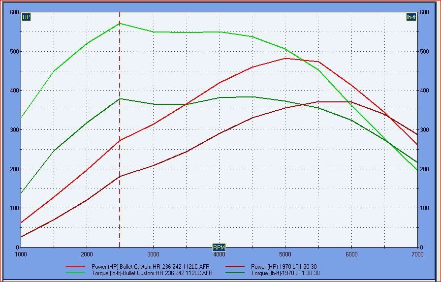

From a 7000rpm LT-1 to a 468 LS6 torque monster.
TQ 400# to 550#
Should be fun!
TQ peak 400# @ 4800 to 550# @ 3500...much earlier and a third stronger
Redline: 6700 rpm vs 6200 rpm - oh well
I autocrossed the LT-1 for decades, and once I got used to the power, and could use all of it, I found myself waiting for 3500+rpm, far too often!
It would hook pretty solid, in 2nd, even at WOT. So I just floored it, and it stuck. (10" Street slicks aka autocross specials - DOT "0".)
Pretty sure the LS6 is going to need at least one more gear to "stick em" And without good tires, that may not even work.
The LT-1 was pretty weak at 3000, so the new one might be twice as strong at that point!
You know what I mean..."roll-on" TQ zone

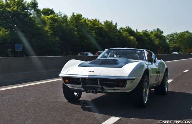

I originally had 285/40/18 Toyo's on the rear when the 489 was installed (and still have) - they were surprisingly good in terms of traction back then (but 'gone-off' in grip terms more recently) - oddly my car had the F41 suspension installed from new - but didn't realise the F41 specific dampers had been replaced with cheapo softly valved Gabriels (or similar) front and rear.
Off the line the front-end would rise-up high - rear end would 'sit-down'. Never had traction issues through 1st, 2nd and intially 3rd with the M21/3.08 rear gearing - it was only up around 80 or so that things could go 'squirrely'. Once some firmer gas shocks were swapped-in the front-end would stay-down and off-the-line traction decreased - but perhaps age-hardened rubber is a contributing factor. I'd like to know how good a pair of MT ET Street's are compared with the best radials like Nitto or Michelin. They are very expensive here in UK (and probably set to get more so in future!
This photo was a few years ago not too long after engine install. Trailing the camera car at 20 or so mph and hitting hard in 1st.

Rosco:
That is one impressive pic!
You are convincing me I need double adjustable shocks now.
So I can switch back n forth.
Hey!
Aren't you on the wrong side of the road? LOL

Rosco you got me thinking about the softer traction oriented suspension:
My LT-1 (top) and your BB (2nd) actually had similar total TQ in 1st & 2nd due to gearing differences, but mine did not stick in first cause it was autocross stiff, where yours did stick cause when it had lift, and spun when stiffer.
But with the deep 1st gear of my TKX, I think it's hopeless in first gear W.O.T. no matter what!
Even 2nd gear til 75mph will be bad if I keep it stiff.
Just like Dawsons.
Oh well.
Maybe I can tune the shocks to get it to stick in 2nd, past 50mph!!
DDawson has even more TQ in 2nd (~3900), with his gearing, and his comment was it "struggles" in 2nd on good street tires.
I guess that is where I'll be.
Our deeper 1st gears, and rear gears, than Rosco, put 1st gear well past the will hook up stage, in first gear, at WOT.
But they do make it more lively at half throttle.
I have a buddy George with 411s, a TKX, and a 427, so an awful lot of first gear, and it drives great at half throttle. Never saw it a WOT.
Thank you for the driving feedback guys!
I doubt I will ever have to wait for 35+mph for the power to "show-up" any more!
